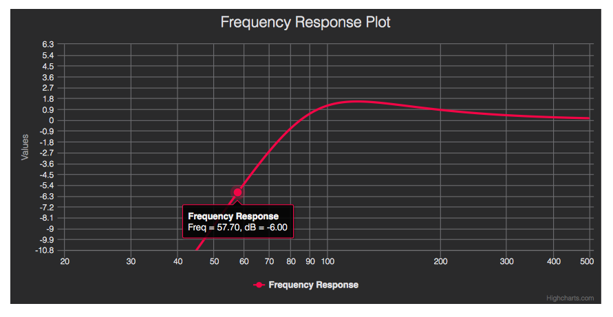

I'm wondering how big a 27 litre box would be... -3db at 66hz would be quite acceptable considering what I'm working with. I've been playing about on speakerboxlite.com as they have the non-coaxial version of the woofer already in there as a preset. Haven't got anything quite that low, but not far off. And of course playing about with cheap 10-12" subwoofer boxes to see where they could potentially meet up... A bit of a waste of time but I'm sure I can get a relatively compact sub to meet with these.
I'll have a play on the Speaker Box Enclosure Designer / Calculator now I know what's what.

Anyways.. It seems that anything about 16-17 litres or above breaks into the -3db 60's.
15.38 litres gets 69.04hz -3db, so they don't have to be huge to meet up with a sub of some sort. I'll likely go a bit bigger and lower into the 60's but it's good to know it'll be a simple job and I can whack it together fairly straightforward without obsessing over wether it's 22.5 litres or 22.6 litres. It's all good enough.
I had I can live with that for an almost zero cost weekend project. If it works out, mid 60's ain't a bad spot to meet up with a sub.

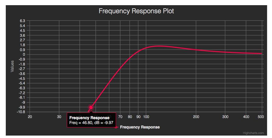

I'd also been playing with another, results below in the pics.
