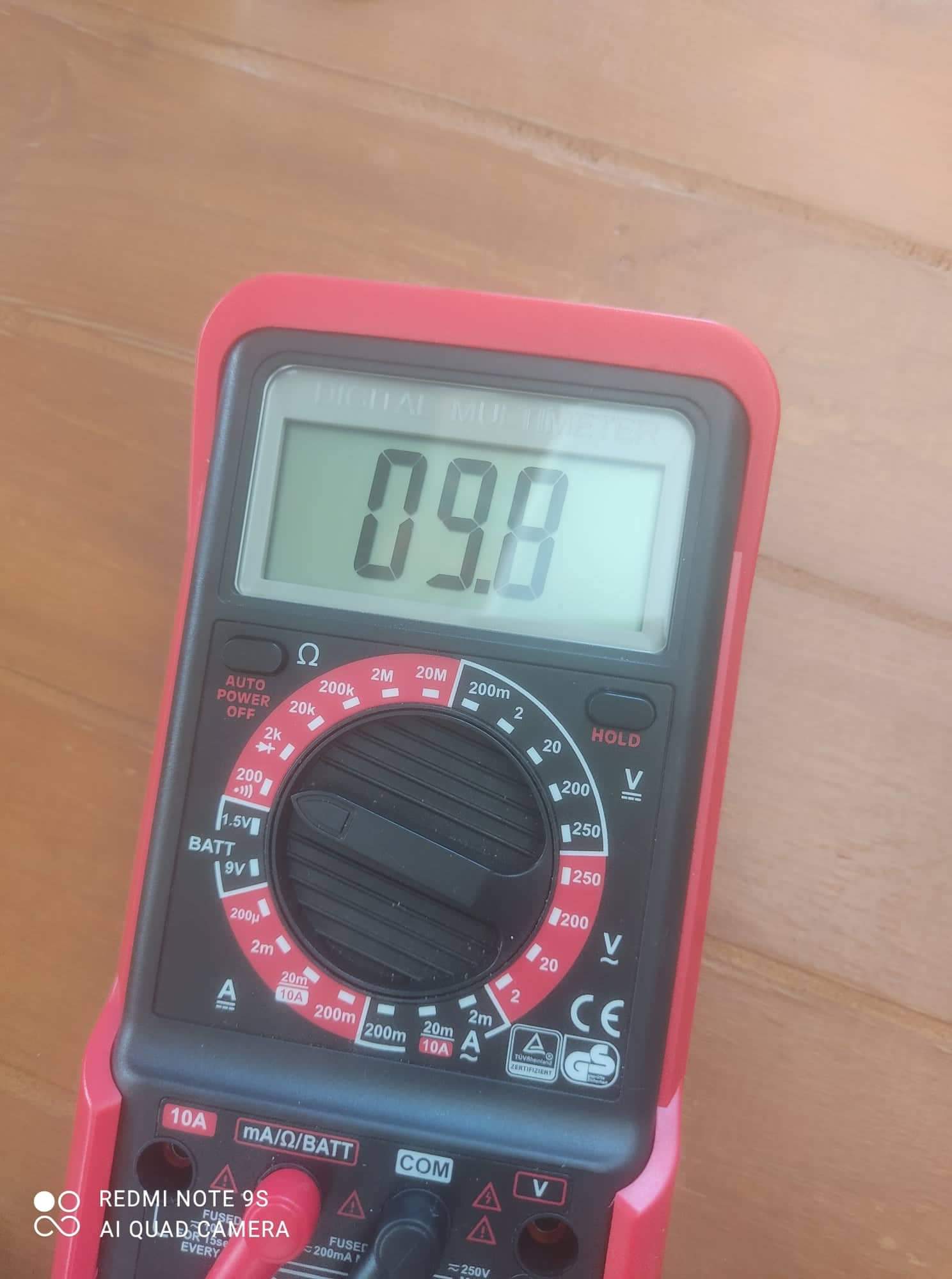

The bottom pair doest show something on multimeter. The top shows 40-50ohm (?) Around 45-47. Without the links
I don't think we can deduce much from those multimeter readings.
To ensure compatibility with the crossover you should consider buying the 6 ohm Heco HG 20 GE tweeters to which I linked.

This measure doesn't make much sense. You have either a tweeter way off, or a multimeter way off.This picture is when i measured the one tweeter that works.
A 8 Ohm nominal tweeter has a voice coil resistance (Re) of about 6 Ohm, while a 4 Ohm nominal one has a Re of about 3 Ohm.
The correct procedure for measuring small resistances, is to first measure the resistance of the tips, and then subtract this value for any subsequent measure. To measure the resistance of the tips simply connect the two tips together. On my multimeter this value is 0.6 Ohm.

As I hinted at earlier, Ralf, a fraction of an ohm resistance in the test leads is not going to explain the unusually high tweeter resistance reading.

Good call, puppet, we can't actually see what the meter is connected to.
Metrios, make sure the tweeter is disconnected from the crossover when you measure it.
Whatever, the replacement Heco tweeters to which are linked are rated at 6 ohm nominal.
