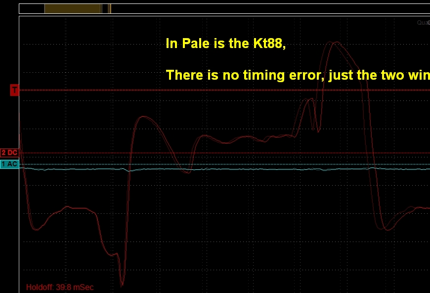

I confirm that kt88 are better in the same kt88 amplifier,
A beefier PS can take kt120 and make it better than kt88, but otherwise no.
The only 'sound' kt120 will be better at is in the deep bass (under 60hz) it will have a cleaner less distortion background, it will sound less tubby.
for the same kt88 HT, don't use a kt120.

I just test it I said the voltages, the noise thd for bass is 20 dbv under for kt120, then it raise to more than 5db thd and a lot more noise
Imd is also 2-3 db higher and raise as the power goes up
I tested for myself in the hope it would work, the xpr002 of edcor is at the bare minimum for heaters requirements,

The voltages B+= 450, current 55ma, Pentode with CF 16 ohm windings, GNF=7db, CF=around 2db feedback.
input 6sl7 cathodyne with raised and isolated grid bias directly coupled to 6sn7 cathode followers.
The driver stage is good up to 200 Watts.
Screen bias around 400V, I used the same parameters for kt120 and kt88, the power transformer was on the max of heater voltage for elements, I think kt120 would have a lot less THD with higher filament heater voltages, it has a huge impact, better higher than lower, it is very bad on the THD graphs vs the KT88.
However the bass has low noise and the KT120 has more raveling possibility, it can play delicate nuances better at low power than kt88 and sounds cleaner in bass. So it is a way better tube, just completely missed used under 500V with bias under 60mA, it sings under 50 Watts in mono blocks at 600V, 75mA and plenty of heater juice.
To give you an idea.
Exact same power supply and circuit and output transformer, checked no ringing, 100% stable (all this), with EL34 I had around 0.2% Thd in general at 8 watts.
With kt88 in UL around 0.12%
With kt88 in Pentode CF, 0.09%
With kt120 0.11%
The Pentode would be able to perform way better with a regulated screen supply, which crumbles at higher power over 20 watts.
With the Pentode CF it has a way better THD pattern, especially in high frequency and bass and IMD.
The kt120 THD is not good, and Kt77 horrible, EL34 is a way better tube.
All this I could easily hear, and especially Ultralinear cannot compete with Pentode.
The CF had some problems but it gives you a lower output impedance.
