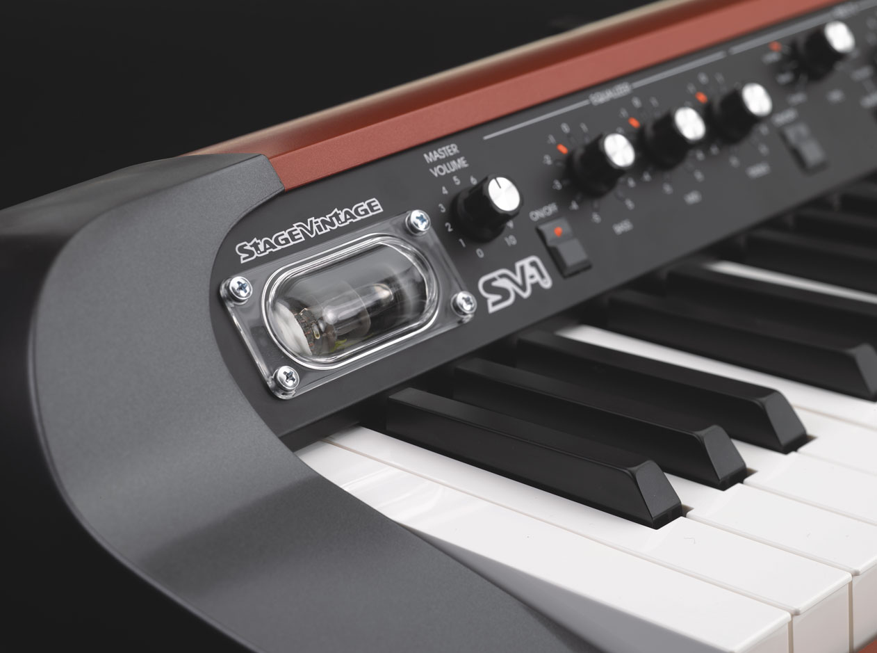

Korg already has products including tubes in the audio stage for that "analog warmth" but if it doesn't look (and glow) like real tubes and can't be put behind a small window to attract/impress customers the commercial appeal will be small, not a good marketing idea IMO. (look at Korg's SV-1 below for a good exemple). Maybe the small size, low consumption and low voltages required for the VFD tubes are advantageous for small battery-powered FX-pedals including tubes. It's very unlikely these VFD tubes will be ever offered to the open market/hobbyist community by Korg, or maybe in very limited quantities as spare parts for their products.
