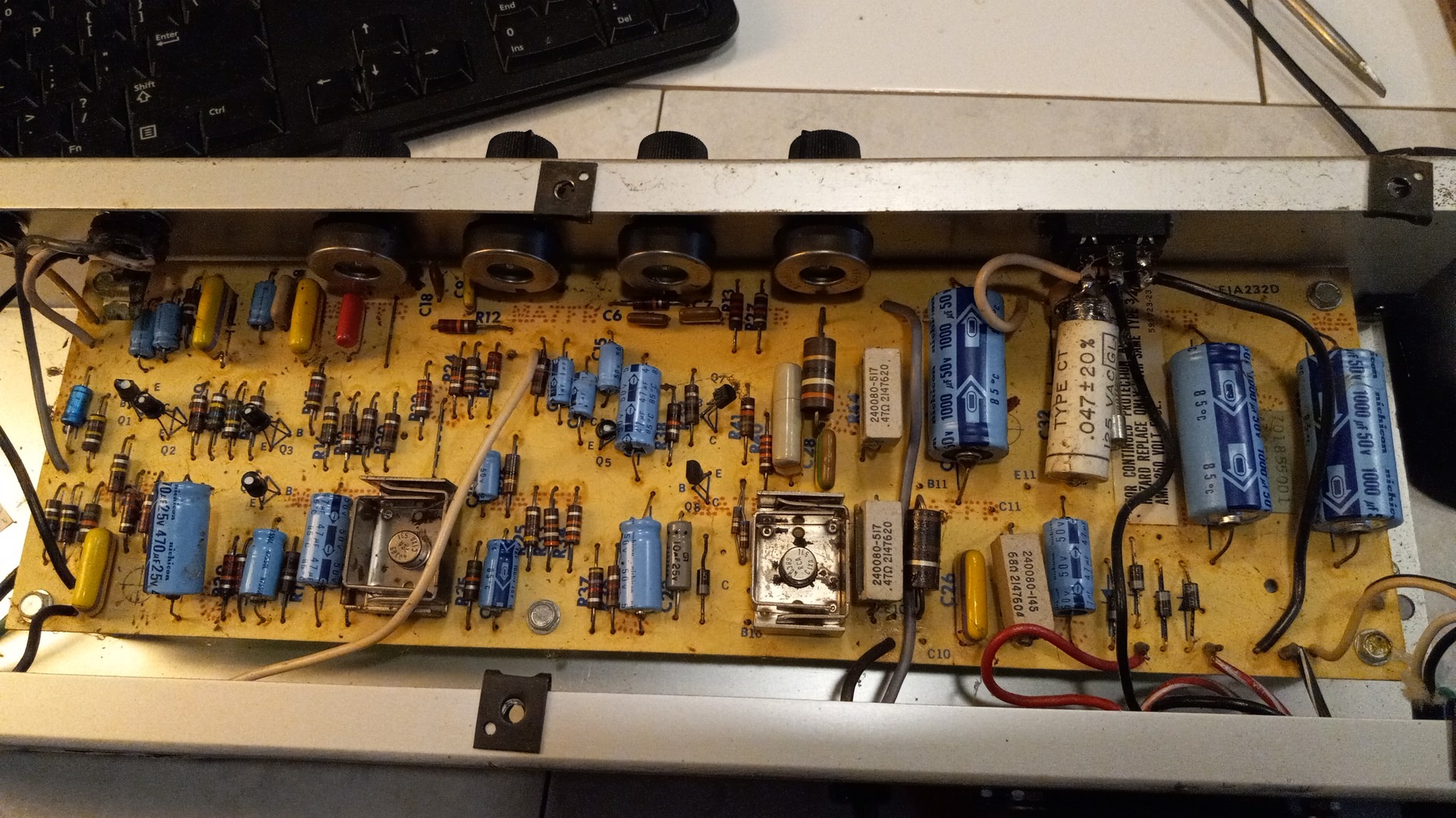

That capacitor you showed in post #1 probably expired because of a dielectric failure due to age. Replacements should be X2 or Y2 which are rated for safety.
X2 capacitors are intended to be wired across the mains inputs (live-neutral) and Y2 from either to ground. Although the circuit shows the capacitor connecting to the amplifier ground for safety this should be wired to the common earth point rather than any actual connection in the audio stages. (Y2 type, but I suspect an X2 across the mains input would be better).
You may have a hard time replacing the transistors. I recall that RCA published this sort of circuit with a germanium PNP in TO-3 and a silicon NPN in either TO-66 or TO-220 which can be persuaded to fit in TO-66 footprints. If you did get to change the transistors you could try an MJE3055T for the NPN and an MJ2955 for the PNP, not an ideal match but would fit the locations (if that is indeed what you have). Being silicon, the bias arrangement would have to change to allow for the higher Vbe and two silicon diodes (such as 1N4002) might work although the driver current at 100mA or thereabouts may require higher current diodes for lower forward voltage (1N5402 perhaps) or a shunt resistor across one of the 1N4002's of around 100 ohms, but it would need to be able to handle 100mA and that would mean a relatively high power (at least 1W). Alternatively, a conventional Vbe multiplier transistor.
The driver transistors in TO-5 with their welded heatsinks are obsolete too, so you would need to use perhaps a 2N3019 (still available from Farnell last time I looked) with a heat clip (not a small one either, the dissipation is about 2.5W, and most of the traditional TO-5 heat clips are obsolete: some you might find are probably not low enough thermal resistance to be of use) or you might be able to use a BD139 with a good heatsink (20C/W or less). The input transistors could be BC557's.

A number of items to explore:
Re reverb hum, if I understand correctly, with reverb control at 0, the hum is acceptable? And I assume the reverb function still performs correctly? That is, the added TIP31 must be powering the reverb tank properly? The tank's revised B+ is roughly +38V?
Is the hum due to inadequate filtering of tank B+ or does it originate from the pickup path? The VR1 volume pot may establish if the hum source comes from the input. If the hum remains internal, a definitive experiment would ground C10 instead connection to VR3 wiper. If hum's still present, tank B+ remains under suspicion. In this event, I suggest lifting negative end of C13 and adding 10uF/50V cap with in series with C13 negative to negative 10uF. The positive end of the added 10uF cap can be used as a probe to search for source of the hum; interesting inspection points would include circuit common, C12+, tank B+, Q4 collector, Q4 emitter.
Another issue is the safety ground. My thinking is that C32 should be deleted and safety ground should be tied to analog common.

Okay, I tried the 'definitive' test lifting c10 and grounding instead of lead to VR3. The hum is still present and varies with the VR4 Reverb pot. What does this tell us? Does that rule out the signal chain before the reverb circuit?Re reverb hum, if I understand correctly, with reverb control at 0, the hum is acceptable? And I assume the reverb function still performs correctly? That is, the added TIP31 must be powering the reverb tank properly? The tank's revised B+ is roughly +38V?

I haven't dealt with c32 yet. When I got it, it hummed loudly with the blown capacitor in there, but maybe because it was blown but still attached. Could you clarify what should go to ground there? You mean the ground off the three prong plug which grounds to chassis, to the ground on the circuit?
Your C10 experiment shows hum originates in reverb section. My chief suspect is failed C11, assuming that the added buffer is performing as intended. DC bias checks should add confidence re buffer. If new C11 doesn't yield improvement, the added cap experiment I described in post 29 will allow you to probe around for the source of the hum.Okay, I tried the 'definitive' test lifting c10 and grounding instead of lead to VR3. The hum is still present and varies with the VR4 Reverb pot. What does this tell us? Does that rule out the signal chain before the reverb circuit? Yes!

I continue to be baffled by the original explosion of C32. I believe at one time, there must have been a direct connection of C32 across the power line since a 0.047uF cap could not have enough stored energy to self-explode.
Convention normally places the power switch and fuse on the hot side of the of the power line; assuming this convention was followed at design time, the schematic shows C32 tied to the power line, probably to the hot side! I speculate the former owner experienced loud hum with his original 2-wire power cord and contrived an external ground to his guitar as a hum reduction bandaid--- and hence connection of C32 hot-side-power to ground. This probably worked for for him until C32 exploded and/or he got shocked one time too many. Then the 2-wire cord got replaced with a 3-wire with ground.
Since you report that C32 has to be present to avoid loud hum, I'd wager that inspection will show that C32 is now tied to power Neutral (white wire if the power cord has color coding) since if it were tied to hot side, hum would be extreme.
If my conjecture is correct, everything points to probable transformer leakage. An interesting experiment would connect C32 to safety ground. Hum might improve slightly. Connecting circuit common to safety ground might cure hum, but maybe not if leakage current is too large.

Hmm, okay let's see if we can sort out C32. I don't know what happened before I bought the amp a couple weeks ago, but the previous owner seemed none too sorry to be rid of it. I don't think he ever opened the chassis.
It looks like C32 (the one that was in there blown, and now the one I installed) is in the original position labeled on the circuit board itself and is not a modification. The leads from the power cord to the circuit board suggest that the 3-prong is not original.
C32 is wired as in the schematic to the lead from the on/off switch and the fuse on one side, and leading to the rectifier diodes and so on to the filter caps on the other end. So yes, neutral is as it should be, right? That white lead on the switch is from power cord neutral to C32. So I can't just delete it can I? It's not unsafe in this condition, right?
On the reverb, I tried to replace C11 with a 100uf 100v cap (says 64uf on schemo, 47uf in the amp) but then reverb didn't work at all. Maybe bad cap. Jumpering a cap in parallel has no effect. I have limited close spares to work with.
Using the DIY signal tracer probe, I did find the hum at C11 at the 'earliest' in the circuit, if I'm not mistaken, as you suggest. But then much louder on on R19, R20... Am I just hearing the unfiltered 43v AC there? I didn't keep the buffer TIP31 in there, just alligator clipped it in for the experiment but it didn't have an effect. It might be easier if I just post of video of using the signal tracer, to show where the hum 'begins.'
