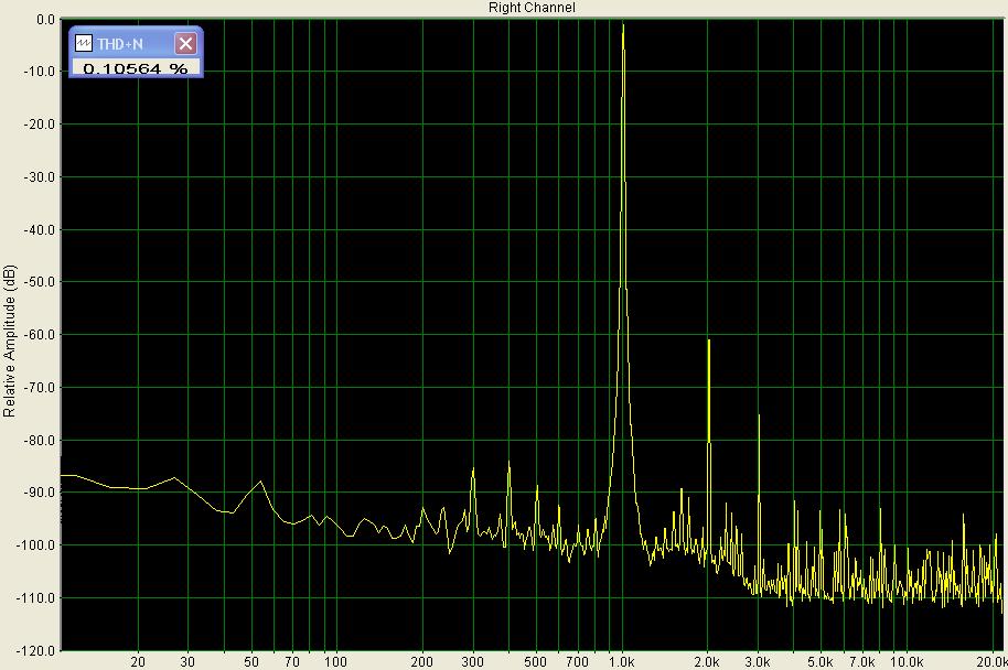

I have measured THD+N of a mains toroid trannie(250W,220/12v).
Don't know if the results are accurate, i used integrated sound card.
If they are , i think it is very good for a mains transformer.
It shows 0.1 % THD at 1 khz and 0.06 % at 5 khz .
Lowest useable frequency seems to be 100 hz.
I used ~20 V input voltage.
Lukas
