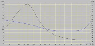

I measured the Avel Lindberg 50VA 115x2 : 6x2 transformer this morning (part number Y236200, two wired as above).
Effective turns ratio measures and calculates to about 68:1
The leakage inductance looks good, the effective secondary inductance looks not so good.
For leakage inductance (secondary, high impedance side) I get about 28 mH, which is good.
For effective secondary inductance, I get about 5.3 Henries. This is not so good, making to difficult to design a passive crossover, and being problematic for direct coupling to an amplifier due to low impedance at low frequencies.
Effective secondary capacitance is about 1200 pF.
The impedance curve shows a peak impedance at about 1400 Hz when loaded with 1000 pF. This is quite a bit higher (in frequency) than shown in the impedance curve above.
Apparently not all cheap toroids are built the same.

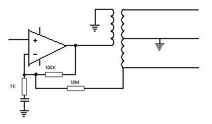

Also , what do you think about taking one of secondary windings and making additional feedback to amp ? Wouldn't it decrease distorition caused by the transformer ?
I doubt the core of cheap toroids is made of wrong steel and plates are badly isolated between each other.

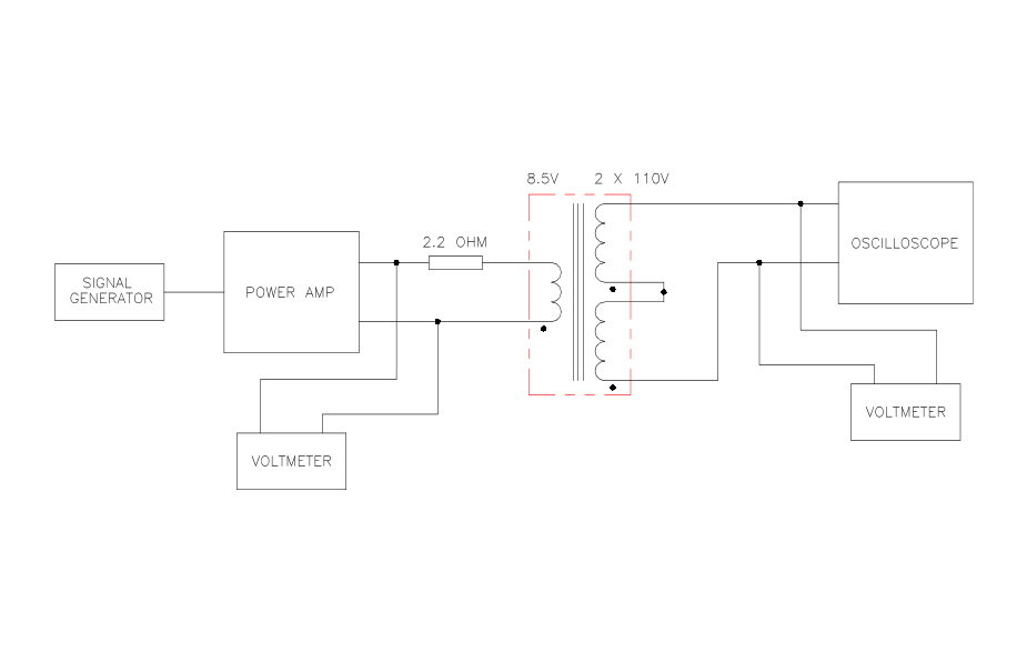

Capaciti writes:This transformer is small in size and has a limited core area. My guess is, that this transformer will show saturation if you go lower than 200-400 Hz (depending of input level).
I'd like to try testing one of the transformers using the circuit below. This should let me plot frequency response of the transformer at different voltage levels and get a look at what point saturation sets in.
Edit: I should add a capacitor across the output of the transformer to simulate the ESL panel.
Hi Folks,
i like to show you the measurement of an toroid designed for ESL.
The step up was connected to 1,2nF. As you can see the impedance graph looks nearby identical to the graph of calvin's step up. Phase shift is at 20° @ 20khz as well, indicating that stray resonance is above 20 Khz. The parallel resonance is lower than 400 Hz due to larger primary inductance. As a result this step up transforms even lower frequencies.
But what is most interesting is the fact that this step up has a turn ratio of 1:100, which means about 3 dB more efficiency of the ESL compared to a 1:70 ratio.
The secondary windings of this stepup are optimized regarding lowest capacity of the winding, enabling higher turn ratio.
In summary standard toroids work, but are easily outperfromed by dedicated ESL-toroids.

Hello,
I have one idea floating in my head - what about making additional feedback to amp from transformer's secondaries ?
Is it possible , and , if yes, has anybody tried that ?
I think LM3886 chip amp would be perfect for experimenting.
Adding a schematic as i imagine it ...
Lukas
Lukas
