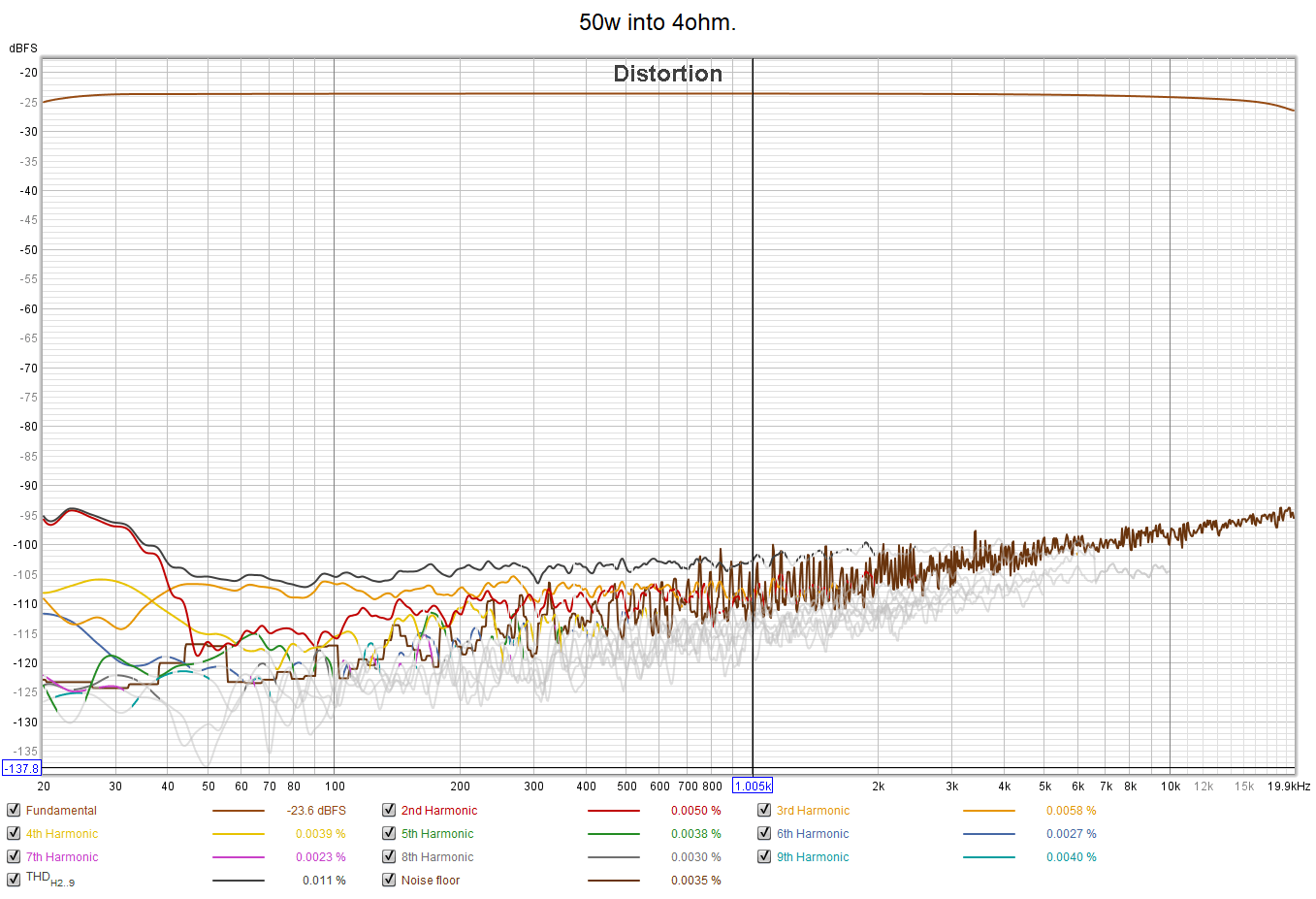

Uncalibrated, spdif into DAC then Scarlet 2i2. So cumulative THD for the full sound chain.

I have a small concern with this dual-mono approach: THD signatures for two channels are not identical. I'm not sure why this is; it might be just a manufacturing deviation between IC batches, or I messed up something during assembly process. The PCB is routed manually with as much symmetry as possible between two channels.
I'm afraid that this might lead to less than ideal imaging. I haven't listened to the amp yet, but having both channels on the same IC might have it's own advantages after all...

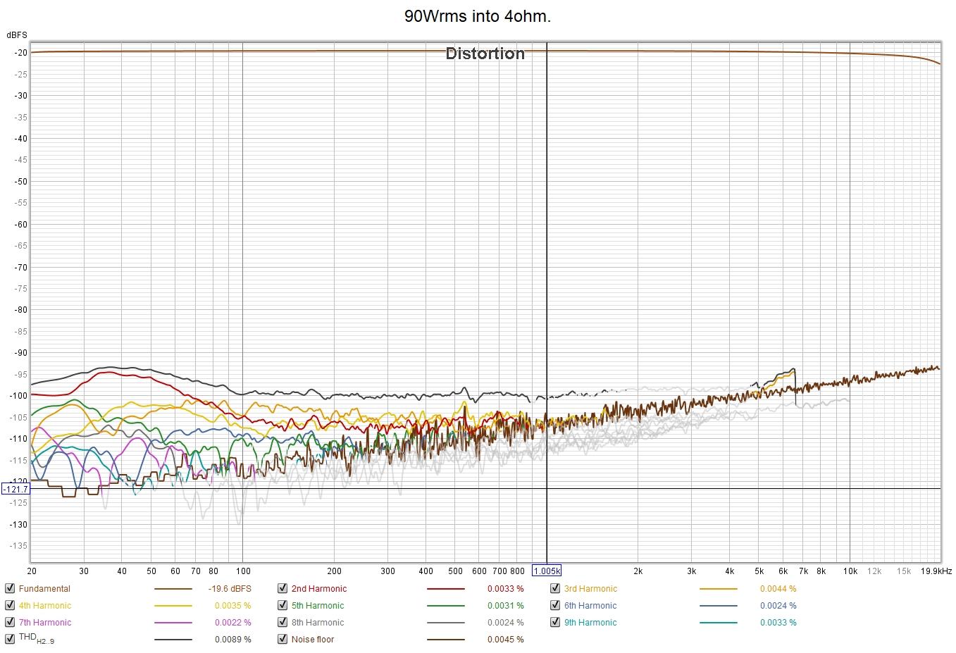

Considering your measurements I see a slight decrease at 20khz.90Wrms into 4ohm, 48V PVDD.View attachment 1306562
looks like a non calibrated setup.
And THD figures are worse than TI specs without PFFB.
For better results I recommend the REW self-calibration procedure in a loopback configuration.
A sample frequency of 192kHz and an extended measuring bandwidth of 90khz.
And please show the result of loopback calibration.
Next step measure frequency response with and without load in the critical range of output filter resonant frequency.
Btw your PFFB does not make sense to me.
Could you elaborate on this?
THD-figures are dominated by the output inductors, rising with output current, i.e. lower load impedance.

PFFB is just copied from TI's app note. Which problem do you see with it?Considering your measurements I see a slight decrease at 20khz.
