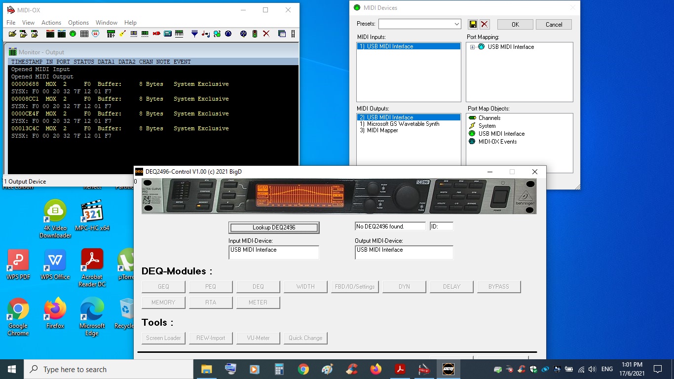

error: can't open midi ports, they could be in use by another application
Thanks very much for your effort developing an useful DEQ2496 editing software. It worked well for couple of times but just found this error message when trying to run the application. It reads "can't open midi ports, they could be in use by another application". I run this on Win 10. Not sure you have ever encountered this problem.
Hello, sorry for my late replay. But I'm a handicapped people and I couldn't answer earlier.error: can't open midi ports, they could be in use by another application
There seems to be two different problems:
1. In your screenshoot, my tool sees the midi ports provided by Midi-OX but the DEQ2496 doesn't answer. In the Midi-OX windows you see that the request is beeing send by my tool to the midi-port but there is no answer tfrom the midi-device. I saw this issue while development witch cheap midi-interfaces <10 EUR and Windows 10. Also this happened while windows is running in a virtual mashine.
2. The message 'Can't open MIDI Ports, they could be in use by antother application.' comes up if Midi-OX doesn't report a free midi-device. I saw this behavior when Midi-OK is running twice. Please check in your taskmanager if it is already running.
Kind regard
