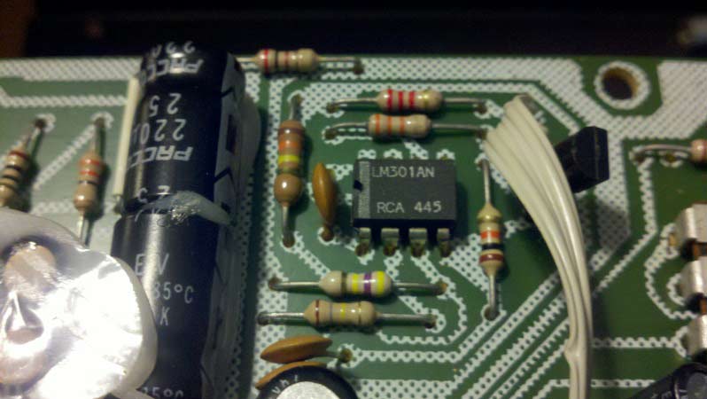

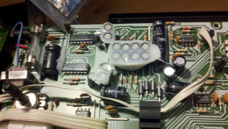

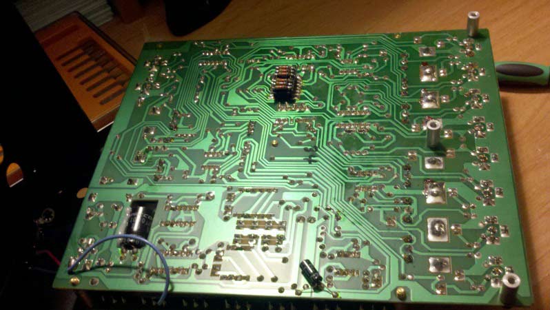

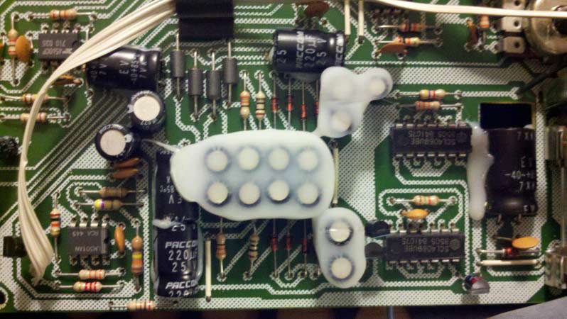

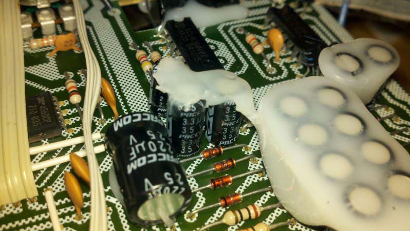

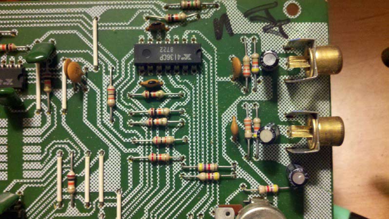

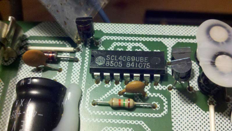

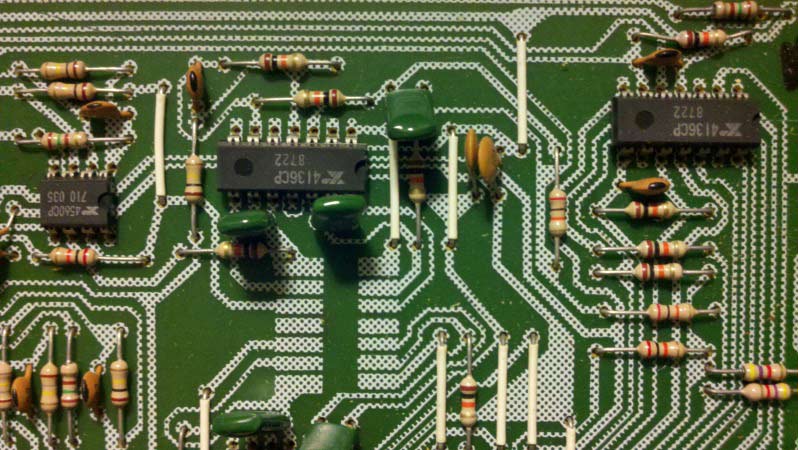

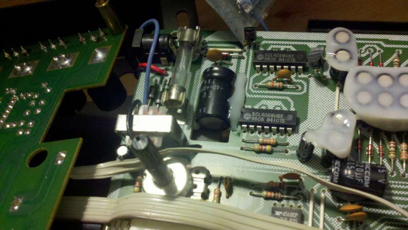

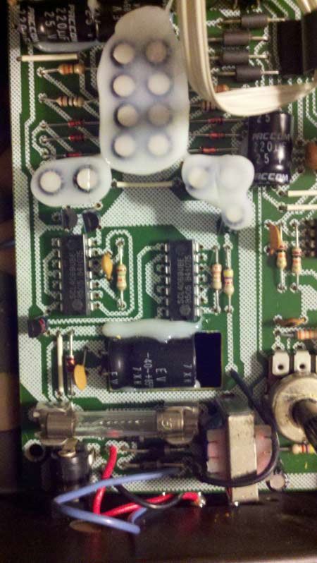

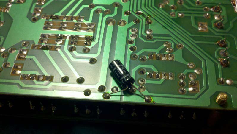

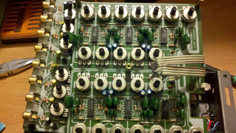

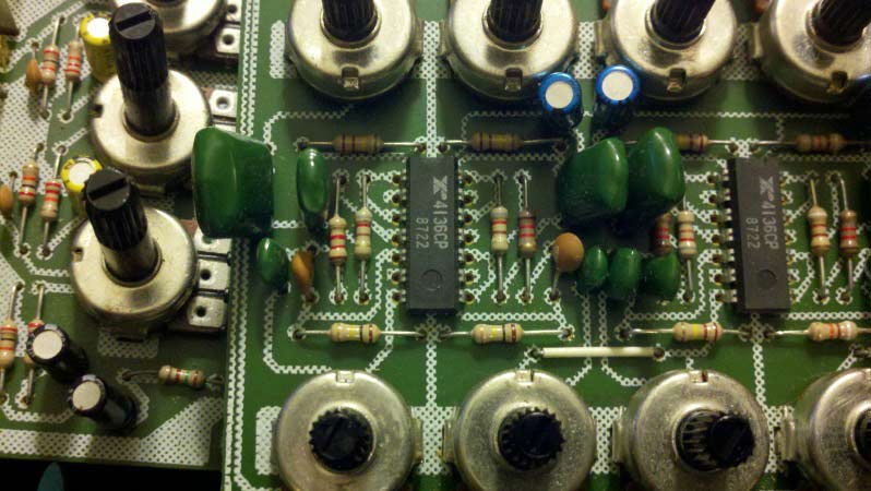

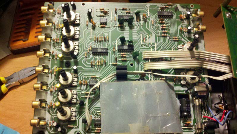

Hello everyone, I am very new to the world of proper electronics. I can conduct basic repairs on amplifiers and simple things, but I am not satisfied with that. I want to learn more. I want to make things better. Make them the way they should have been. I caught wind of a few guys "modding" amps, HUs (head units), passive crossovers, etc.. with basic opamp upgrades, mosfet improvements, and cap replacements. I will admit I do NOT know the BETTER brands that will give the better results. I do NOT know the electronic skill set that it takes to upgrade the uF or V of a particular peripheral to gain a specific desire. However I am willing to learn. Attached below are pics of the guts of an old school active Audio Control EQX. This thing will be used in an SQ setup for next seasons SQ/SQi car audio competition. My goal is to make it cleaner and warmer than it has ever been.

Hi ,
I think it's quite impossible to do any improvement on that circuit .
I see the stamped numbers on the ICs , it belongs to the Eighties .
I don't know absolutely nothing about car ,SPL etc. but basic rule tells
me that 'less is better' ,'cos every added circuit in the signal path brings noise and distortion ,so in the end what that EQ/Xover adds , it also takes something.
Well , I guess it has also the electronic Xover feature ,because I see a pair of RCAs at the input and a lot of outputs ,or maybe it splits the signal to front and rear ...
Changing the input and output and interstage coupling (if any..) caps ,which are
electrolytics ,to some film -polypropilene caps would only reveal a little better what the mess of circuits is sourcing 🙄

Thank you for the information!! I was thinking of swapping the quad opamps with these:Digi-Key Part Search
and swapping the caps with equal values Elna caps for a warmer sound. I like your last sentence. Love it actually. I want the circuits to reveal the source units output as much as possible as we will be running as clean of a HU as possible. After reading some of you guy's modded DACs on here that is debatable! This forum is amazing. I cannot agree more with your less is better quote. I commonly refer to it as the KISS method I will not waste your time with the names of the circuits your mentioned and I will google them for myself. Thank you for the knowledge and I look forward to being schooled further by others on here.

Actually , I really don't like the way op-amps work , also the discrete made ones , they still 'operate' with negative feedback (NFB ) circuits ,which I don't like .
That's why I'm dubious about changing electros to film caps , because they'll reveal better the 'inside' troubles of the circuit .
Oh ! never mind 😛

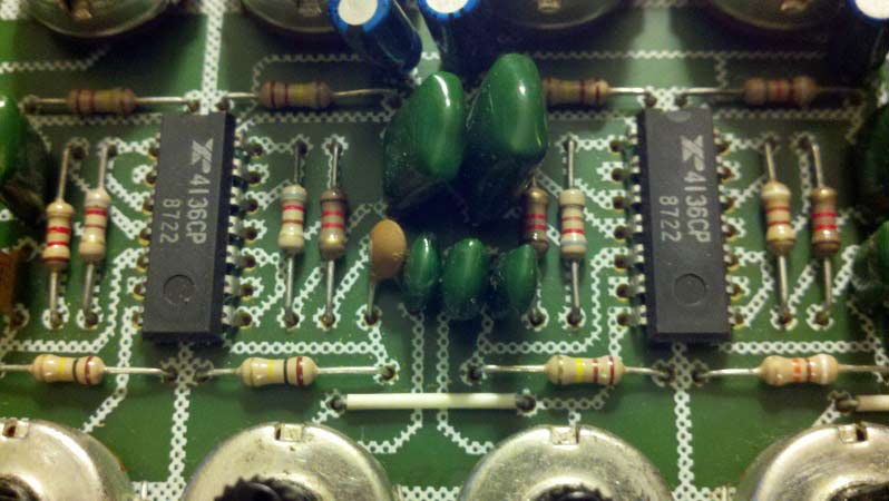

So are you suggesting that I should replace the 2.2s out with some Elnas of the same value or find some higher quality Polypropylene caps? I do not want to cause any damage to anything. However I do not see how I could if I keep the values the same. Not like I would be increasing the resistance. Just altering the material used in the filter.
The 2.2 µF value sets the highpass frequency , which would be around ˜10 Hz .
For values till 4.7 µF it's ok to use polyprop or polyester caps instead of electrolitycs because of the size . So if you need to change the highpass frequency point ,you can choose values well under 2.2 µF .Resistor remains unchanged ; also , the circuit that follows would probably have another capacitor at its input.
But this is for passive filters circuits . Probably the ACEQX has also a fixed highpass , I mean ,those resistors on the back of the board would suggest that they could be changed if needed .Are those 12 K ?
