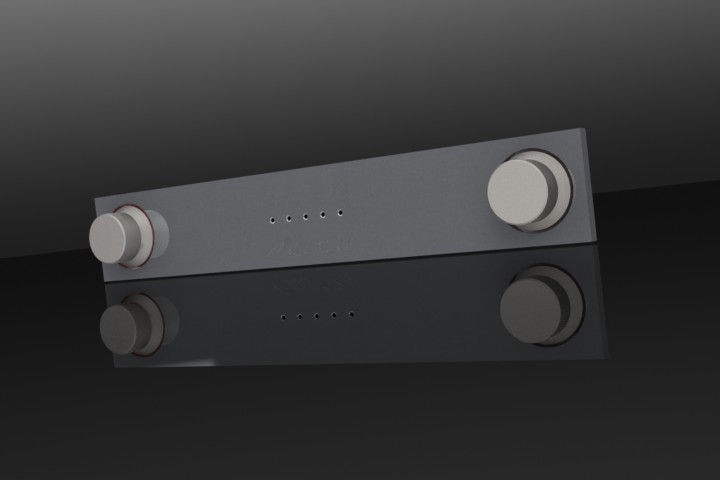

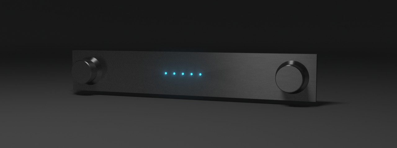

I have attached two pictures of two designs I'm working on.

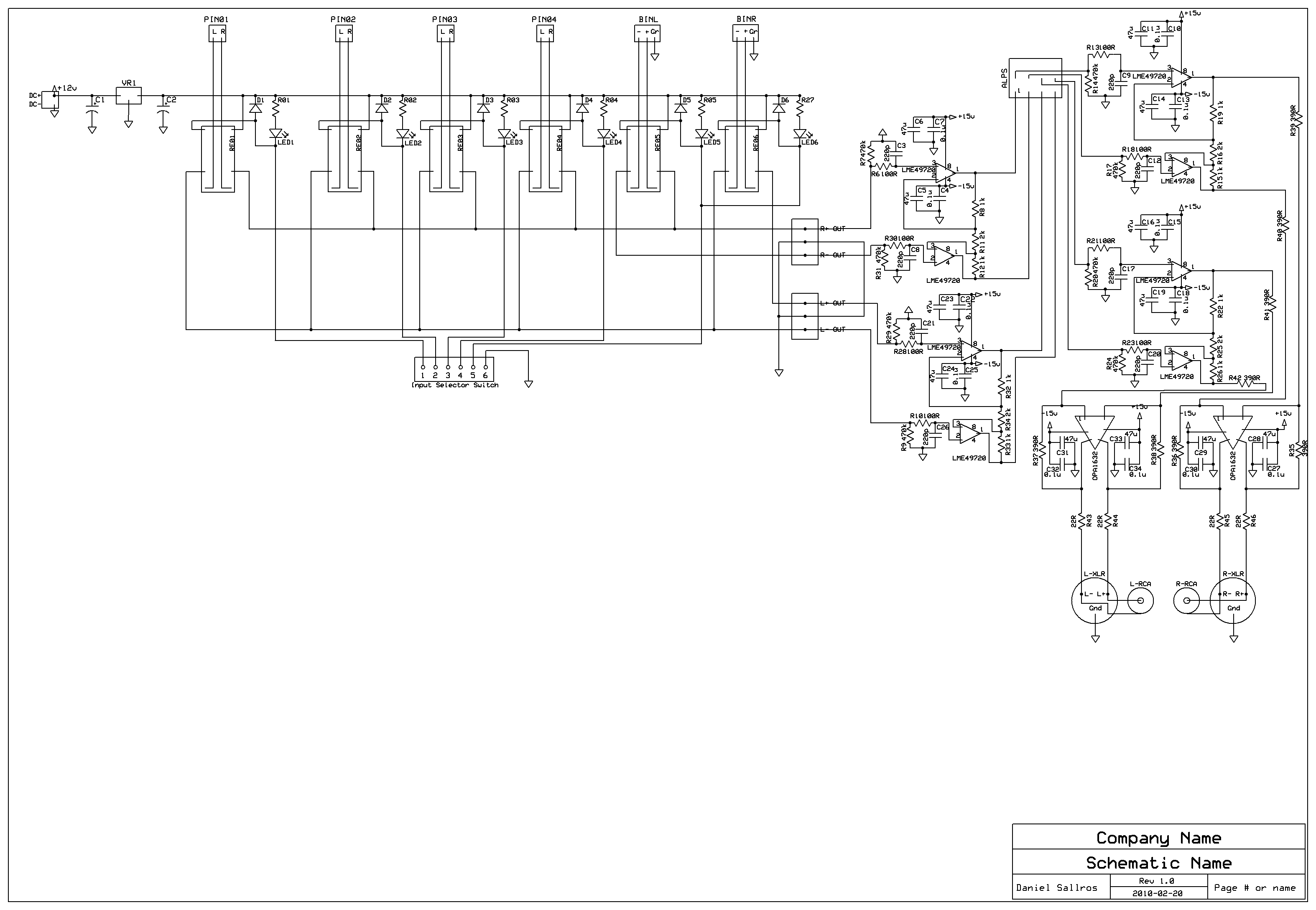

Thanks fastbike1!
I have done some schematics and pcb designs for this project now. This IS my first time doing this and I know I have borrowed ideas from others designs but I really hope this is ok as I don't have any thoughts about selling anything hence not making money off of someones designs.
I'll attach a gif of where my schematics are at the moment. I have yet to put the power supply stuff in there but if someone spots a problem with the schematic, please let me know 🙂
Best regards,
Daniel
