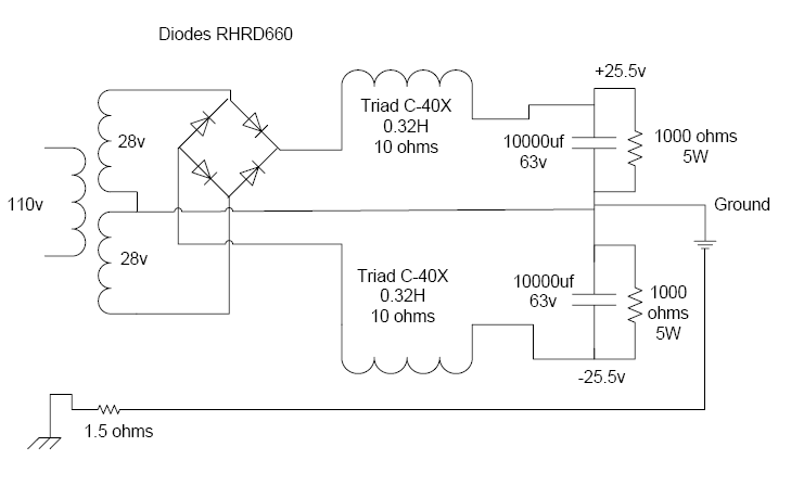

The reason that I use a choke input supply is that with the right choice of components and matching them to the current draw of the preamp, one can achieve your goal of having the transformer supply constant signal to the capacitors. With the values I use, the charging current flows constantly through the inductor and is a nice sinusoidal waveform. The ripple on the output is also small - about 7mv, so the supply is quiet. A rough guideline is that if L (H) > Vout / Isupply (ma) then you will achieve constant current operation through the choke. So for a 0.32H choke and an output voltage of 25.5v one wants Isupply to be greater than 80ma. A detailed simulation shows that the real minimum current is 71-72ma, but this is a nice simple formula to remember. That is the reason for the 1000 ohm resistors in the schematic. The FET 10/hl draws around 55ma so there needs to be some extra current consumed to achieve constant current operation. The resistors add another 25ma current draw and insure constant current operation.
The impedance of the choke limits the current so a larger transformer won't provide any higher charging current. Thus I am not sure there will as much benefit from a larger transformer in a choke input supply as one sees with a capacitor input supply. But I have been surprised in the past, so I agree that it is a worthwhile experiment.

I've built yet another power supply for my Threshold FET 10/hl. I've incorporated suggested from Zenmod and Eric Juaneda by moving the position of the inductor for the negative supply and also increasing the size of the power transformer from 28VA to 160VA. I used a transformer that I got from ApexJr. Attached is a copy of the new schematic. In addition to what I've drawn, there is also a snubber across the transformer secondary (324ohm + 22nf) and bypass caps across the 10kuf electrolytics (10uF 63v (type K73-16) and 1uF 200v (type K40Y-9) and 0.1uf 630v (type K42Y-2)).
As Eric suggested, the bigger transformer is a worthwhile improvement giving better soundstage and a more natural and musical bass line.

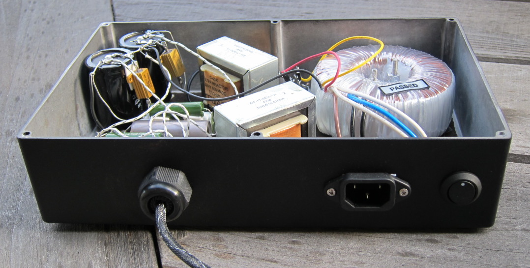

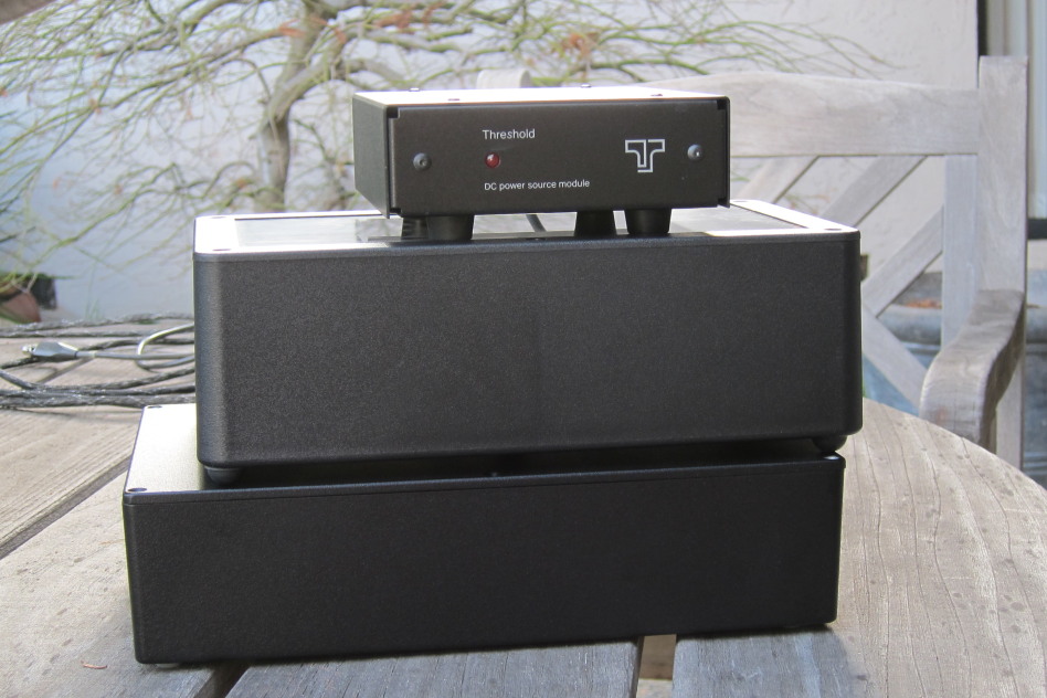

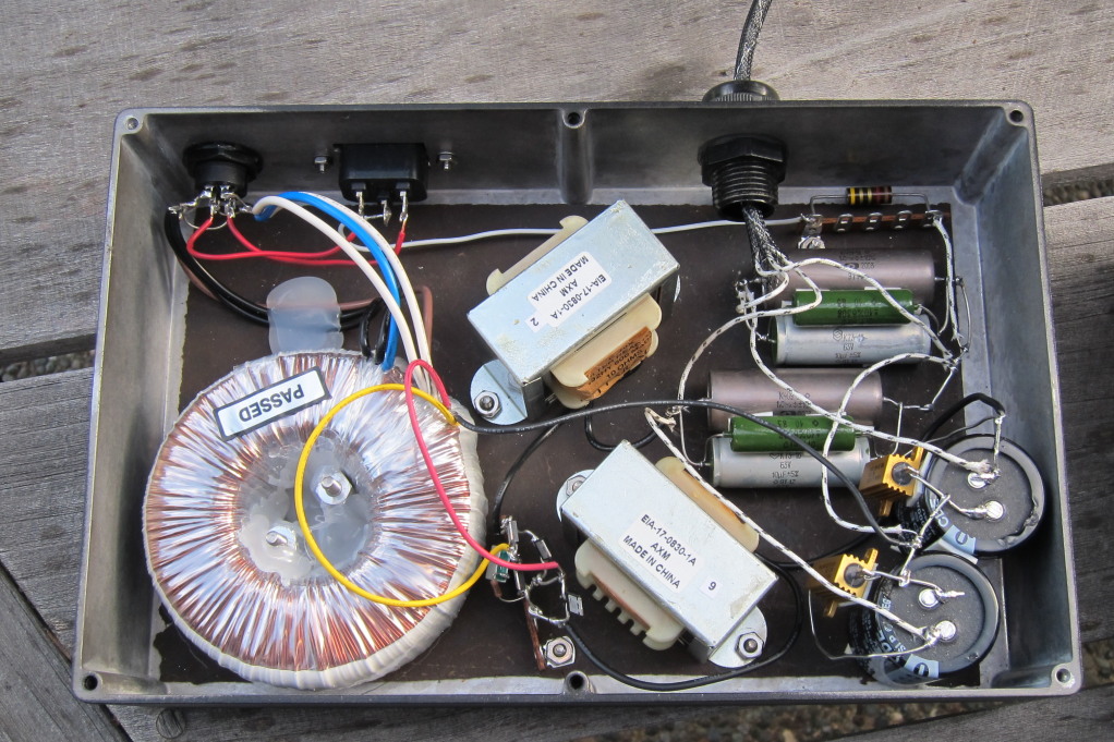

Here are a few pictures of the new supply.
1) The 3 supplies stacked; the latest one is on the bottom of the stack, the original is on top, and my previous supply in the middle.
2) A view inside the power supply.

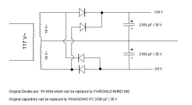

I need to Threshold FET -10hl Power supply SCHEMATICS , My power supply 15-0-15 AC.
tfender
The original power supply is very basic. It uses a small transformer (6VA), standard diodes, and modest capacity electrolytic capacitors. If you're building your own power supply from scratch then you want to improve each part. Use an 18v/18v transformer but increase the capacity to >200V. Use better quality diodes. And increase the electrolytic capacitors to >10Kuf. Other things that I would do include adding snubbers to the transformer to kill off any remnants of the diode reverse recovery and adding some film capacitor bypasses to the big electrolytic.
Or if you want to try something different, take a look at the power supply that I built in post 66 http://www.diyaudio.com/forums/pass-labs/167856-new-me-threshold-fet-10-hl-what-refurbish-7.html#post2442801
But the biggest benefit comes from using a bigger power transformer.
