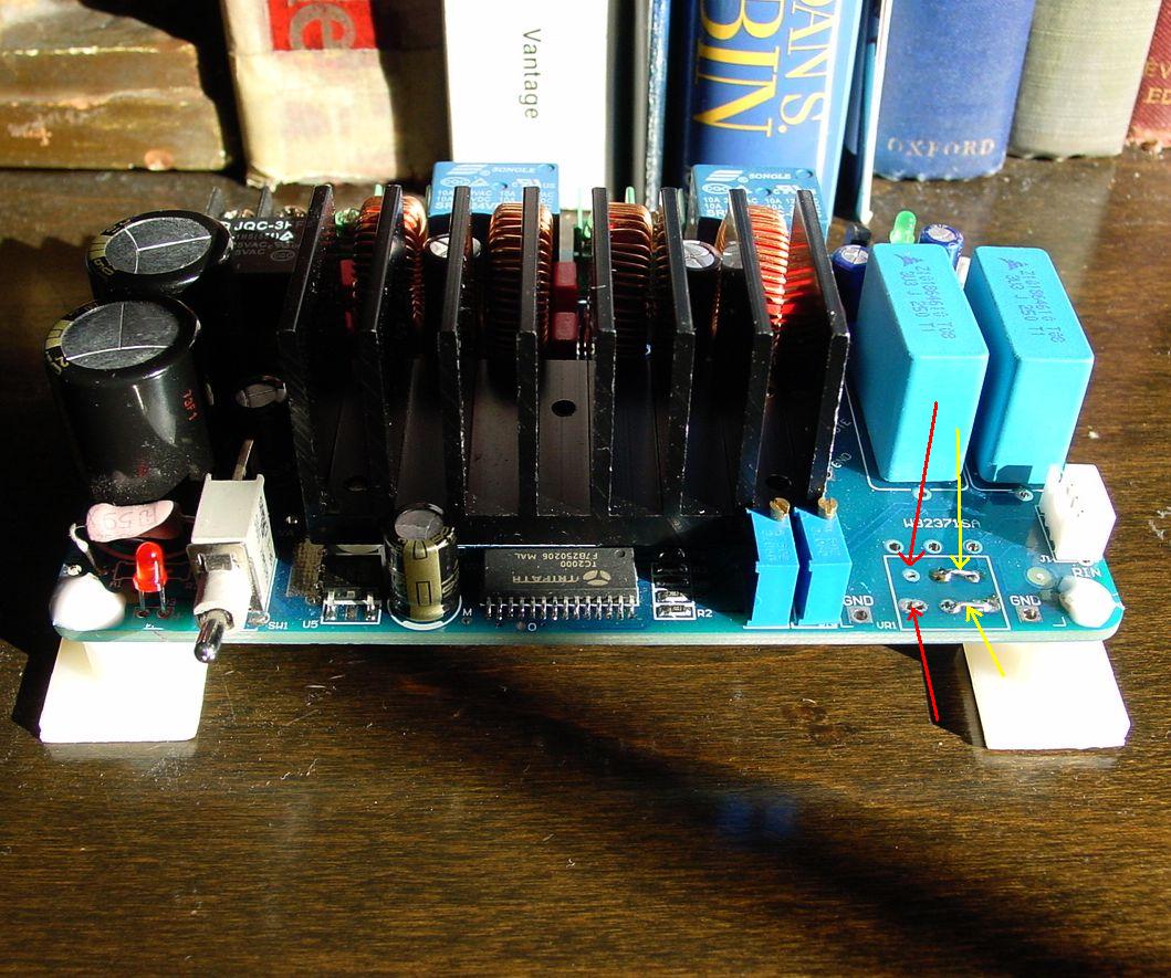

yep it's the sure board, but lenta thinks about T2 for multichannel amp.
You can remove the pots. It's easy to replace the caps on T2, I don't like to leave input caps off board, but if you feel like it,why not.

If pot is ofboard then it must be conected to all T2 with wires, so I thought it would be better to use caps with its long enough leads.
But caps are there not only for DC blocking, maybe thats why in these sure mods you need to remove some other caps?Is it that easy on T2? :rolleyes:
Hope this helps, this is a picture of a T1, T2 similar. I removed the pot, notice I had to jumper two of the pot contacts (yellow arrows).
Also, red arrows show where external pot feeds in. I also replaced the input caps, but decided to leave these on board since the new ones fit.

In the above, the jumper are needed because the molex plug is used for input signal.
If you don't have molex connectors or don't want to use this plug, you can solder the input signal cable directly to the board. No jumper needed.
Thanks Alkasar, I knew there was something I was forgetting late. Never mind my red arrows, if you jumper like I did, you must use the Molex connector for your input.
FWIW, on my T2 I wanted to keep the volume pot, but I believe in general that the fewer connectors the better. Some folks believe that each connector joint has variable resistance and capacitance that degrades the signal - I'm not sure about that, but if I can eliminate a connector, why not? So I desoldered the Molex input connector and soldered the input wires directly to the board.

If I connect input like in picture it will work? Or both sides off cap must contact with the board? I have no boards yet, but it is important to know before.
