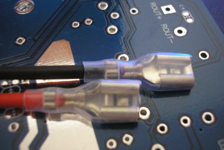

Cables for T3. Made by hands:D

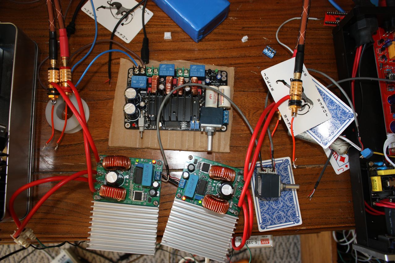

Trying the T3
I have received a pair of T3. Don't have the PSU board yet. Currently hooked them up to two meanwell SMPS's, one 27V and on 36V meeting at around 30V.
They do make a sound when power on/off. First when I tried them, they made almost no sound. But I discovered that when I connected a source, a quite unpleasant, but not too loud pop/click sound emerged on turn on/off. Most when using my ipod, less with DAC, but still a bit. On the 87db/w speakers it is ok, not really a problem. on the 99db/w speakers it is more unwelcome..
Just listened a little bit to them so far.
First I connected them without any vol pot, as I didn't have any. It was of course very loud, but I also got a quite loud shhhh sound in the tweeter. Now with the pot, the shhhh is very quiet, but if I open the pot completely it is back. but as soon as I close the pot 1 mm only, it dissapears. Can anyone explain this? Not a problem of course, most out of curiousity.
I have also tried connecting them to only 1 SMPS, and could't hear any noise on my 99db/w speakers.
EMI? You can try to connect the metal part of pot to GND on board.:)
