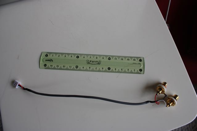

cable with rca available
I have made some of these cables that i will include for an additional fee for people who wants to get sound out of the board quick, no need to solder! Of course, if you later want to put the board in a case and install the plugs into the case, you will ned to desolder them.
