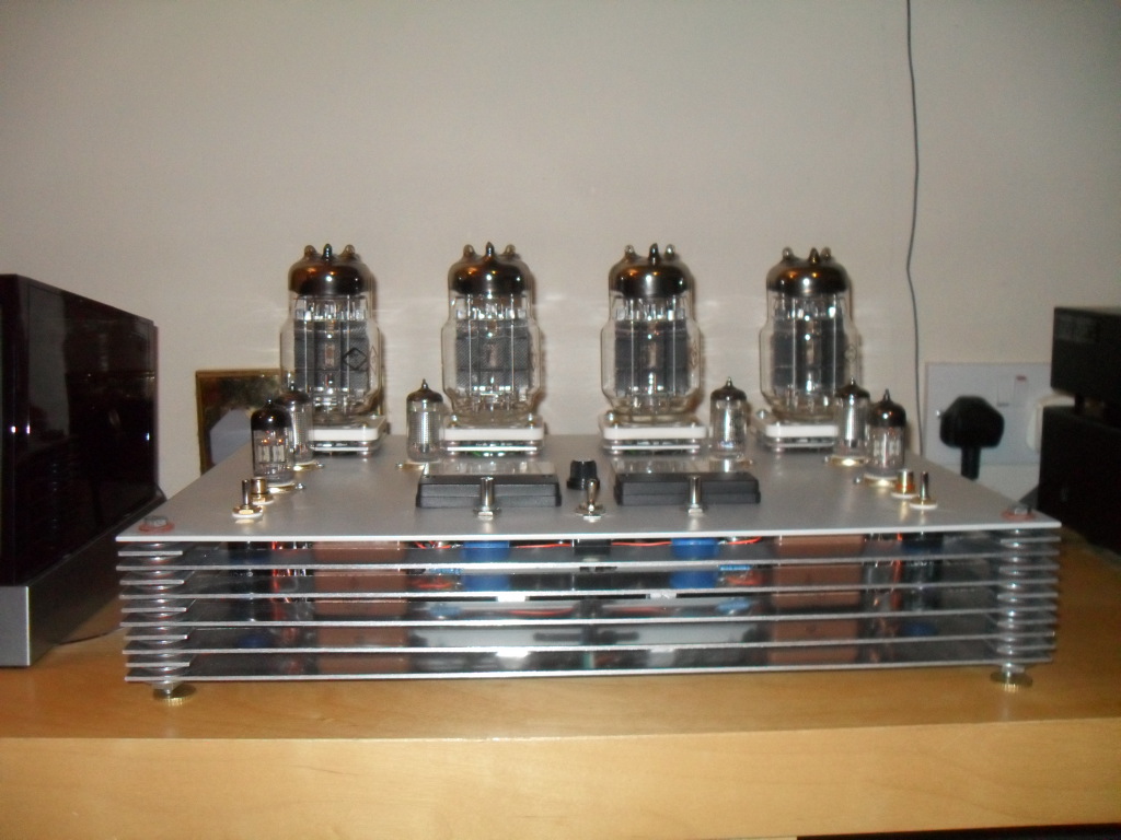

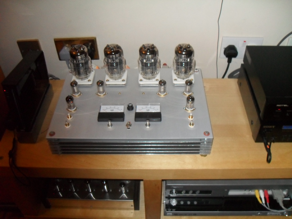

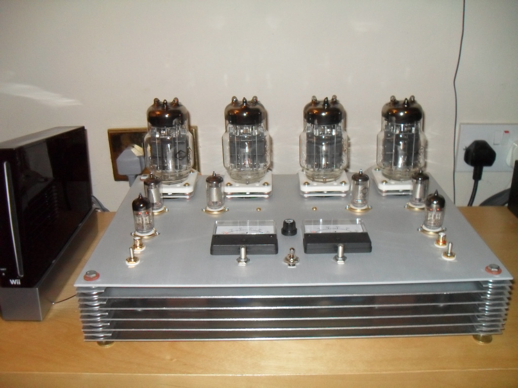

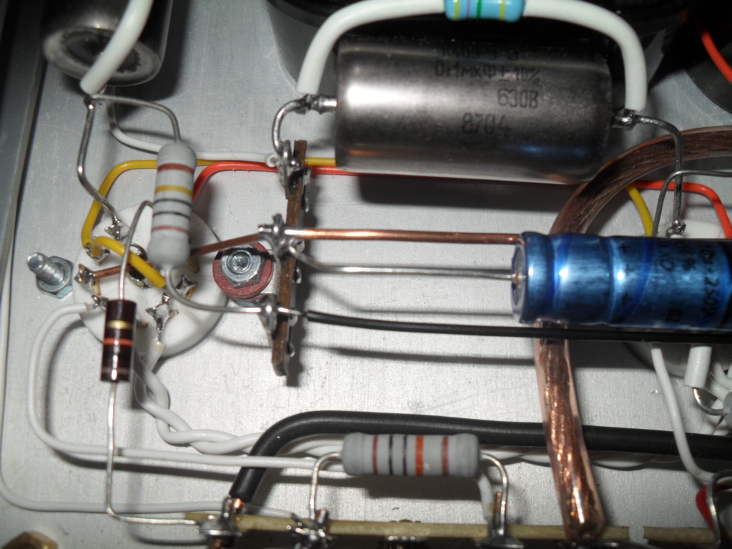

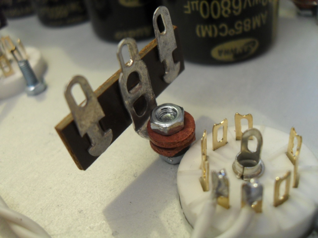

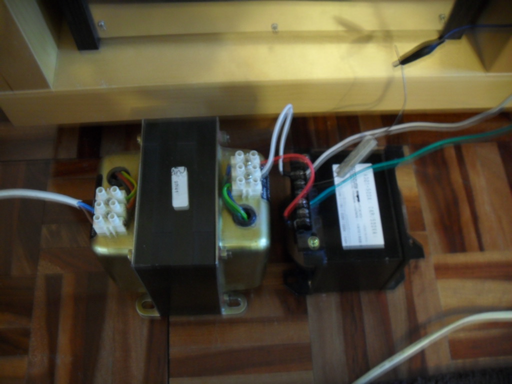

I have been so busy listening to the new amp I have not had much time to post anything.. so here are of a few more pictures of the amp
I can't say its finished yet, but its all wired up and working and sounding fantastic.
I intend to wait till its run in a bit longer before turning it up really loud, and so far I am running the bias at 150ma Maximum.
I have wired the the heaters to the first stage via a jumper tag so that I can swap to my Mullard ECC83's quickly for a comparison test, not sure weather you can see this in the detail in the pictures posted already, if not I will post a close up.
The mid point voltage has settled down to within a few volts using my "auto transformer centre tap but I still intend to try my resistor centre tap idea to save having two HT transformers.
Tony.

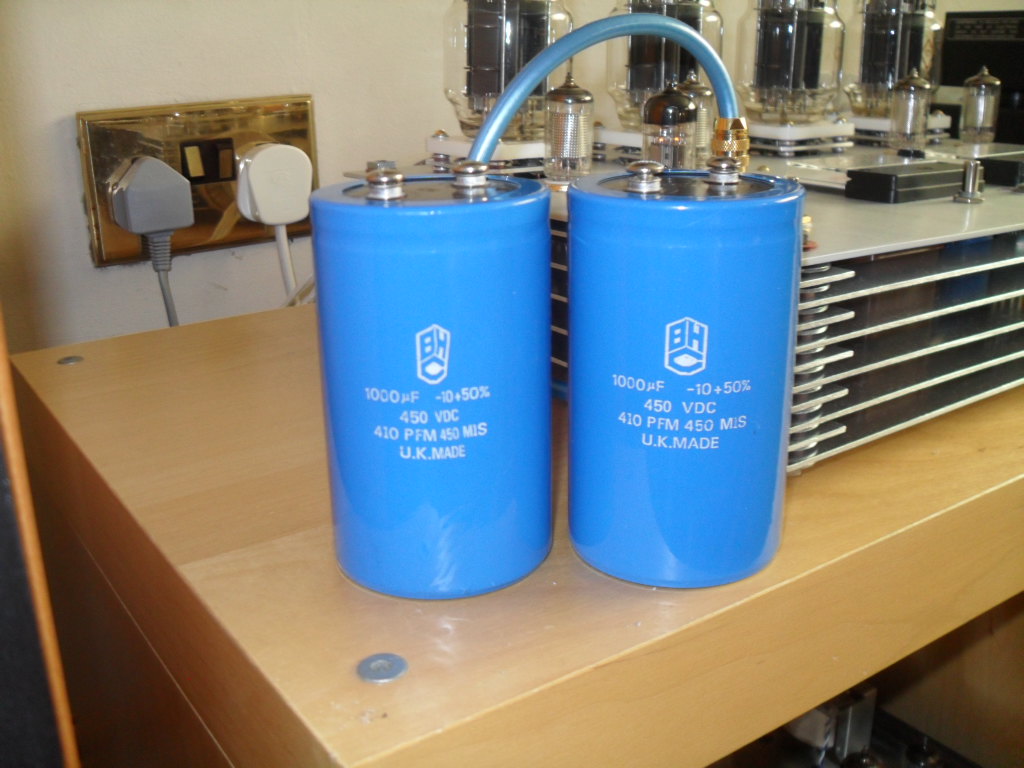

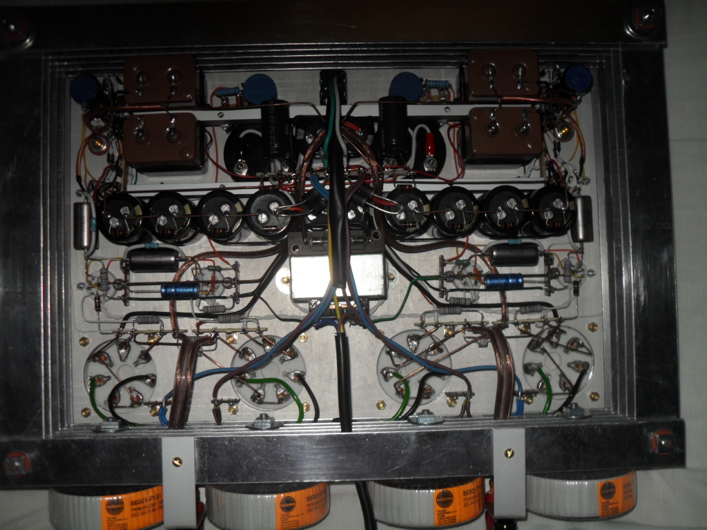

Good Morning Gents,
Interesting discussion.
Having spent around a year searching for a more powerful valve amp since finishing my Mullard 3-3 stereo version.
I had decided on and then rejected several designs including 300b se's, pl509 otl's (as I have 4 of these tubes)and finaly Andrea Ciufoli's simple otl (thats what got me interested in 300b's)
When I decided on Tims design it was "a leap of faith" so I have followed his article as closey as posible as regards component types, Plus as I wanted a slim style with no big transformers and caps sticking out of the top the 8 seperate caps fitted the bill here too.
In my layout I have arranged my caps with the earth at the outside edges( to keep the high voltage psu parts away from the signal stage) so I could quickly disconnect the two earth busbars and tap in a couple of the 1000uf 450v caps that I have in stock and then do a listening test,
what do you think?
Tony.

The audio output signal is the product of the power supply voltage "modulated" or "shaped" by the output tubes and delivered to the speakers , so you can't ignore the importance of a good quality power supply voltage in an amplifier only by speaking about the audio signal path .
And something else , if we disconnect the centre tap of the power supply in an transistor amplifier , would this amplifier sounds the same and deliver the same power to the speakers ? definitely not , the same thing happens in an tube amp. which has a similar power supply .
I think then we are in complete agreement; there is more to a power supply than just the audio signal path. My previous comments were specifically addressing the restricted question of the audio path, and I was pointing out that regardless of the centre-tap connection or not, the capacitors are part of the audio signal path.
By the way, I am a great fan of OTL amps, and have built three of them, using the designs of Hans Beijner, Tim Mellow and Alan Kimmel.
Chris
