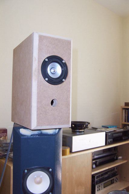

>ML TL photos I've seen seem to place the vent at the very bottom of the enclosure. Is this the rule to follow?
The sim program assumes a big round pipe with a little round pipe sticking out the bottom, so as long as the big pipe is acoustically large WRT its dims it can be any width:depth ratio you want it to be within reason, ditto the vent as long as it's somewhere near/at the bottom. If the driver(s) are used up into the BW where the cab appears acoustically large, then more care should be taken in choosing a width:depth ratio to minimize reflections back through the diaphragm(s).
>Anything else I need to keep in mind?
Nothing comes to mind beyond what I've already listed.

I did it
i built them as GringoAudio did shown in the beginning of this thread - i�Lm amazed ! don�Lt expect to get ever more for my money. they just smoke my fe103‡” in solo tqwt, filter isn�Lt necessary anyway. soundstage is wide open and away from the speakers. and yes, they do bass ...
W3871S box dimensions
Anyone have some good cabinet dimension recommendations for the TB W3871S driver? Thanks.
