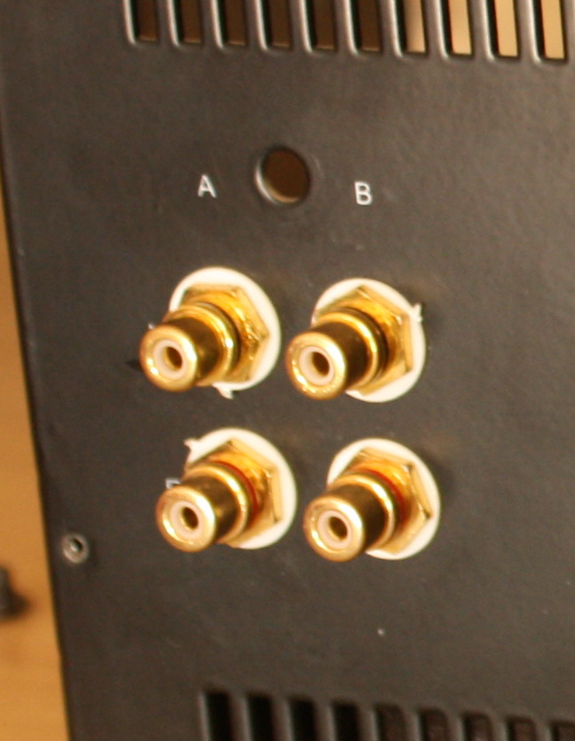

Hi, Bigjppop,
About the Volum,
May be you can try another group input.
A for CDs,
B for Pre-Amp
