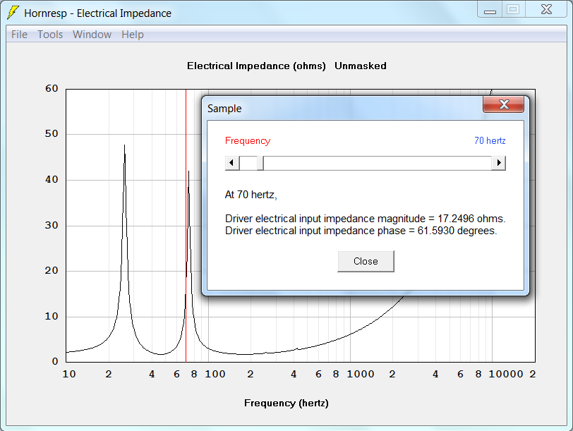

the input power @ any given frequency depends on the impedance @ that frequency given a constant Eg.
At 70 hertz, the driver electrical input impedance magnitude is 17.2496 ohms.

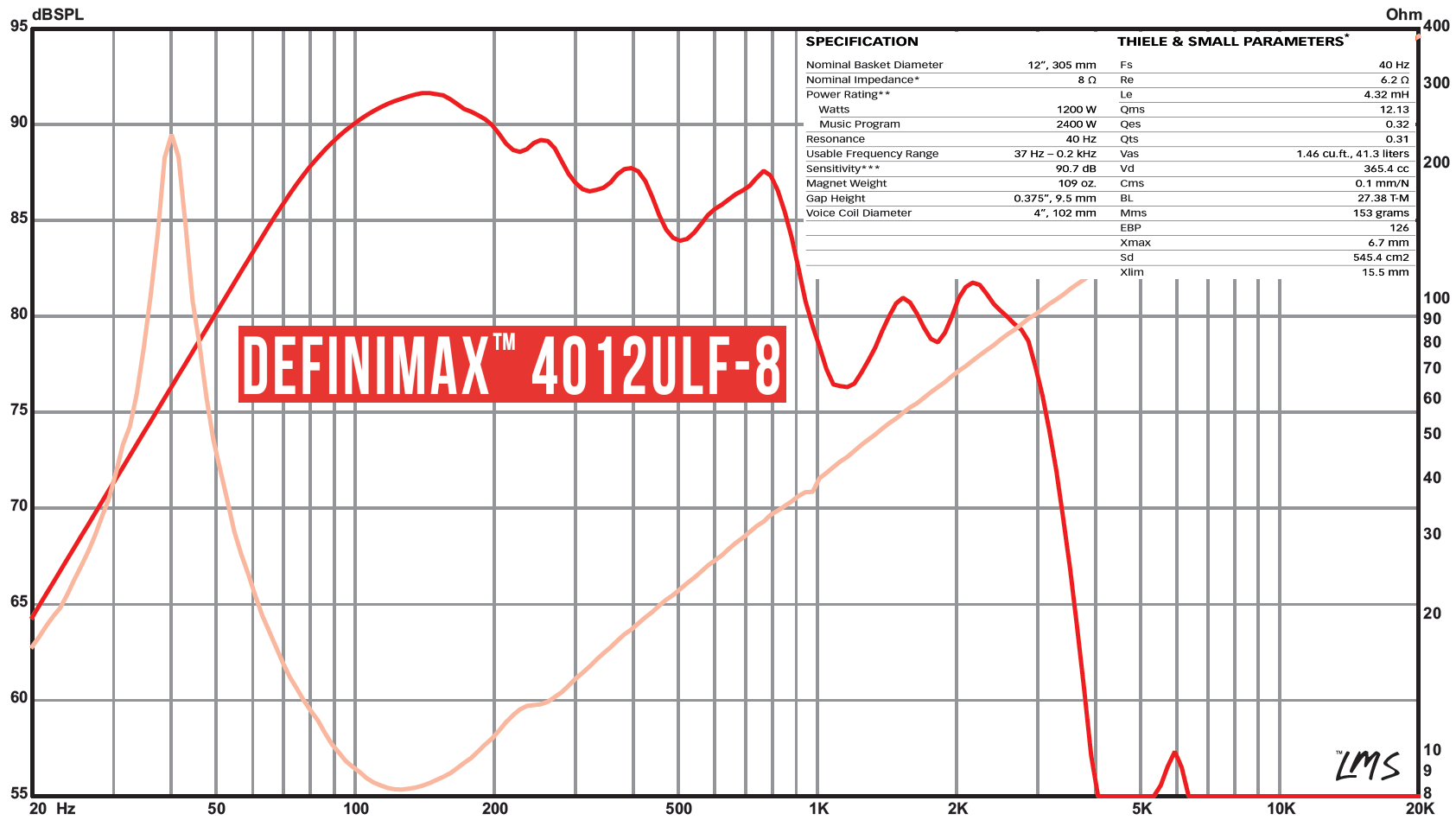

Pioneer TS-W1200PRO vs 4012ULF
Oh yes, good find Kenpeter! That 4012ULF has parameters that are not far off from what is published for the Pioneer (except for power handling and RE , and Le , and some motor strength , but they are still both motor strength monsters considering that they are only 12" drivers) ...
Inductance (per ohm) on the 4012ULF is somewhat higher, and the moving mass is also higher both of which are likely related to the heavier voicecoil used in the Eminence and explains why midbass efficiency and bandwidth is reduced producing that early dwindling of output at the higher frequencies on the 4012ULF relative to the TS-W1200PRO ...
_________________________4012ULF ---- TS-W1200PRO
INDUCTANCE PER OHM(Le/Re)= .69mh ---- .53mh
________MOVING MASS (MMS) = 153g ---- 135g
__MOTOR STRENGTH (BL^2/RE) = 120.9 ----- 89.28
_______________EBP (FS/QES) = 125 ----- 102

I have searched the internet high and low in an attempt to find another 12" $99 driver (which is not strictly a sub) that can produce nearly 120db of output down to 40hz in a 100L Tapped Horn (also works well in a 60L Karlflex) .... The Pioneer APPEARS to be an exceptionally good value ...... The only other option i can find that is value-comparable is the Soundqubed HDS212 which has a heck of a lot more XMAX but unfortunately due to the higher moving mass and higher voicecoil inductance it is very bandwidth limited, and is therefore strictly a subwoofer....
