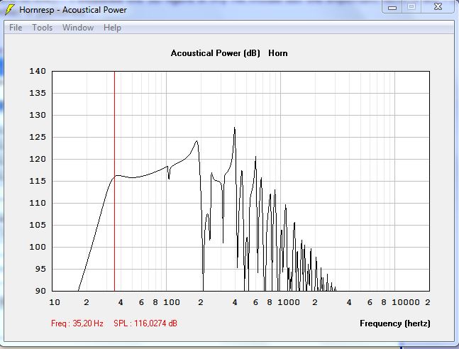

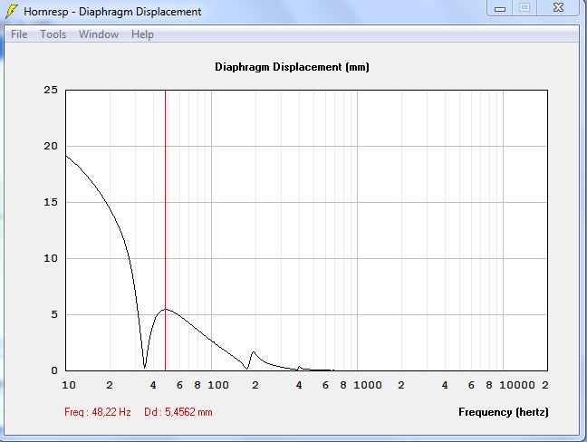

Matthew, i have been looking at Hornresp and came up with this.
Data for the Box 130 liter
FR with a low knee of 35 hz and 116 dB
X max like this
This speaker will be a bit big and will usually be pushed up against the backwall. So I was wondering if FR will close in on Ang = 1 ?
That would gain maybe 3-5 dB extra SPL?
Cheers

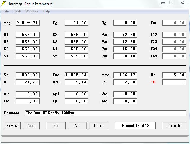

Why is it you use 2 x Le? Is the driver behaving differently in this design, so you can assume this?
Thats just a technique some people use with HR in an attempt to emulate what the response will really look like in real life , I think it was someone here on DIYaudio that came up with it, and it is still kind of controversial ....... It was a response to the fact that people were building tapped horns based upon HR sims that showed underdamped saddle shaped responses , but when built the cabinets played fairly flat in real life (or someone who built a cabinet based upon a sim that had flat response , yet when the real cab is measured they find out that the cabinet had an overdamped hump shaped response .... )....... I have heard a few theories attempting to explain why this virtual/actual discrepancy occurs, some people blame it upon panel flex and lack of bracing, other people say it revolves around the way HR factors Le into it's calculations and they mention the fact that Le changes with frequency...... I have a good example of that with my DATS unit, i can measure a voicecoil's inductance at either 1khz or 10khz (1k is industry standard i believe) , and with my PA310 driver i get .6mh @10khz and 1.6mh @ 1khz ....
I calculated the SD in hornresp and got 890 cm2. Don’t know about the 750, my bad I guess.
I think it is standard practice to measure SD (cone area in square centimeters) by including half the width of the surround along with the cone .... Most of the pro 15" drivers with accordion surround end up with an SD figure in the mid 800s with the majority falling in between 840 and 870 .... Occasionally i will see as low as 800 or as high as 900 but those are much less common ....
If the manufacturer doesn't give you an SD figure to work with just plug your approximated SD into HR then get your other parameters like QTS, VAS, FS as close as you can to what is published, you may find that the BL factor or MMD ends up being off the mark by a small percentage but don't sweat it, this is about as close as we can get without having someone measure the actual driver.............................................. Getting a driver measured is of course always ideal since the real parameters are often somewhat different than what is published. The sample 15LB100 that folks at "The Box" brand measured a few years ago might not be exactly what they sell today because over the years their OEM may have started using a different voicecoil former, or a different spider, a different cone treatment, or whatever , you get the idea ....

Sebastian,
That curve looks about right now 🙂
and yes, that is correct, sitting on the ground and pushed up against a wall would be quarterspace or 1pi , and yes it will show more output on the bottom end 🙂 , it is boundary gain or room gain ... The only reason i stick with halfspace on my sims is to make sure sure i am not comparing apples to oranges if you know what i mean, it just makes for fair comparisons ...

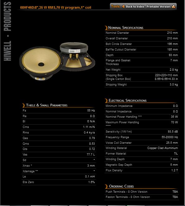

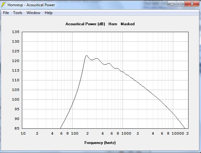

By the way I found an interesting driver for my paperhorns that can reach to 200hz. It's an 8" and it claims to do 19500hz. HMM pretty high for such a big driver. Looks like this:

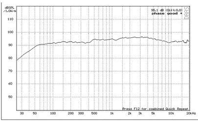

FR
Modelled in hornresp it will do 120 db at 200 hz at 20v, nice.
But maybe I will need a phase plug, or HF will cancel ??
That way I can keep the Karlflex simple. Or will I lose out to much?

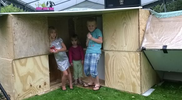

Little people in your horns! =P

Crazy kids! Your too young to rave!
Are those your bass horns? It looks like you have an infestation of children in your horns

NOTE: cats love to use these old carpeted cabinets as scratching posts!
Sebastian ,
Here are some pictures of our cobbled together and refurbished 4-way living room horn system ....
You can see the 4 element transformer driven Frankenpiezo arrays mounted within the fronts of the midrange horns ... The mid horns are made by Electrovoice and contain a 10" woofer which covers about 240hz on up to 2khz , and below those you see the CV B36a cabs which are 36" x 24" x 24" with 5' path containing an 18" driver with light cone and high FS, these are actually decent from 80hz on up to around 240hz where the EV midhorn takes over .. .
The sub in the middle is a clone of an old CV design with 7' path (36" x 24" x36") and is good down to about 45hz (not 30hz as claimed, sorry CV) , the club that used this cabinet first blew the plate amplifier so it had to be bypassed, then ended up blowing out the driver, replaced it, and then they blew out the driver AGAIN .... Djs can be terribly rough on equipment , they tend to hook up things improperly and then attempt to force the equipment to do things the equipment wasn't meant to do which of course causes failures.... We ended up getting some double 18 cabs for that club and this horn cab ended up in my lap .... I loaded a reconed Peavey Low-Max 18 driver into it and it has worked ever since ..... We have thrown 1000 watts of thumpy music at this thing all night long on party nights with no problems at all, and it has generated it's share of noise complaints and visits from the local police on those nights
That was back during the end of our moreso wild phase in life which was only about 5 years ago.. As of late this sub has a very easy life and rarely gets played at high levels anymore ...... It has served it's purpose well enough for what i consider a "dated" 4th order design but honestly the 6th order series tuned tech discussed in these forums such as tapped horns, and Transflex cabs (including Karlflex ,Karlsonator, or a scaled up Xki etc) (with the right drivers) are capable of more performance in a smaller package ....
I just noticed that there are some cobwebs in the mouth of the sub horn , i should probably clean that😛 .... Your horns are infested with children and mine are infested with spiders ...
Sketch and current prototype measurement for Freddi
Freddi ,
Here is a concept for the revamped simple Karlflex, this will definitely get us a higher tuning ..... It is meant to have a very narrow K-slot or a lack of K-slot and just a large mouth open in front of the driver's cone (which is how i am currently running the prototype and it seems to produce the best bottom end with this undersized front chamber) ... I will fix up one of my Akabak scripts to emulate what you see in the sketch to verify that the offset and tuning is correct etc ....
Offset stub (s1) section is 4" across internal, and the internal height of the Freddi-mod cavity and main vent are both 2.5" each ... Distance between top of baffle and the back of the front panel (defining the front chamber) is 3.5" ..
and here is a measurement of the prototype as it is right now ... . I suspect i might be getting a little bit of room gain here because this is an undersized cabinet for such a low tuning, i expected the bottom end to be a few more decibels down from this based upon sims , but hey i am not complaining! 😀 ...... This is with the Dayton mic which i think is sadly giving up the ghost little by little , it only works half the time as if i dropped it or something but i don't recall dropping it or getting it wet or anything *shrug*, i tried a few different phantom supplies and the mic still seems intermittent regardless of what supply i use on it ..... Luckily i have a backup mic i can use until i replace the Dayton ....
The dip at 300hz will hopefully fill in to some degree when we get the FB shifted up .... That lump in response that you see centered around 210hz is the upper odd harmonic resonances (the 5th perhaps) which will shift upwards when the fundamental is made higher therefore helping to fill in that dip..

great details - hopefully you can get a bit more backwave/vent fill around 300 - is the offset stub's distance to the bottom of the cabinet also exactly 4"?
I'm surprised by PA-310-8's on-axis high frequency extension in the Karlflex prototype.

"but a friend off of DIYaudio recently acquired some large B&C drivers which measured considerably different than what is published and that was a big surprise since B&C has such a great reputation in the industry and makes such excellent products .. "
Driver equivalency check:
(Qts^2) times Vas should be within ±10% or better.
Fs/Qts should be within ±10% or better.
That will take about 30 seconds, then you can do a Hornresp or WinISD design if you want a crosscheck.

Right , it looks pretty good up to around 5khz on axis, but as soon as you move off-axis it becomes apparent that the PA-310 starts to get get beamy and lose dispersion above 2khz ..... So i think that this system would be good with the PA310 low passed at 2khz and then a good high frequency driver with a sensitivity of between 96db to 100db @1w/1m would need to take over at 2khz ...
