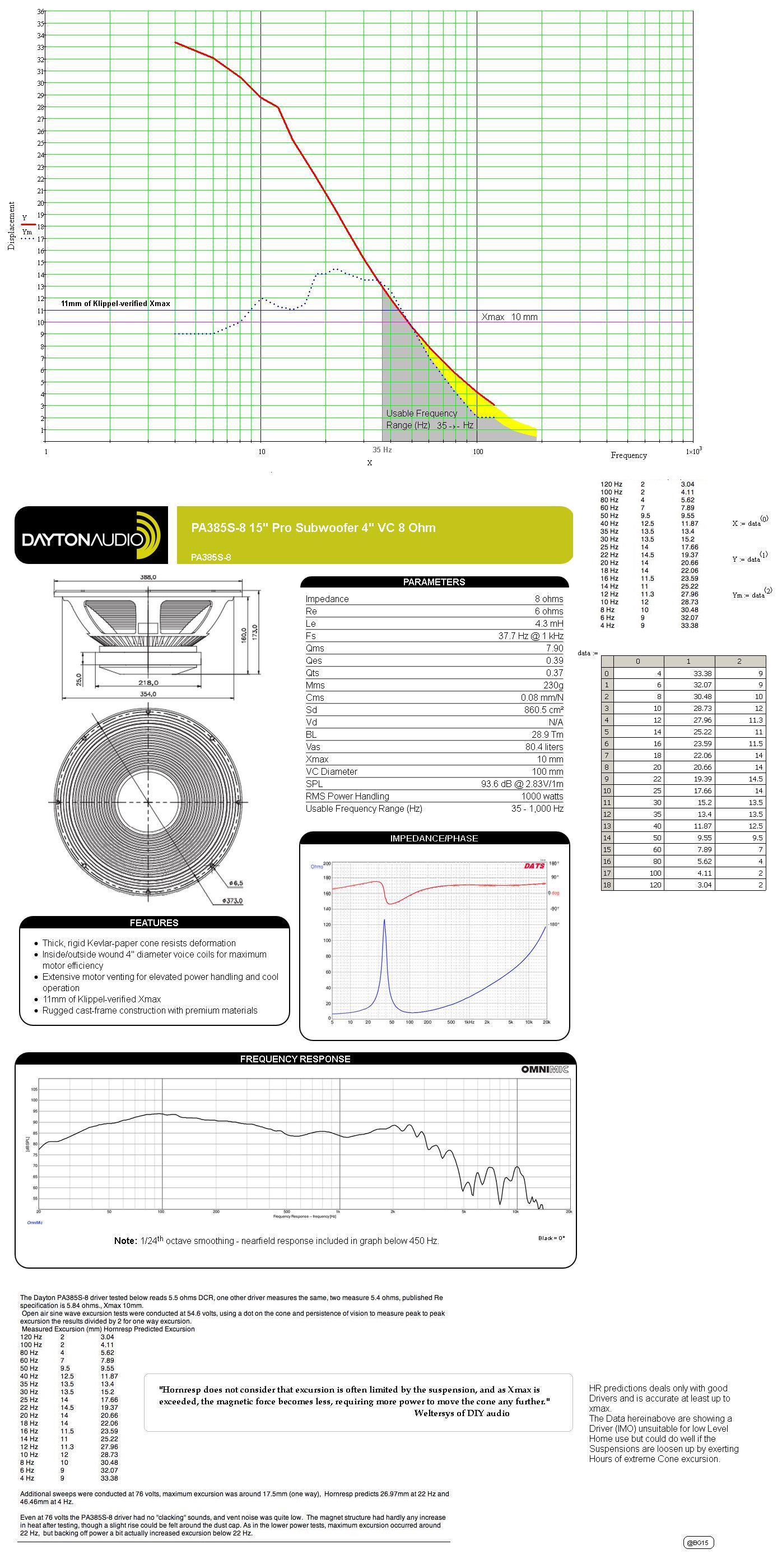

Looking @ the chart MMJ posted in #1354, it would not surprise me to find, that the amplifier (signal chain) used for the measurement had a build-in HP filter set @ ~20Hz. The step from 35Hz to 30Hz is the first one that shows some excursion reduction v. the simulation, and from then on it's down hill. That would be pretty normal for e.g.: a 2nd order 20Hz HP. Anyway, w/o at least a simultaneously recorded voltage input preferrably measured @ the driver I would not trust this information.
MMJ, do you have a link to where you found the data?

TB46 , Yes a high pass filter in his signal chain would explain the discrepancy ....... I ran across that comparison here on Diyaudio recently and decided to get a screenshot and make a note of it since these measurements seem to deviate so much from the virtual model .... Here is a link to the post & discussion:
http://www.diyaudio.com/forums/subw...-18-pa-drivers-b-c-copies-10.html#post3878009
Careful measurements done by Bjørn Kolbrek some time ago showed that the Hornresp predictions of diaphragm displacement are quite accurate, provided that the driver is operated in its linear range and a sinusoidal input signal is used: http://www.diyaudio.com/forums/subwoofers/119854-hornresp-15.html#post1591527
As indicated in the Hornresp Help file, behaviour at all input voltage levels is assumed to be linear, and no allowance is made for low frequency high power amplitude compression.

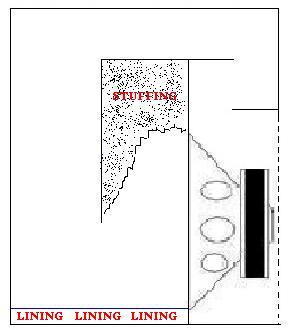

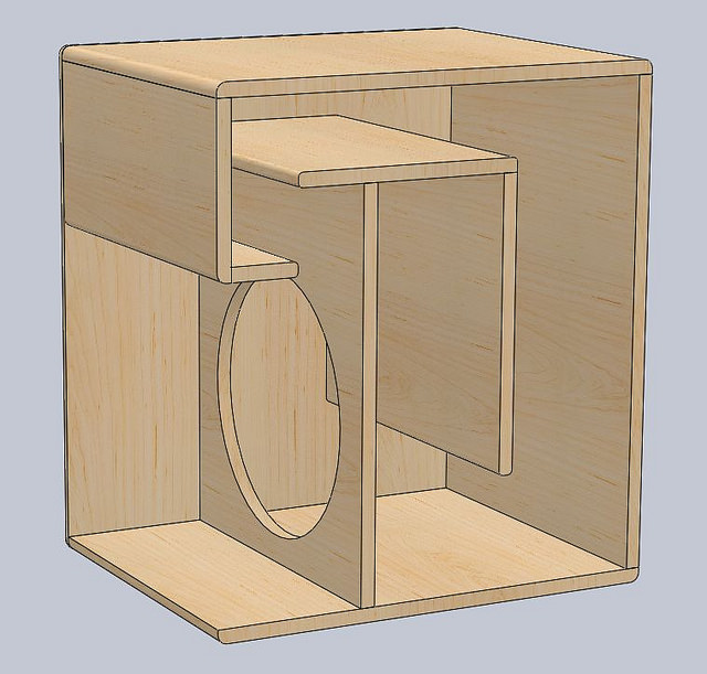

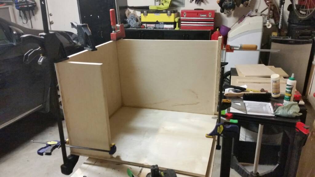

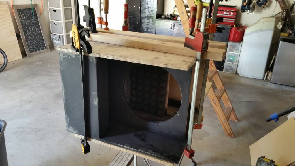

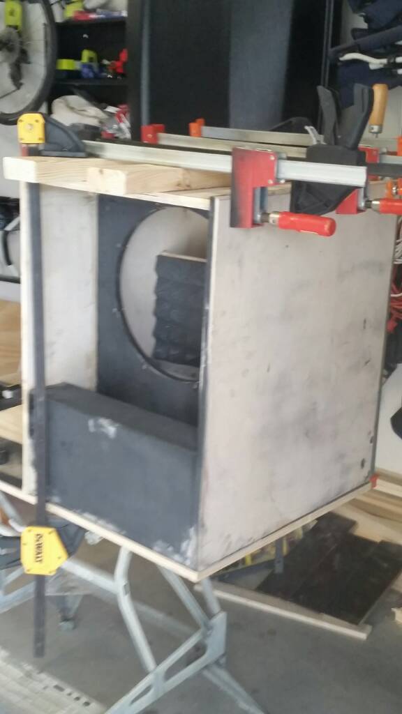

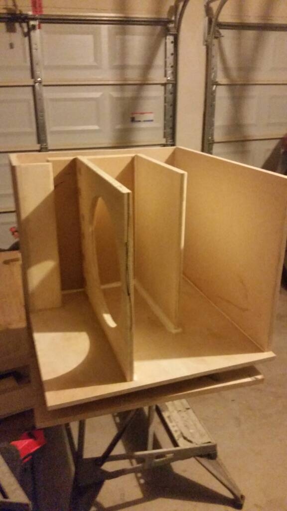

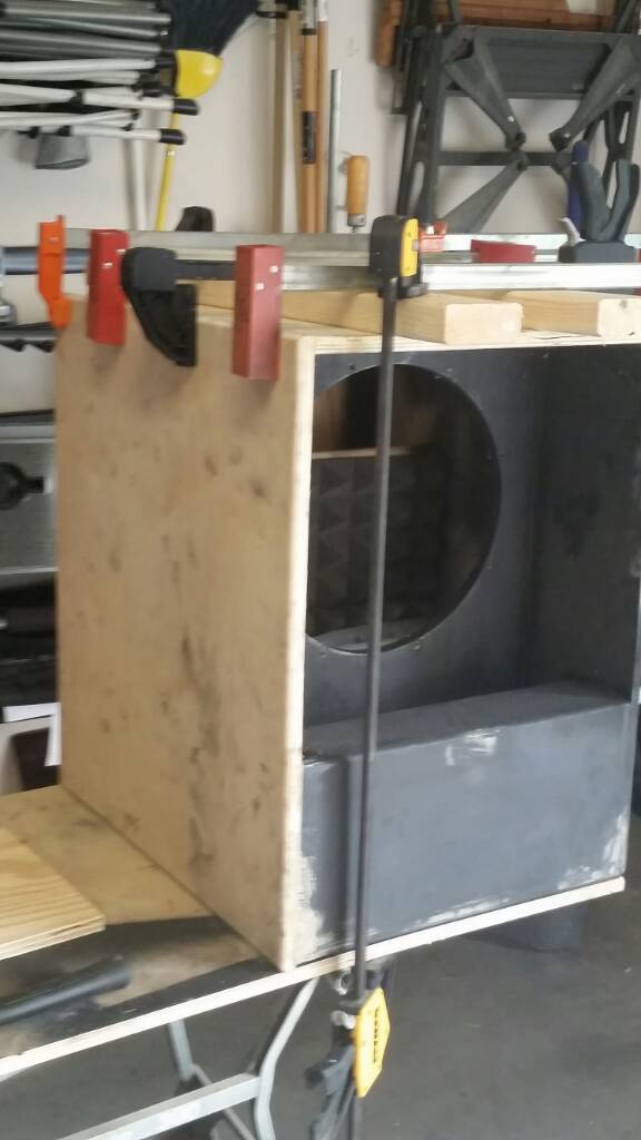

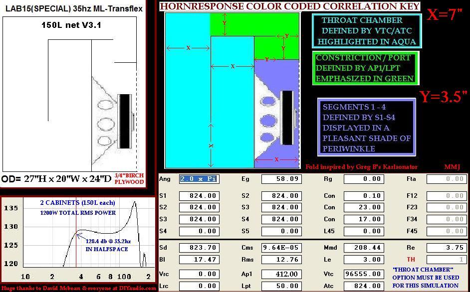

Brian in Texas is building a Mass Loaded Transflex
Brian (SynesthesiaAudio) from Texas is building the Mass Loaded Transflex (ML-TP) version 3.1 for the Lab15-4 (special run) .... He should be done in the next few days, and he mentioned that he managed to source the Special run 4 ohm Lab 15s even though they are no longer listed on Ebay!
I provided a few extra sketches to give him some ideas for bracing and stuffing/lining .... There are more braces than what is necessary in that "suggested bracing" sketch , the most vital are the three that stabilize the the top, bottom and back panels.

Lab15-Special-35hz-ML-TRANSFLEX-DOUBLE-FOLD-149L-BRACING.PNG46.7 KB · Views: 258
Lab15-Special-35hz-ML-TRANSFLEX-DOUBLE-FOLD-149L-STUFFING-LIINING.JPG14.3 KB · Views: 265
Lab15-Special-35hz-ML-TRANSFLEX-DOUBLE-FOLD-149L--DETAILED-COLLAGE.JPG122 KB · Views: 298

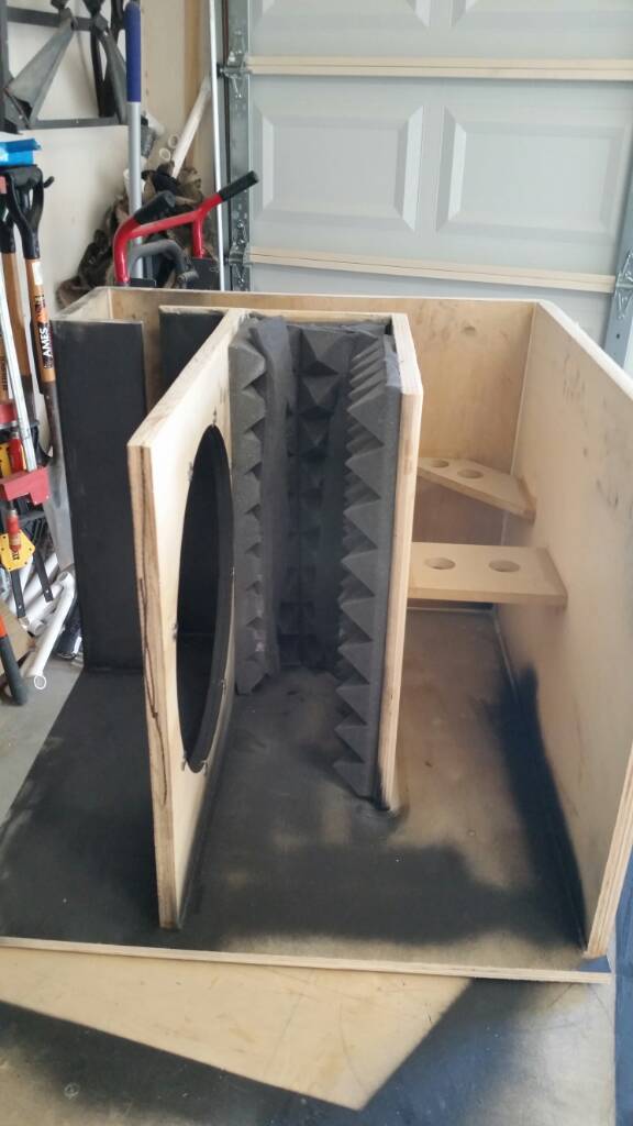

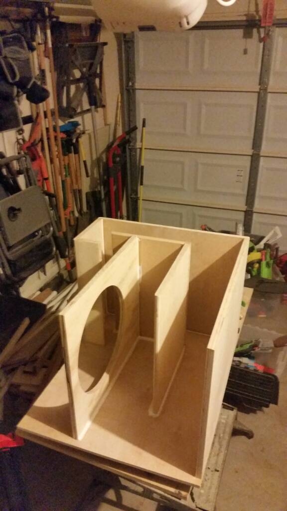

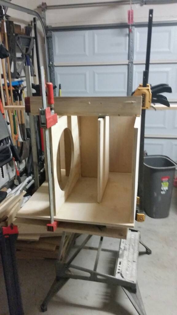

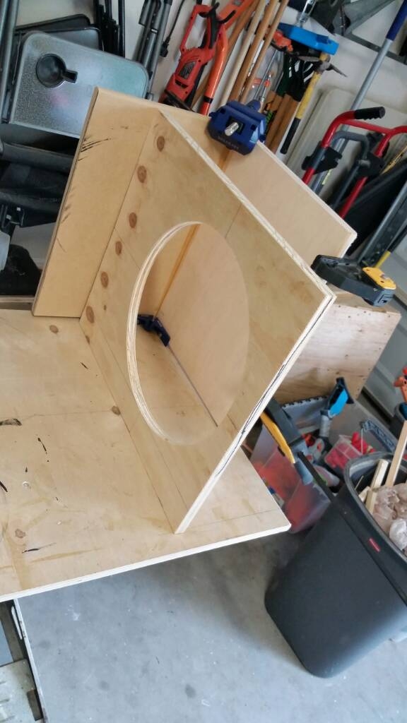

SynesthesiaAudio's 150 liter ML-Transflex for the Lab15-4
A few more pictures from Brian in Texas ...
He is almost done 🙂
He is almost done 🙂

He contacted me a while back letting me know he wanted to build one of these boxes, and i asked him to take some pictures along the way ... Last week he sent pictures to me and i decided to post them here since it was a design that was developed in this discussion (albeit dated at this point), i didn't think it was terribly off-topic even though we have moved on to higher bandwidth configurations ...
I will have some pictures of my own to post in the next few days because i have been working on the Karlflex again, I have chopped up the Labyrinthine prototype , and i am adding Freddi's tuned cavity for testing , along with trying out some cardboard K-slots until i find a contour that works..
