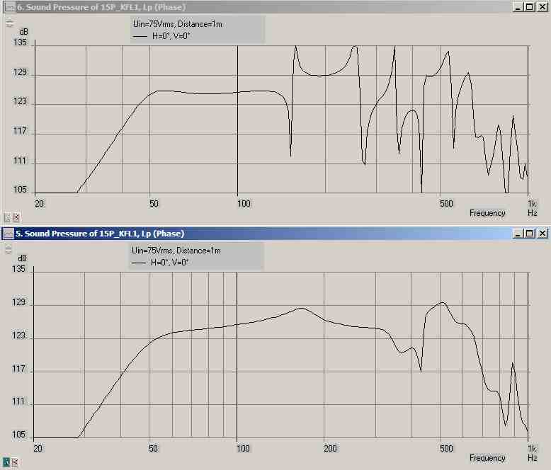

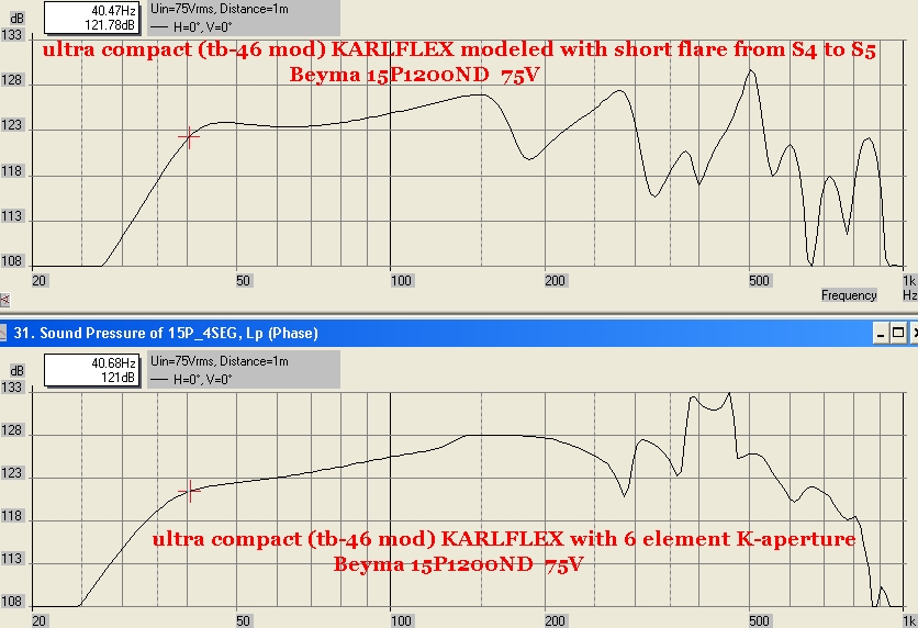

I have attempted to create a K-aperture in Akabak, and i have added this K-aperture to the end of TB-46's Akabak script for his super compact Karlflex attached to post #1188 ..
This K-aperture consists of 6 ducts and 6 radiators (one associated per duct), with the first having small diameter and the last (the mouth) having the largest diameter .....
Perhaps Mr XRK can let me know if this is the correct way to do it?
The upper response has changed significantly!! It looks like we are getting some useful midbass and midrange loading from the small front chamber🙂
FB has shifted down by 4hz (from 42hz to 38hz) and therefore output at 35hz has increased ..... Unfortunately we lose a little bit between 45hz and 65hz ......
Roll-off on the bottom end is much smoother .... With the K-aperture this box appears to be well damped, possibly even overdamped ...
Other minor changes to the script (some just for experimental purposes):
-- Disabled S5
-- adjusted driver offset by a small amount
--adjusted "AcouResistance" (damping /stuffing) by a small amount
I attached the Akabak script so folks could review my edits, and let me know if i did anything wrong .... I am still learning to use Akabak so there may be some mistakes ...

Nice work - that is basically how a K aperture is implemented. I have not looked at your script but do you also account for the spatial offset of each radiator? I used rectangular radiators instead of circular ones - not sure if it makes a difference.

When the radiators all connect to different nodes that are spaced apart does that provide the spacial offset? I can try switching from duct diameter to duct height & width to see if it changes response ...
Here is the code that i used for the K-Aperture:

No, you need to specify x=, y=, z= info below each radiator. The distance refers to the principal axis typically the vent opening centerline. So the middle would be zero and above is plus and below negative y values. Z is into or out of baffle. X is left right lateral offset. Look in manual at example of speaker with two angled tweeters and a woofer. Without this, all radiators are assumed to be spatially emanating from single point. For first order effects it works but not realistic.
AkAbak for Post #1188 Beyma KARLFLEX
Hi Y'all,
This is my second try at this post, if I could only type. 🙂
Obviously, xrk971 is correct for final accuracy you need the coordinates for the radiators. You also need to account for all internal volumes, including the volume(s) in the front chamber. I tried using ducts in the front chamber, and attach the radiator ducts (wood thickness) to the nodes between the ducts; I'll attach a sketch, and the AkAbak SPL w/ and w/o stuffing. Looks pretty close to me.

Maybe this will be good enough for a start. I would probably help to break down the first two waveguides into four so the stuffing could be evaluated better.
