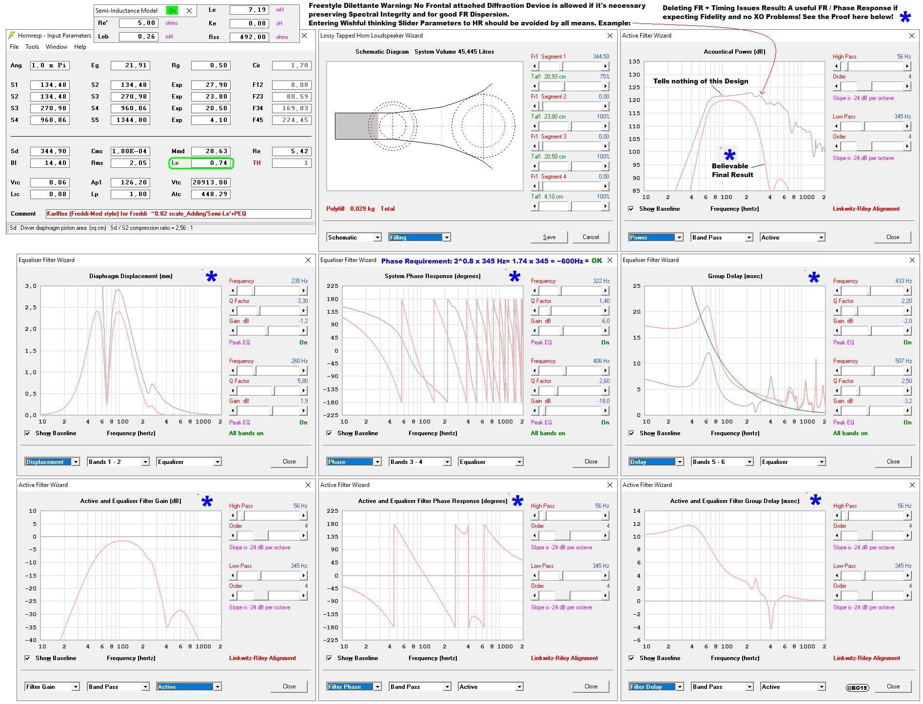

Hi Matthew
If one wants to adjust your model to compare stub and no -stub conditions, would the adjustment look like "A" below ? If not, please elaborate.

MMJ - is it best for users of your Karlflex model to scale proportions from the originally posted example using Kappa 12a wih regards to the front chamber entries? In the sim below it looks like I have about 18 liters front chamber (including ~3.3 for the stub) and a tight 20.4 liters rear chamber.
It seems segments 2 &# comprise the major volume of the front chamber and the stuv (if employed) adds to that volume - correct ?
oh - as usual - forgot to attach the hornresp file. Hopefully the response can be improved a bit and not sacrifice the already meager power handling.
and another with more damping in the stub. 1 pi sim - so near a wall and corner probably. Still some sway-back plus rise arter 200.

MMJ - how might your model work for xrk971's XKi type?
hey MMJ - - lets say we use XRK971's akabak bandpass sim for P-Audio's SN10C coax. His sim says 25.5 liters rear chamber - 8.5 liters front chamber, with ain interconnecting vent of 12" wide by 1" tall by 10" deep.
How might your model be set (assuming it can) to approximate this cabinet?

MMJ, adjust your model to fit this cabinet
Yes , i think that is a great idea Freddi
We basically close off the back of that interchamber duct and then tap into it further forward, that will create our Freddi-Mod stub and a short interchamber duct ..
May need to adjust the cross sectional area of the duct .... We can just start with that Xki drawing and modify it as long as Xrk doesn't mind .. 🙂

Freddi, You nailed it in this next post below ..The red modification on the right gives you the low tuning of the original XKi but with the Freddi-Mod stub to tame some of the harmonic energy that emerges from the end of the duct ....
how might it matter if at all where the tap point is on the red vs blue? I told my builder to go ahead with the regular XKi as sjhown as will need that 12" wide, 1" high by 8" inch tuning duct to get the 25.5 liter rear chamber tuned.
Then the red modification that we see on the left (above) is our higher tuned cabinet (current project).... We are still going with the Delta 10a right? I just want to make sure because you mentioned a couple of other drivers in these recent posts.. ...
Hi Matthew - Yeah Delta10a - if details are worked out quick enough maybe it will get built instead or the XKi
Some adjustment of the stub & duct's length and Cross Sectional Area will need to happen and the cabinet dimensions need to be worked out but we have a solid basic layout to work with now .... Well done Freddi
