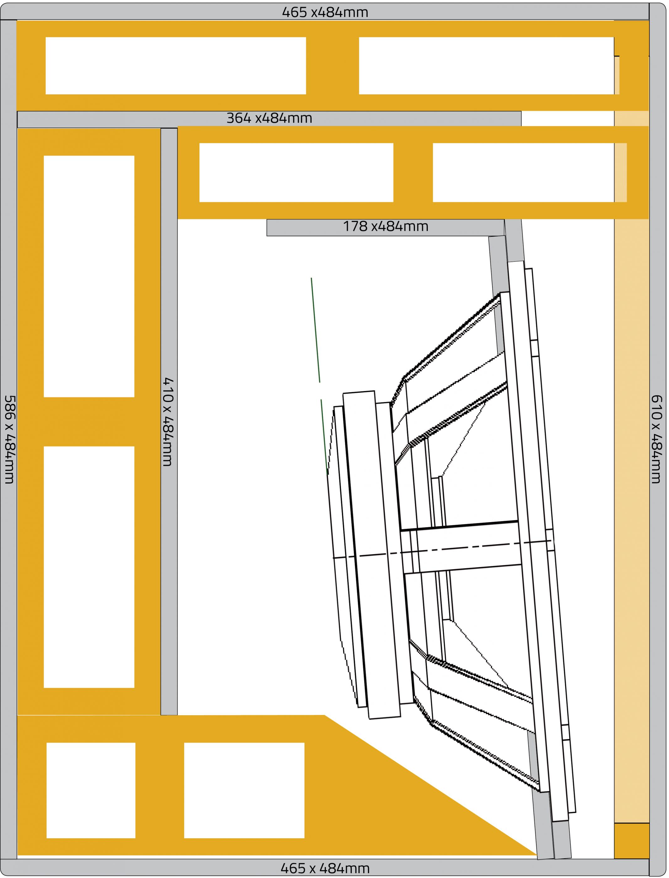

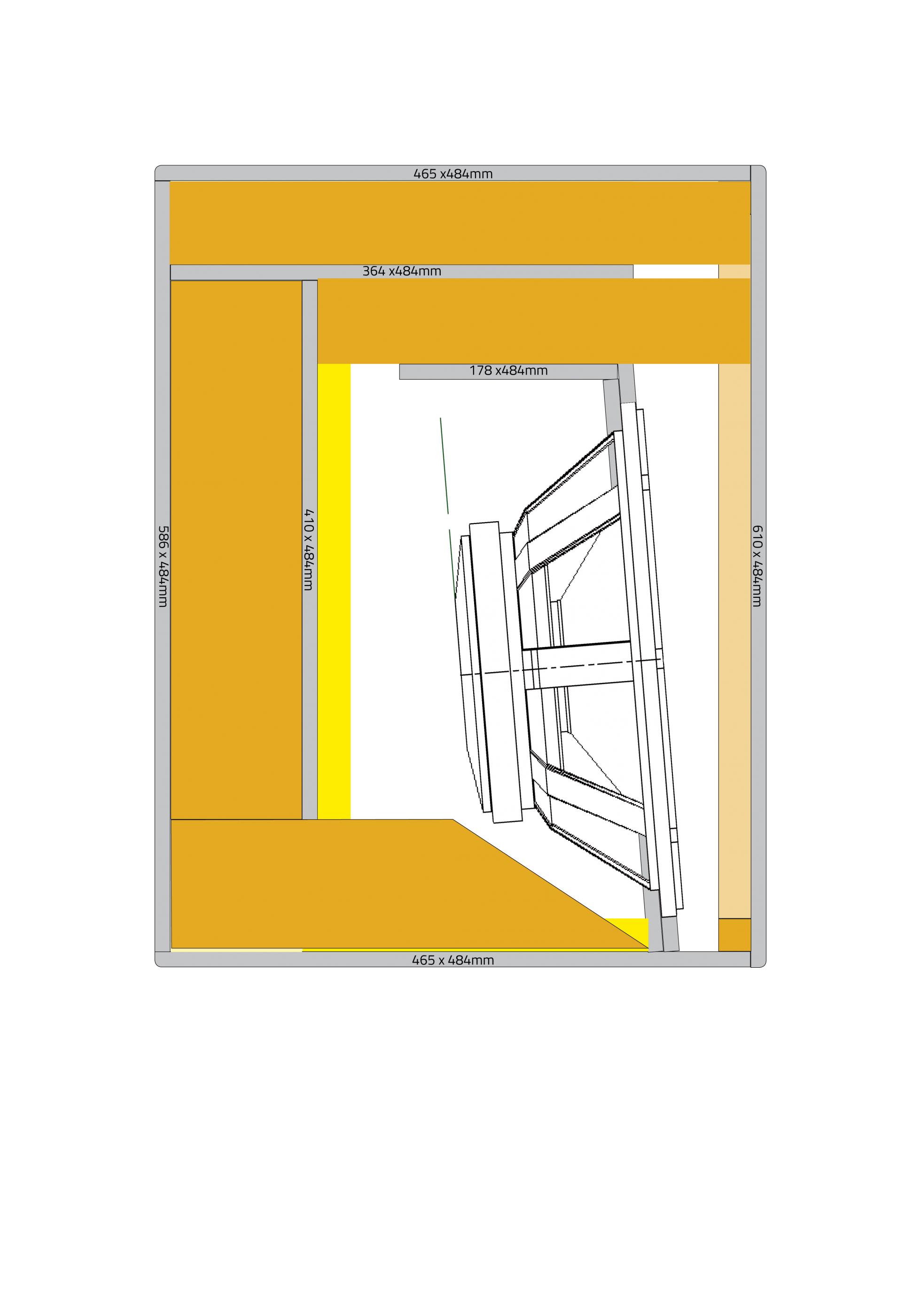

Don't forget to brace the bottom panel...
Also ,the lining must be kept at least 2.5 inches away from the internal end of the duct .... Take a look at the notes i added to your sketch (below) so you can see what i mean 🙂
Being raised a few inches off of the ground should be fine , but if it is on wheels it might try to scoot itself around when the sub is playing at high levels 😛 ... Could be ok on carpet i suppose .... (if you do decide to go with wheels be sure to use some that won't rattle when vibrated)

I really hope that putting the box on 2" wheels wouldn't affect it's FR too much? 😕

Gkh,
If you wanted to round up the internal width to 490mm, that is totally fine, it won't hurt anything at all 🙂
Keep in mind that the bracing in the tuned stubs (located towards the back of the box in the vertical stub, and also at the top of the cab in the horizontally oriented stub) should be solid panel bracing , no holes .... The bracing in these sections are performing double-duty because they act as both solid dividers as well as braces 😀 (highlighted in green in the most current Karlflex plans/sketch) ................................... ..................................We did this because in the wider versions of the cabinet (100L and 120L) the tuned stub sections ended up being nearly square in their dimensions so we needed something to divide that space to help prevent any unwanted resonances from developing there .... Just a precaution really ... ................................... It is something we thought of when Sebastian Schlager built a variation of this cabinet that used a much larger and much more complicated front chamber.... His complex version definitely produced some strange resonances and colourations that we could not damp out as much as we tried ......................... The good news is that nobody has reported any such weirdness with this current version of the Karlflex cabinet......This up-to-date model uses a simple front chamber with the single stuffed Freddi-Mod tuned stub,. while the rear chamber also only has a single stuffed and tuned stub....This combination seems to do well, but i suggest employing the solid divider style braces anyhow just to keep any potential for undesirable resonant weirdness at an absolute minimum .. 🙂
Drawing corrected, bottom brace added...
I wonder with so much bracing, if the internal width shouldn't be a bit larger, let's say 490mm instead of 484mm?
Gkh,

Ikea pillow stuffing is ok? Lining will be 1/2" felt, anyway.
thanks for pointing my nose to it! I thought the Schlager mod is the "mod du jour" 😀
Makes work certainly easier...

And this is what the double board baffle should look like:
Last post's first line should read

Gkh,
We are unable to see the image at your link, perhaps it needs to be made public again? I remember this happened with some of your previous 3D image links ..
I really like your sketch at post #2050 , excellent, well braced 🙂

Gkh,
Let me know what you mean... All angles in the Karlflex are 90 degrees except for the angle of the baffle, and the arc on the "aperture" (front panel , mouth area) ...
BTW, I've not made the angled sides yet. Have to talk to the CNC guys whether they can router them, first.
Gkh,
