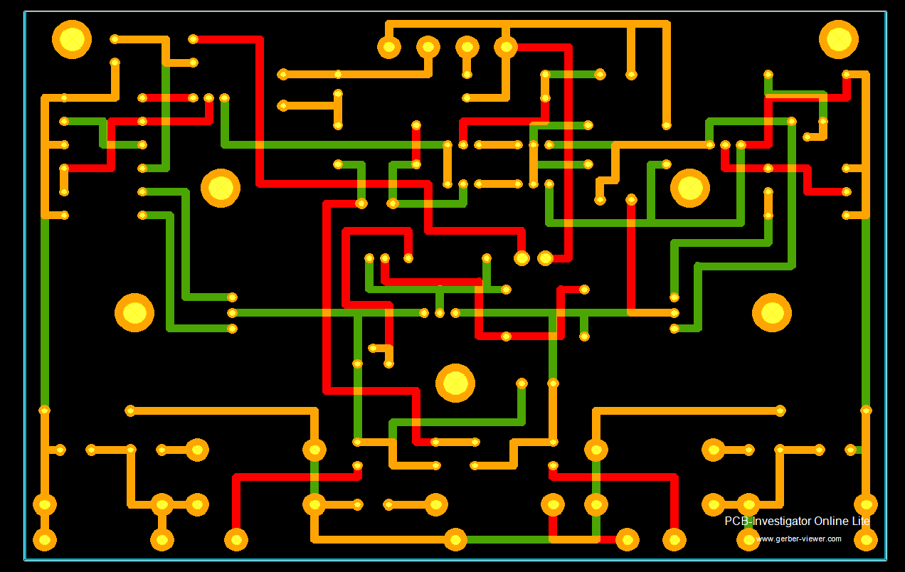

I revised the circuit, making it more simple, and laying out a circuit board
which should be usable for all known versions with minor adaptation.
Attached are various schematics and graphics and also the gerber files
for the circuit board, which was made my pcbway.com, who will ask
what dimensions are, which is 5.5" x 3.5"

I see all top and bottom traces are doubled except cross traces and Q6, Q7 maybe for safety reasons if mask expose for some reason or damaged.
Mr. Pass what are benefits of doubling top and bottom traces?
Doubling trace thickness with just 1 oz copper?
P.S.: My OCD tells me there are missing top traces from +C to R23 and from C9 to V+ ... 😀
are they doubled??
Yes. Orange traces in the picture.
Mr Pass has built and tested it all OK so there are no traces missing on the pcb.
I think you did not understand what I meant..
I still don't understand what you are trying to say - you need to be clearer.
On the picture from post #32 you can see traces from gerber file Nelson share.
Red color traces are top copper layer.
Green color traces are bottom copper layer.
Orange color are places where top and bottom copper layers match same route.
That means those fully orange traces are doubled from top and bottom.
Board obviously would would work without any doubled trace.
But there could be some interesting trick from Nelson I don't understand reason right now.
There are some logic.
Exception of traces that are double are the ones that cross both top and bottom layers, the ones that go to Q6, Q7 and the one I wrote "missing".
They could be doulbled too but they don't maybe for a reson maybe not.
May be trick have something to do with current go the path of least impedance or maybe it is overanalysis.. 🙄
