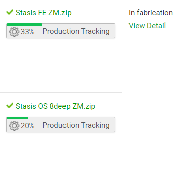

So, where are the new gerbers ? 😀

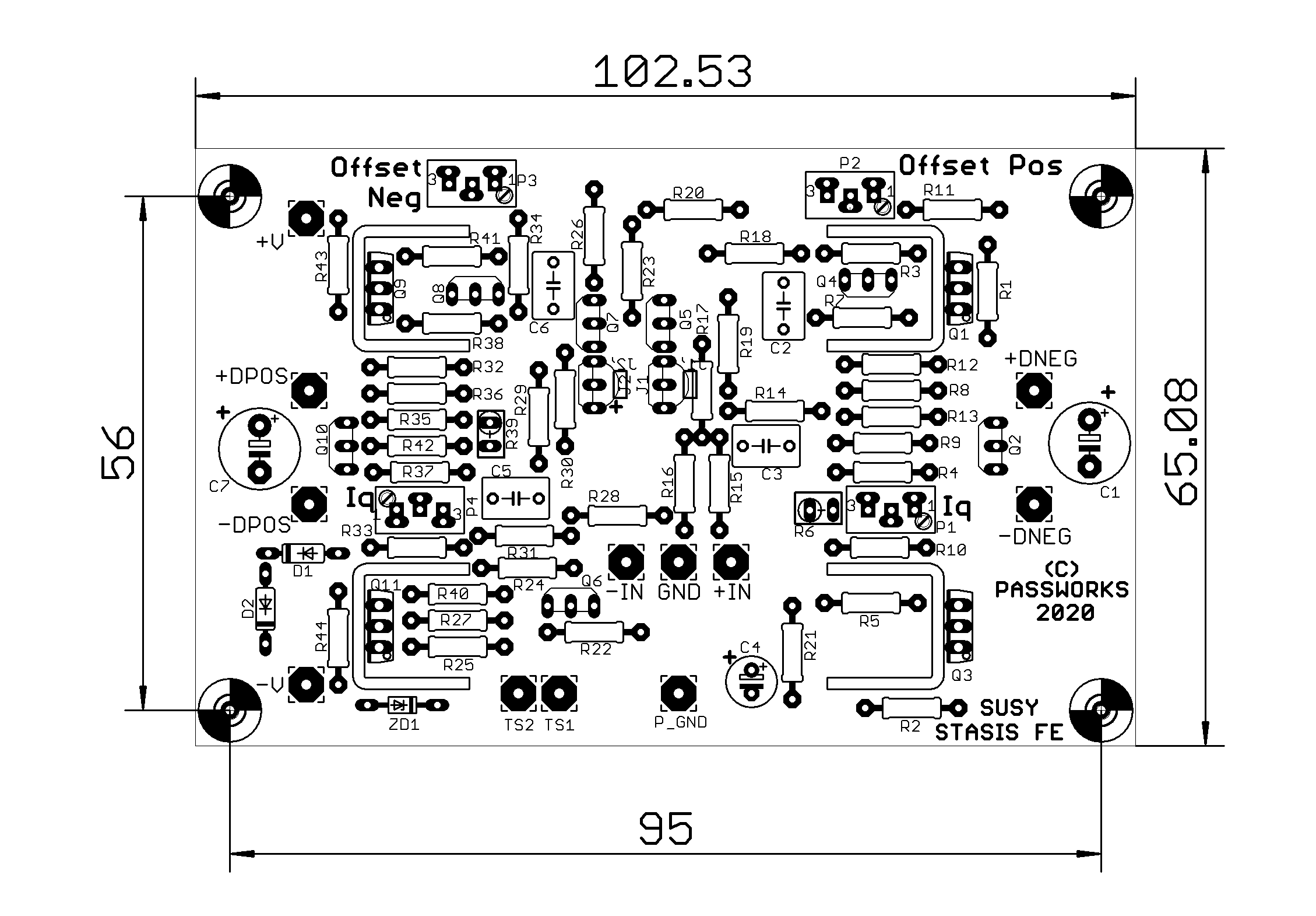

Sorry for the dumb question but what is the "SUSY" variation? I missed the cliff notes or was asleep during that class...

Source : http://www.firstwatt.com/pdf/art_susy.pdfSorry for the dumb question but what is the "SUSY" variation?

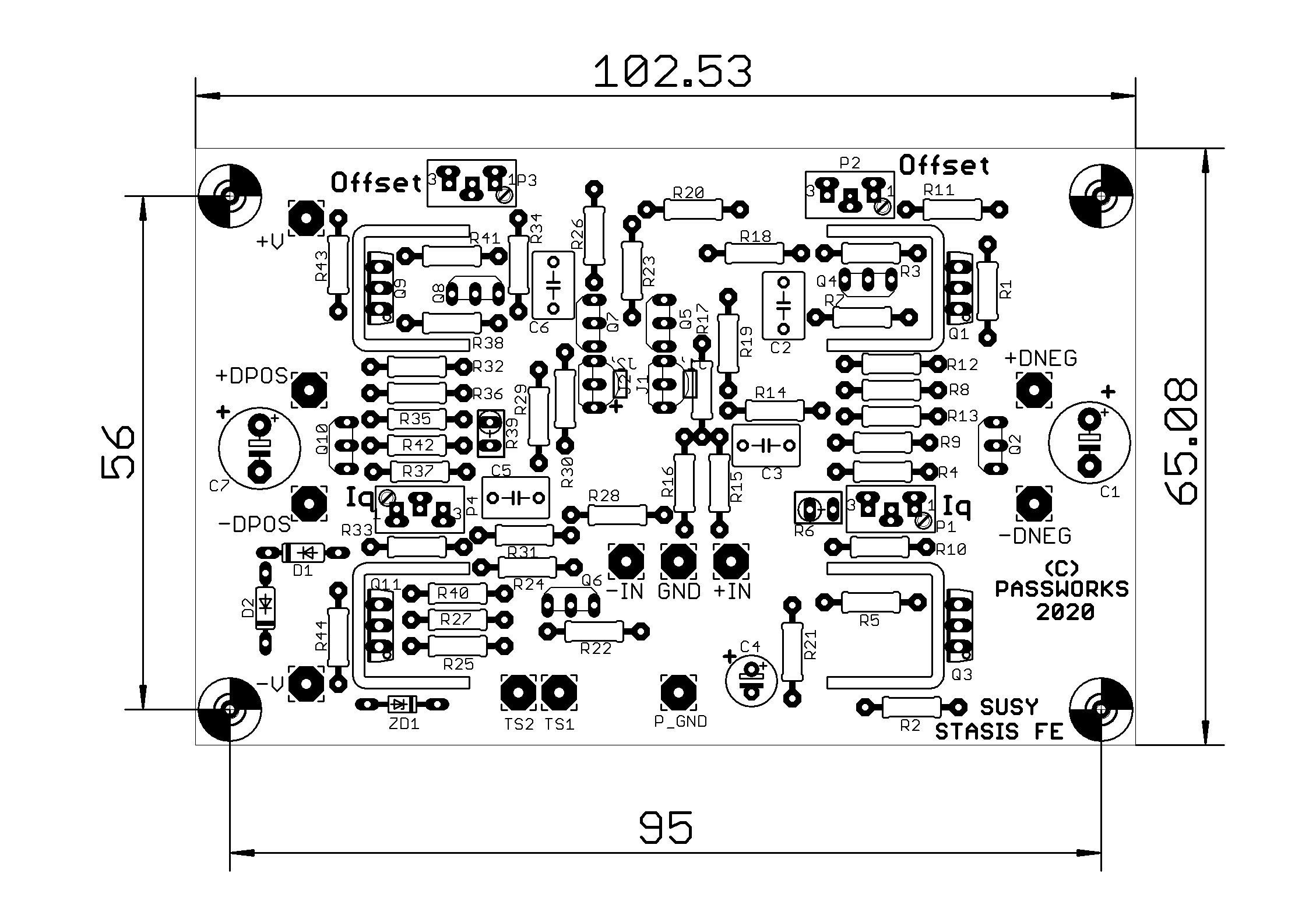

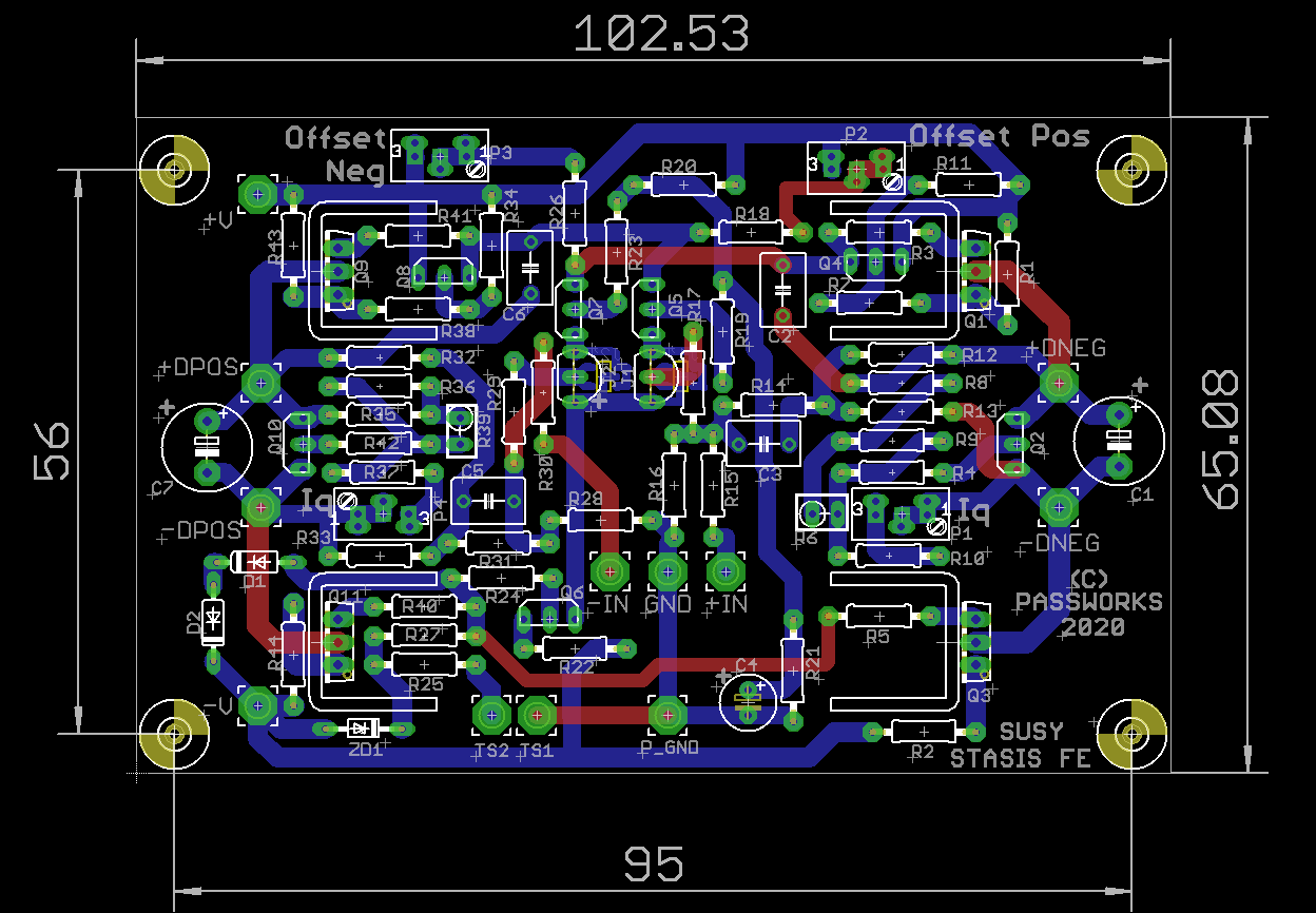

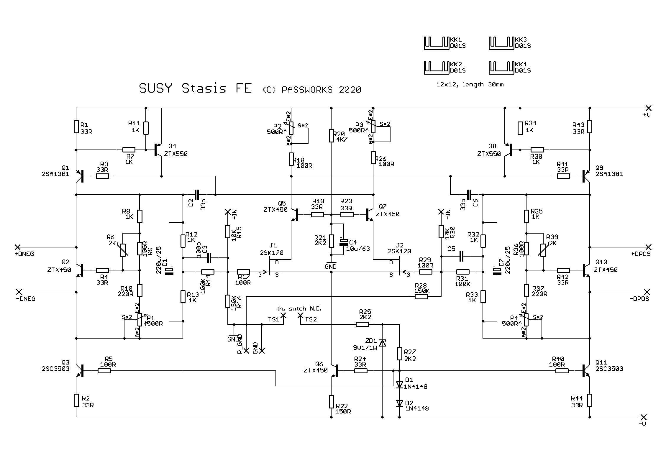

SUSY Stasis FE
see graphical files
enclosed zip - all of those, plus Gerber files in separate folder
Disclaimer: If you're entering here without Elven Steel............
I didn't tried it, nor I will, but I'm pretty confident that it'll work
matter of offset stability, both absolute and relative (ignore a fact that I simply can't remember which one is which) - main thing needed checking in vivo
McMillan resistors, simple servo, complicated servo ....... we'll see ......
pcbs are cheap...... fun is priceless 🙂
note: zero Babelfishing....... Papa's FE from post #1 augmented to SUSY iteration
see graphical files
