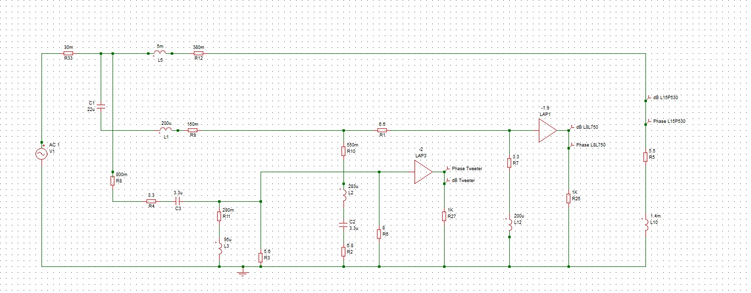

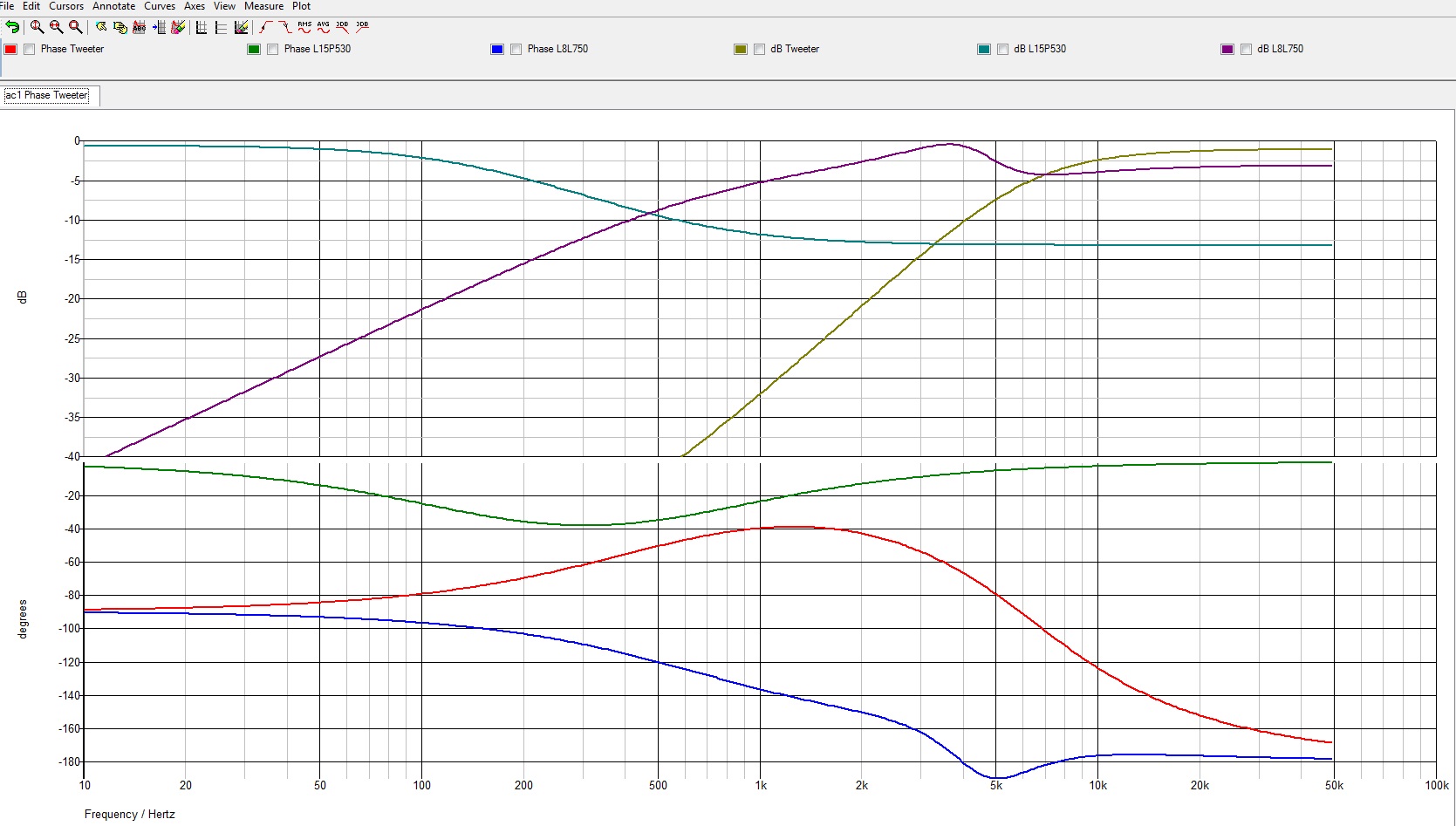

now that i start to reverse engineer the passive lcr x over, it is only first order between 15 an 8 inch.
First order does not have good phase - hi and lo have 90 degree shift. I could improve that by introducing 2nd order passive filter, also the steepness would be improved. I would expect the 8inch to profit from more damping against the low frequencies below its enclosures tuning. at least displacement wise. i have good LCR calculation and simulation skills, but I lack an acoustic measurement system to verify the changes. What is your opinion? Leave as is or try to improve to 2nd order?

i d like more punch from the low side, but at the same time want good or better lf rejection for The midrange. so cannot just push the 100 200 hz by the dcx input without affecting the midrange tweeter excursion too. maybe a 4 ohm 15 inch woofer would do i e give 3 db more output at this range keeping the power for the other components the same.
i think the way the xover works now is only 1st order lowpass at 300 hz, but letting the 15 inch start to beam 300 400 500 600 hz so make up for the loss this way at least on axis and blend somehow with the mid at around 500 - 600. that is my current theory how they fit these strange values into the filter. also, why is there a rlc for the midrange sucking at above 5000hz? additionally i want to go from 1st to sec order but issue is the phase at the xover between 15 inch and 8 inch. no any idea how to optimize without measurement resources. next is to get rid of at least part of that heat burning resistor power esp for the midrange this is pure awesome waste.
any ideas would help.... thanks

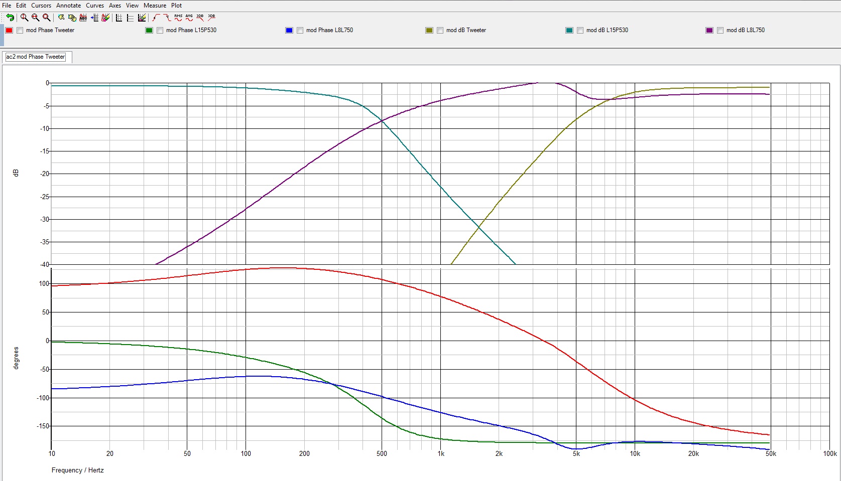

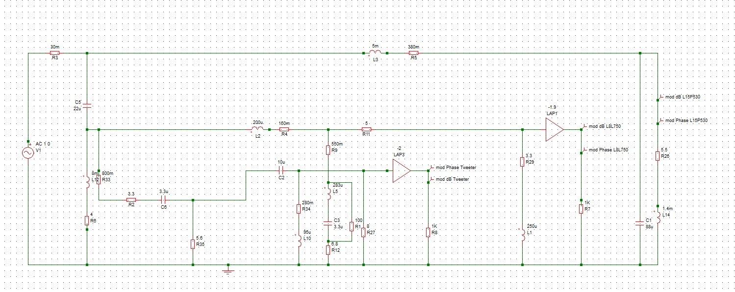

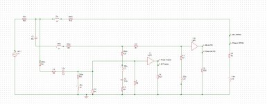

So after reverse engineering the circuit plus working on optimization here is my current state, schematics plus sims.
The triangle amplifiers is just to simulate the phase inversion (minus) plus the difference in acoustical efficiency (double for the mid and tweeter)
Improvements: Midrange now has much better attenuation at below 250Hz.
Tweeter now has much better attenuation at below 2.5kHz.
...the added coil is air coil 4 Ohms 7 - 8 mH, about 340 turns on a beer bottle. AWG 22.
The only thing open is the phase 15" <-> 8 inch at the crossover. I want more out of the 15 inch at 150~200Hz, the 88uF will do this, but the phase is so much changed at the crossover to the mid. so not sure if this is good / better or worse? if not I can still skip the capacitor and boost 100 - 200Hz actively at the DSP signal stage, but then the midrange 8" would also be affected, effectively canceling the improved attenuation it got by the improved circuit. any ideas?
screenshots in next post.
