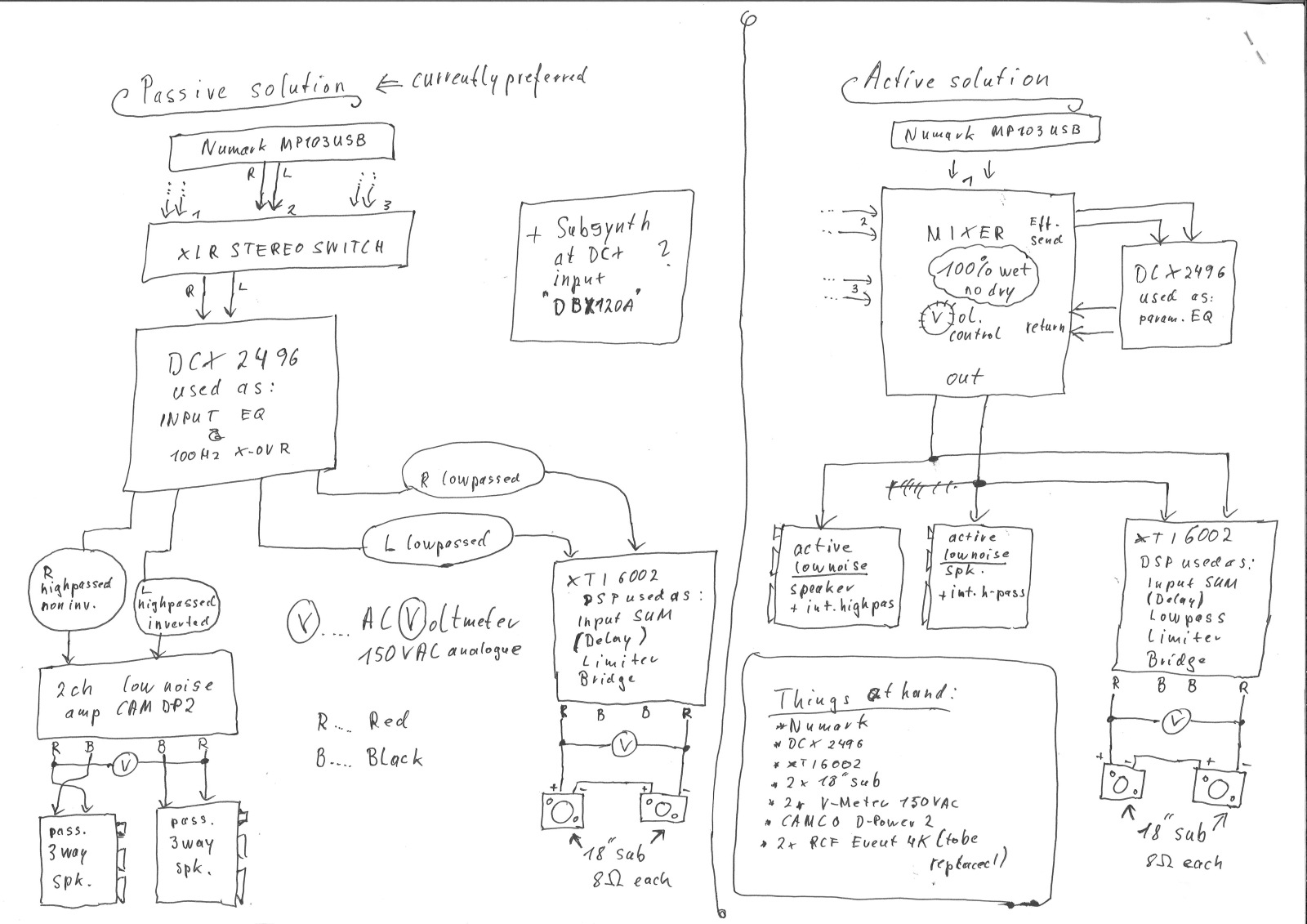

Here is a hand written diagram of my ideas - hopefully you can read this.
Passive solution would use attenuators. Active would use mixer vol control.
Another option I am thinking of these days is: Go the passive solution but replace only the old beaten-up 15"s in both RCFs by a better new woofer (similar T/S plus much higher power rating). Maybe up the power amp a bit (like D-Power 3 or the like) and push the 15"s way harder through gentle EQ boost at 100 - 300Hz. That solution would be WAY below 5000 EUROS but depends on the lifetime of the old 8"s and the tweeters (do those speakers tend to wear out too over the years?). anyway those could be replaced later on too - would not be so expensive.

There is no problem - just high expectations: Since it is a home discotheque, I want to be able to listen at "room levels" without hiss, even at "sleep" levels,
Fair enough, and understanding your application does actually explain a lot.
So you are effectively running a home stereo type set-up that can also be used as a Disco (or probably more accurately, a Disco that you wish to use as home stereo).
So while In a traditional PA/Sound reinforcement application, any minor noise levels these speakers have, would usually be well and truly buried in the venue/background noise, even just half a room full of people breathing, I can see your application is slightly more sensitive in this regard.
It is probably worth mentioning here, that many modern D class type amplifiers tend to be slightly noisy inherently, so if you are happy with your Camco I would not rush to replace it.
Compression drivers (the tweeters in most PA boxes) do start to distort when driven harder (although being horn loaded, in theory they should not NEED to be pushed as hard) and I wonder if this could be the cause of some of your concern about the sound of your current set-up.
Even if not being pushed too hard, the tighter pattern control of a horn loaded compression driver may make it unsuitable for a home stereo type application as at the very least you will probably find that your top end changes as you move your head (an effect common on "less expensive" fold-back wedges, which I personally find annoying, but which many other folk do not notice) .
Most "Punch" is usually considered to be 50-100Hz which would be from your Sub-woofer, (although some of it can be up to 150Hz or so), once you approach 200-300Hz this is usually described as warmth (or mud, if you have too much)
Looking at your diagram you have the two 18" Subs in series giving a 16 ohm load to the amplifier, while I note that the XTI6002 is rated down to 4 ohms in bridged mode. running the subs in parallel will effectively give you another 6dB on your bottom end.
Then think about your sub location, one of the biggest mistakes with Sub-woofers in PA usage is to run stereo Subs (that is one sub-woofer each side of the stage), at best this results in uneven bottom end across the room.
Ideally as a simple rule of thumb is locate both Subs together in one corner of a room (or at least tight into a wall) and see how that goes.
Of course this could just be a semantics thing, and what you call "punch" is what I call "warmth".

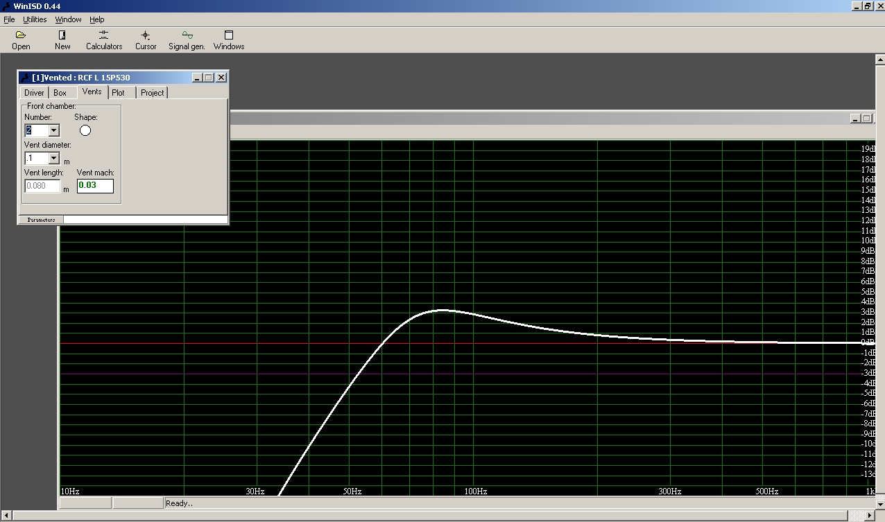

From today's investigation (opening the speakers) I have found out the following:
The LF speaker of RCF Event 4000 is L15P530. It has about 93liter net volume to operate into plus 2 round ports, each 10cm in diameter and 8 cm long (effective length would be like 10 cm or so). Any RCF expert here to confirm that?
RCF states the tuning frequ. = 45Hz. Need to start the simulator to see if that fits.

with an RCF L15P530 with a 93 litre cabinet and two ports 10cm dia 8cm deep WinISD gives me a tuning frequency of 67Hz and an expected frequency response of:

the rcf 15 speaker plus the 93liters plus ports as described has about 47hz reso according to basscad what i use. the datasheet of rcf speaker shows impedance minimum at around 45hz. so you might have some parameter wrong. anyway i am not going to change much with thiele small just replace the same speaker by a new one or by a different one with similar thiele small paras. any suggestion of a good 15 inch speaker?

so now i got into more troubles.
1.the xti6002 during startup will pass about .5secs of audio completely unattenuated and un-dsp'd before booting into the current setup which causes me to change the startup process to have the amp fully ON and booted into the dsp program running and attenuated before i can startup the mp3 player or the dcx coz otherwise i risk killing my 18s with unfiltered unattenuated maximum signal.
2. i ve spent bout 8 hours setting the right delay to match the xover phase between subs and rcfs. now i ve "good" phase between bout 75 hz and 175hz. i do this by placing a spl meter between subs and rcfs and using a sine generator find the delay that gives best cancellation then adding or cutting half a wave period for the setting -depend son what setting gives best overall result over the range of bout .7 - 1.5 x fxover.
to not in any case hurt this perfect setting, i cannot use the amp's dsp's internal subsynth to fatten the bass, since i then risk that the perfect crossover phase gets hurt by subsynth's harmonics. so i d have 2 buy dbx120a for use be4 the xovr that no phase imbalance can occur. the xti subsynth if enabled will place an additional lowpass into the dry signal chain as well. not good for the phase match. i raised that to crowns technical field engineering they said well thats life. i really would need that subsynth to only affect the sub 60 hz area otherwise i cannot use it.
So turn on problem solved by 4 speaker switches between amp and speaker,
