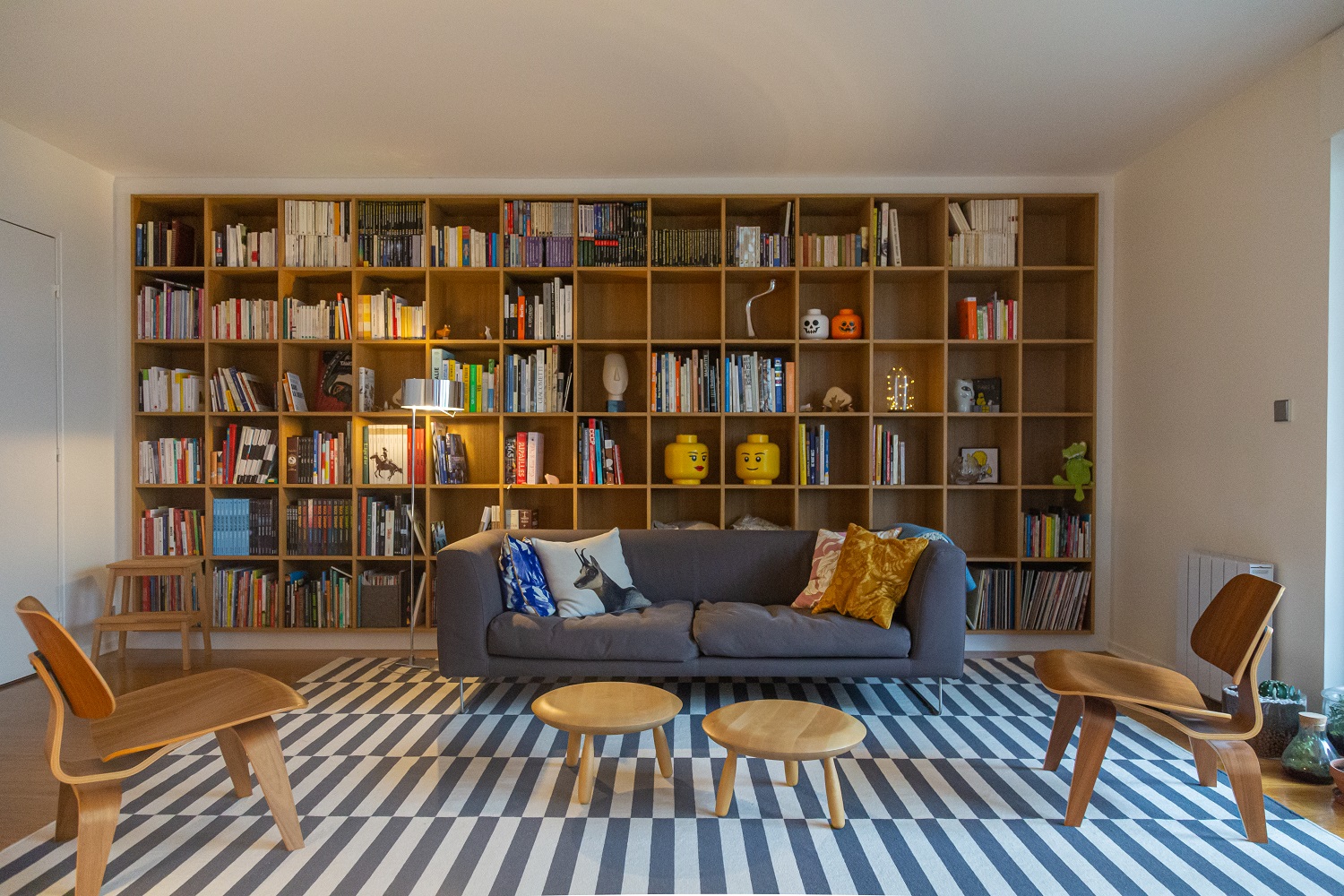

I see I need to make a few points clearer:
- KEF R7 is just what I would buy if I did not build anything. I haven't heard them in the room. I believe they would sound spectacular, but it's 3000 euros.
- amps are ncore nc400, so I don't think I need more or better.
- dac is a kardas tone board, again, I don't think better is needed.
- I also have a minidsp SHD which I am not using yet to its full potential. I specifically bought this for active crossover, EQ and dirac. The aim is to correct as much as possible the imperfect room I have to contend with. Its still in its box.
Main problems are WIRES: room has two doors on one side and three full size windows opening on the other side, which gives me only one real good practical speakers position : the end of the room. Unless someone has an idea to hide hose sized speaker cables from running across the door?
This is the listening position.Wee needs photos to understand more
Have I my 80 ???? 😀
someone sitting in this couch would be 6m away from the speakers. My current speakers are actually on the opposite, 1m from the back wall and 1m from the side walls.
I mentioned Onken because they appeal my aestehiscism, and they seem "easy" to build. Not out of some audiophile fetishism.
I have been looking at Joseph Crowne plans for instance, they look great.

ah just seen the photograph : ok, it's clearer now about the back wall and the sofa !
Troels Gravsen made something than can save your life here, I still think the sound could come from the back wall : Bookshelf-3WC ; not a too much complex wood working too if helped in the local participatif shop (if you have an adress I'm interested too)
