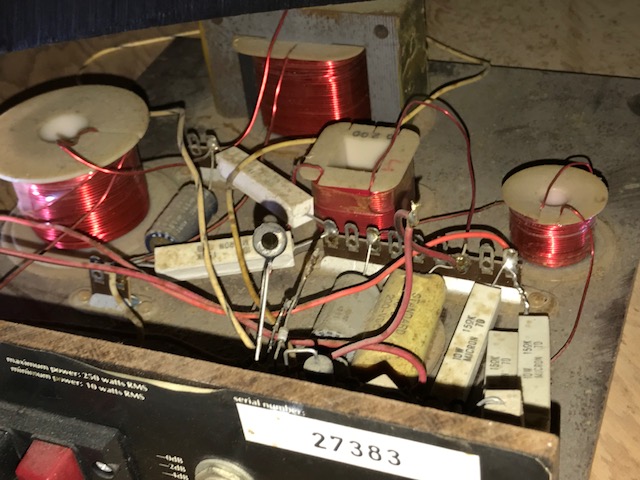

“New” Speakerlab K’s. Need to id crossover

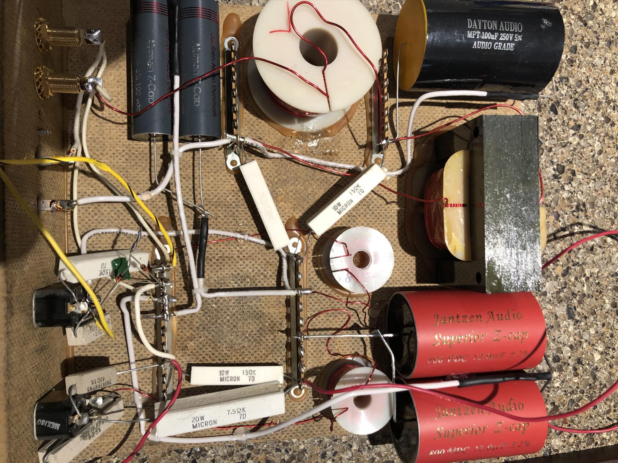

I hand measured all those Capacitors coils and resistors and that schematic and I know that that they’re accurate.I’ve also done the calculations on how they control the band pass for the mid range and the 12 Db octave second order Crossover for the Tweeter. The woofer crosses at 500 Hz in the tweeter cross is at 5000.
These crossovers are specifically tuned for speaker labs woofer and for their mid range and Tweeter. They are for the. Time They came out very sophisticated crossovers the reason I chose the capacitors that I did It’s because they’re very neutral and they are extremely good caps. They are recommended by humble home hi-fi in their Rating chart there’s very good information about them. The Jantzen superior Z Caps are wonderful and very open for the midrange, the Jantzen alumen z caps are amazing for the tweeter and not to bright. I did a lot of research on capacitors before I bought these I also tried a lot of different brands and these were the best that I found for my k’s.
Wow mech! The news i was hoping for - you did my homework for me. Yes, someone will chime in and say everyone hears/wants different things, so one person’s preferences doesn’t mean everyone will like it too, but you’ve given me a starting point. Not to mention, I’ve been doing some research and based on that, i think you made good choices and will now duplicate your choices. We have the exact same speakers, so it seems a good idea.
Hopefully my last question; where did you buy them from? Parts express doesn’t seem to have jantzens Z’s.
