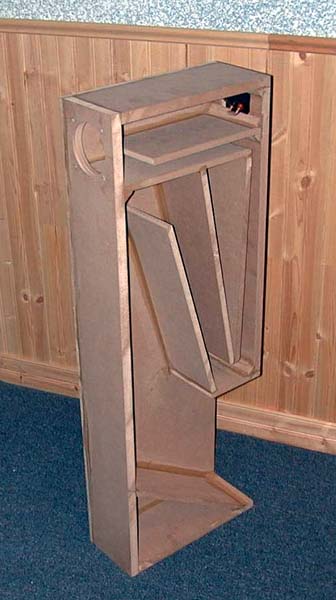

I'm using the Hawthorne Silver Iris Coax in the cab pictured below. Before all the naysayers jump all over me with "that's not a horn" or whatever. With just the U-baffle top I was already getting good response down into the 30's. FYI, I use no EQ, I prefer to address things mechanically instead of electrically. Although I can't locate my SPL meter, a tone sweep shows a gradual rise in response of 3-4db at my listening position from 28hz to 300hz with no noteable peaks and valleys in between. Even if it was 6-8db it would still be unheard of with OB and my ears are well trained enough to know the difference between 3 and 6db even over a 3.5 octave frequency spread. It may be closer to flat, because to me, any more bass would make it bottom heavy. Note that my results are with corner loading because out in the room the bottom end has some peaks and valleys in response. Also note that I can apply more power with the "horn" base than with just the U-baffle before the cone loses control, which leads me to believe that I'm getting some horn loading. There isn't a lot of output at the mouth, but I really wasn't looking for much, just to fill in the very bottom that was missing with just the U-Baffle.
I took my idea from Steve Deckert's Sub Only Jensen Imperial, whick also has an open air throat loaded via some type of helmholtz resonation. My reason for posting is to solicit help in optimizing the design. This was just with my initial test cabs. I don't fully understand how it works, but it seems too short to be a TL since it's filling in only in the the 28hz to 45hz range. It's not just a resonator because if I plug the mouth it turns into a real one note resonator, big and flabby.
Any suggestions would be greatly appreciated, because I want to try something similar with a Visaton B200 and I'll need more bandwidth and more efficiency in the horn, since the smaller driver won't be pushing as much air across the slot.
Here's a drawing fairly close to scale:
Interesting design. Have you tried plugging the back of the pentangle? Or plugging the back of the pentangle and putting in an aperiodic vent or two? Or put an aperiodic vent in the mouth? Or a combination of the 2 ? That might be a way to tune to the specific frequencies you want to accentuate. Just some first blush thoughts.
Any resistance I add in the back is going to attenuate the HF of the rear wave and detract from the wide open OB sound. Closing it up would likely sound terrible because the driver has a Qts of .91 and would require a much large box than the 1.5 or so cuft back there.
First and foremost I want to retain OB and I know how to stretch that limit with specially shaped U-Baffles. Until the wave escapes the confines of the baffle it is still a pressure wave, so I have some pressure to work with. In addition, I've got Helmholtz principles loading that slot, which I can tune with slot size.

Corloc,
At first I was worried that I was only getting a resonator effect, like blowing across a bottle. That's exactly what happens if I close off the mouth, an ugly very pronounced one noter. With the mouth open it behaves very different.
With just my U-baffles, I was already getting great bass extension for an OB, but I wanted to totally eliminate the need for a sub with music. I suspect that I'm getting a combination of effects. First, that I'm shunting off a portion of the LF content in the rear wave with a frequency range based on the dimensions of the slot and air volume beyond it (like a helmholtz absorber). Instead of being dissipated in a sealed chamber with damping, it travels an expanding pathway of approx 1.8m , plus with the exit at the rear for dipole cancellation purposes that portion of the rear wave must travel a total extra distance of 2.2m. That equates to an Fequal of 26hz. Second, I believe the expanding pathway is having at least some effect on the waves that enter it.
For a smaller driver, some type of double baffle is exactly what I was thinking. I at least had some help via Helmholtz formulae to determine a slot that seems to work as intended, however, a double baffle has the potential of redirecting a major portion of the LF content. That's where I'm left with kind of a blank stare, because I'm not much for trial and error. Sure I try stuff that's out on the fringes, but I have very specific reasons for every part of a design.
I'd want to come up with some idea for an optimal size and shape for the driver cutout on this secondary baffle. The idea would be able to determine a mechanical XO frequency. Frequencies above that pass rearward unfettered, and below at an increasing slope they are sent where we want. I can make the spacing adjustable, so that variable is covered, but I'd like an educated guess on a starting point for the false baffle.

I don't think I'm dealing with pipe resonances. Yes, I did have to shape the terminus of my U-baffle in a way to eliminate them without using stuffing because the 1st order low pass on the woofer is at 3500hz, so that was my primary concern with the U-baffle. With the "horn" the frequencies are too low and pipe resonances are pretty obvious when they occur unwanted.

I appreciate the input and when I closed the mouth up, I can't say definitively whether the result was a 1/4 wave resonance and/or a helmholtz resonator because either or both could have been applicable in the 40-50hz range where it occurred. I believe the wavelengths of the frequencies involved (50hz and below) are too long for 1/2 wave resonances, however that may need to be taken into account once I start trying to load a wider bandwidth with a smaller driver.
I forgot to say that i think it is a very nice and original idea adding horns or resonators or any means of lets say mechanical bass amplification to a openbaffle. In the near field there is indeed bass to be amplified.
Something else I've tried, but haven't gotten it to work yet is to absorb only LF content of the rear wave. The perforated helmholtz absorber didn't absorb much at all, but I still want to try a slot absorber. Using that approach we should be able to offset some of the dipole bass cancellation and effectively increase bass response that way.

I couldn't agree more on the chamber vs OB. I've taken the U-baffle to it's limit with the driver I have and the current slot doesn't seem to take away from the OB characteristics. My drawing on the left above obviously would, but at some point a large hole with less depth wouldn't and I'm trying to figure out how to reasonably estimate that point.
My current thought process is to use the driver's natural polar response to capture a significant percentage of only the LF waves and channel that to the throat.
On my current version the mouth is only about 600 sqcm, so I butted it up against the corner of a heavy wood box to effectively expand the mouth and smooth the wave flow out of the corner (ala Ron's horn mouth deflectors) and that works very well.
