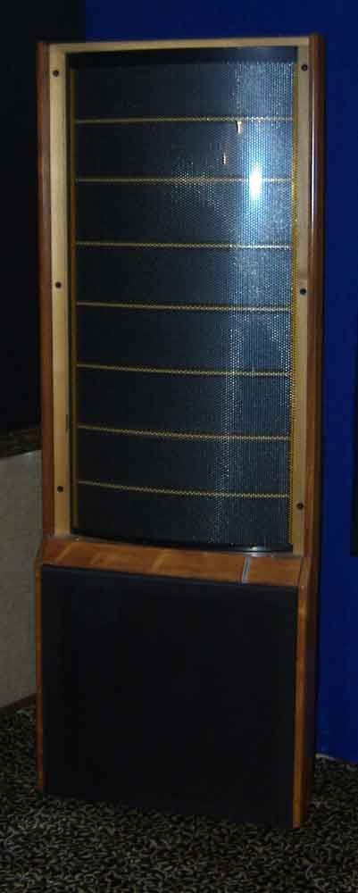

Nice room size, you need some nice speakers to fill that ceiling height. Ideally a clone of the grande utopia..... but what you really should do for the best high and mid range is clone yourself some martin logan electrostats. Monolith is a great speaker you can do, the drivers: 1 electrostatic panel & 12" sub wont cost you much and all in all it is THE best performance for your $$$ you can get.

Also I am not wanting to build a pair of electrostats at the moment (as I have no idea, how to build them).
