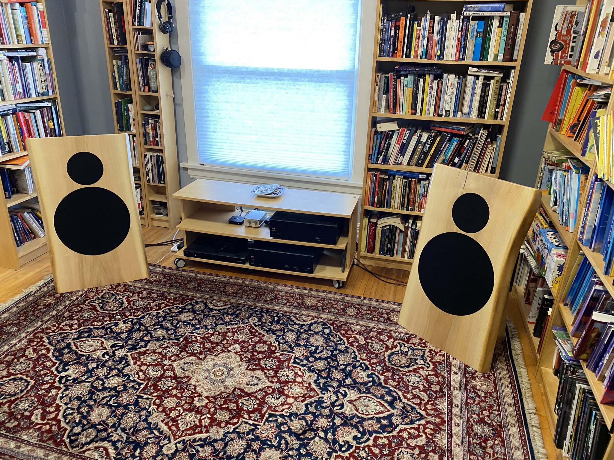

In the Single-Woofer Dipole Reflex Hybrid, the constraint was:
“You only get ONE 10” woofer. You don’t get a 2nd 10” woofer. You don’t get any LF crossovers or passive radiators either. I want it to have that 3 dimensional warm ambient Open Baffle sound, but you also have to force it to deliver actual bass from a small box.”
This was the result.
It doesn’t have extra subwoofers or crossovers. Why? Because that would violate the constraint. It wouldn’t be elegant. Throwing drivers and technology and crossover points at problems is not disciplined thinking. It also gives you lousy aesthetics. It has low WAF. A speaker made out of gorgeous white oak is a lot less gorgeous after you install extra woofers.
Throwing technology at problems allows us to be lazy and not think very hard.
This forced me to think.
I was happy about that because it inspired me to invent (or re-invent) something that very few people have ever seen before.
EVERY speaker design is a compromise. You all know that.
In this exploration I discovered: One of the compromises of a single-woofer Dipole Reflex Hybrid is: You DO get the best of both worlds (Open Baffle + Reflex), but you also get cone rocking and high IM distortion at high SPL’s. The distortion curve goes out of control faster in this design than in a standard ported box.
OK. So it’s another version of trading distortion for efficiency and bandwidth. Which is another one of the many “Hoffman’s iron law” triads that we encounter in speaker design.

So, one design that I think would be elegant would be a 15” coax in a Dipole Reflex Hybrid. It would look a lot like these
https://psma-website-assets.s3.amazonaws.com/live_edge_beryllium_dipoles.pdf
..but minus the tweeter, just one driver on the front; the driver would be moved to the upper half of the baffle. It would have a back panel below the halfway point of the woofer. 40-50 liters.
I’m pretty sure I could get the tuning frequency down to around 40-45.
Since a 15” woofer has a surface area of 880 cm^3 and I’m using half the surface area to drive the ported box, that means I’ve got 440 cm^3 of Sd (equal to an 11 inch woofer in a bass reflex) so I can get 100dB SPL with only a few mm of cone excursion.
And it would be a very beautiful design. With high WAF. And the gorgeous ambience of Open Baffle, all at the same time.
And relatively simple and won’t require a 17dB bass boost at 40Hz to sound right.
Very tempting to build them, using B&C 15CXN88 or the BMS drivers that @airvoid mentioned, or the Faital 15HX500.
Or maybe someone on this forum would enjoy tackling it.
