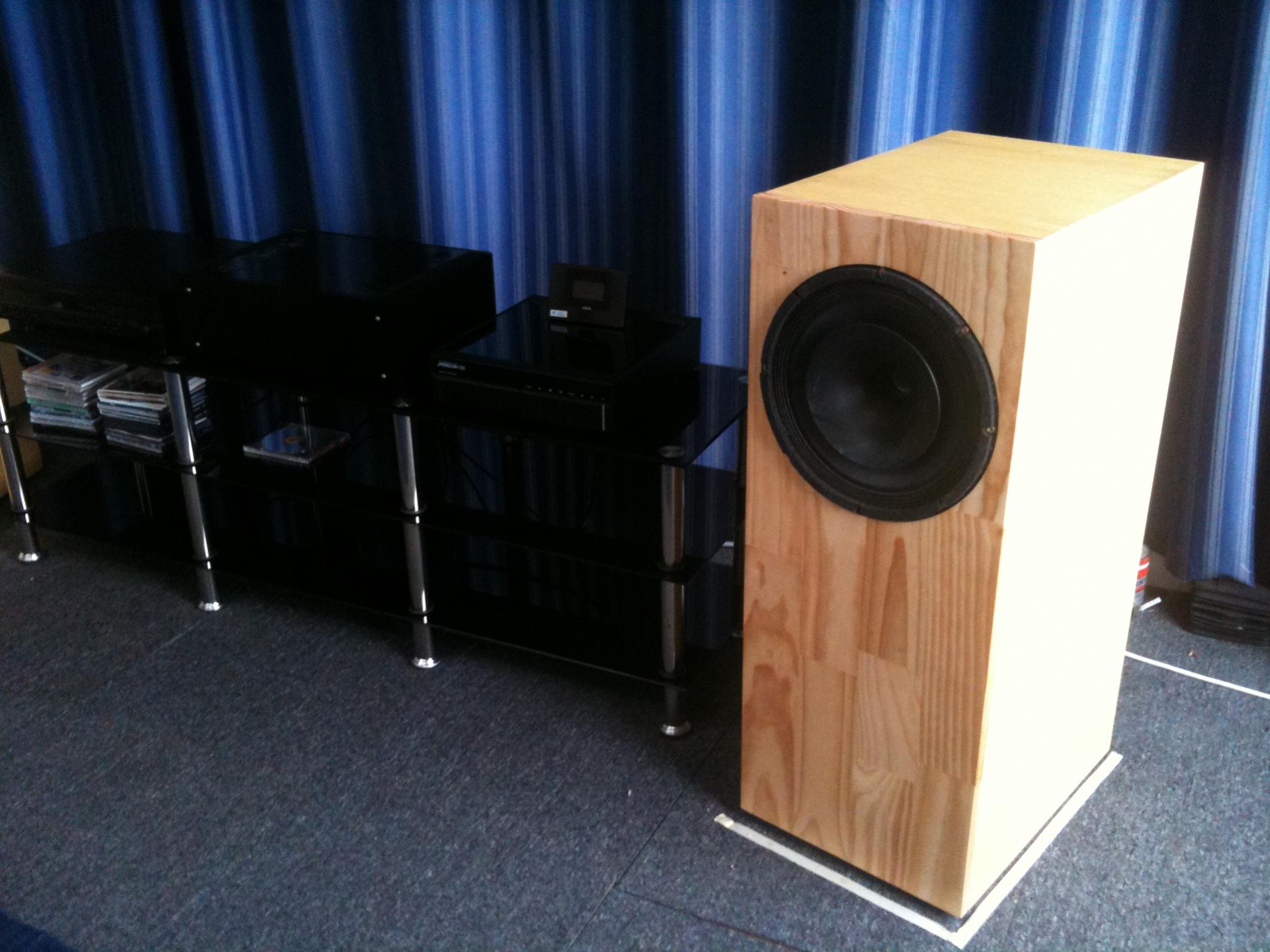

heres some more speaks i just wipped up using the same drivers
130 litres br tuned to 43hz 6mm marine ply cases lined with lead and matrix bracing baffles are 18mm finger pine
I,m currently listening to a hiraga lemonstre clone so thought i may as well have some hiraga style speaks as well
Cheers Sheafer
