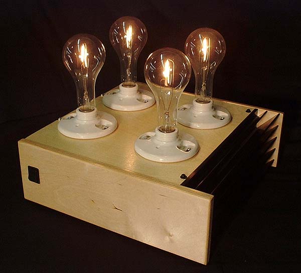

Very nice. Having built a range of Nelson's offerings I have to say I still have a soft spot for the SoZ.
Only comments I would make are:
1 (seriously) if you do it again mount the fins of the rear HS vertically. The SoZ is a bloody furnace and you want all the help you can get!
2 (completely tongue in cheek) as a medico I can share with you that the retina actually has less blue cones than any other (this bit is actually true!). this means we are less sensitive to blue and this diminished sensory input lowers the competition in our brains allowing greater appreciation of other sensory modalities. this is undoubtedly the reasoning behind the oft quoted sonic superiority of the blue LED ............................. and I'm even sober at the moment

Talking about LEDs & Light
ZEN-lightenment - by Nelson Pass
A REMARKABLE solution to the
"finding power-resitors that can take the heat" problem.
Only a person of some genious creativity
can come up with ideas of this kind! 🙂 🙂
And most surprising - it works

moe29 said:
back to Carlo's wonderful looking amp! Where are
the 1 ohm resistors tucked away? i still can't locate them!
later,
m.
M.,
the 1 Ohm resistors are located in the rear heatsink, just below the mosfets. This heatsink
is quite heavy (about 5 kg). I tried to balance
the thermal load on the heatsinks by mounting separately the 8 ohm resistors and mosfets+1 ohm resistors.
I wish to thank you everybody for the feedback
(and for the led jokes too...)
Carlo

ZEN Lite
Maybe this is not the right place to post this, but...
A friend of mine built a ZEN Lite with old car (I mean not halogen) bulbs. He uses them in parallel. The advantage is they are much smaller than the ones I've seen so far used for this project.
