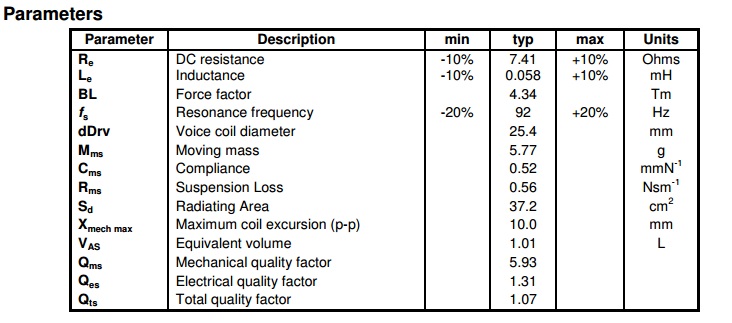

I installed SE V19 recently. My first exercise is to input TS parameter of a driver, TEBM65C20F-8. This BMR driver is available from PartsExpress.

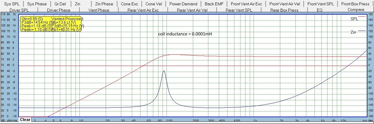

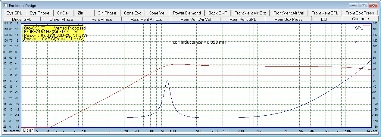

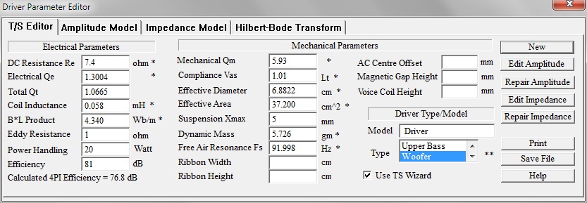

A sealed box of volume 20 l is chosen in Enclosure Design Control. Sys SPL (include Le), Zin are shown in the figure below. Zin does not seem right. It goes up to high. I change the Coil Inductance in Driver Parameter Editor. It will affect Sys SPL, but not Zin. For example, coil inductance set to 0.0001 mH, Sys SPL is nearly flat in high freq., but Zin remains the same.
Any idea?
Thank you!
