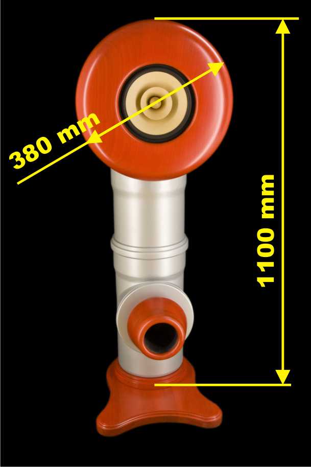

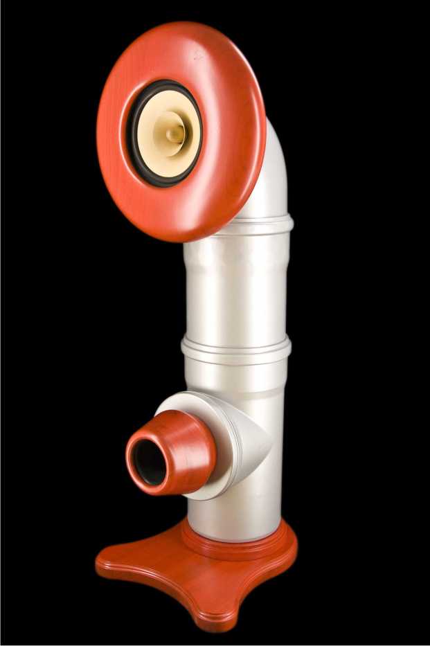

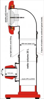

My first photo on diyaudio.com is dedicated to Zen Mod (hvala stari 😉 ), but the object on it to Istvan & Zoltan - my respect!
Maybe now... ?

now just tell us diameter of drek tubes you use , give us dims of reflex tube , and take pics of few details of wood/plastic joints .....
dims for evaluation , details as good cause to praise how clever you are ......

Re: Dimensions
ma_coule said:
Upon my great respect to Istvan & Zoltan:
great & tnx !
did you compare sound of your Super Drek Tube , to any other SWR cab ?
their Onken is certainly interesting , but I prefer any type of floorstander ..... just because I'm always lazy to make proper stands for any smaller cab ...... or - is it because I just dropped long time ago - small boxes ..... :clown:
No, I didn't... it's my first wide-ranger... :cannotbe:
Actually, it's a funny story, began with SFR 200 (not SWR!) and the idea to design "The Legend of Moonraker" (upon an old Scottish
Legend). Nothing special, just a variant of double Chang, but a lot of work. Because I was under time pressure (it was meant as wedding present) I've done a very dirty compromise. Since Zoltan's delivery is much faster than my handwork skills are, I've turned to SWR 200-8... to (My) deepest end ... So, here I am... :bawling:
I'm talking to much...

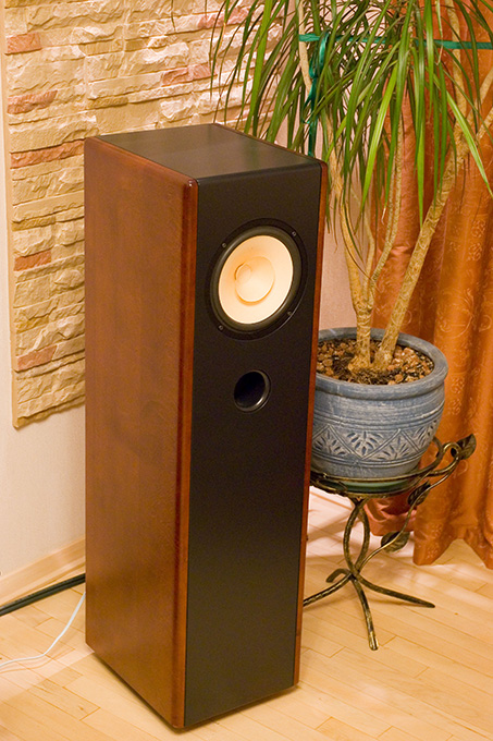

Just finished my Sonido-cab in BR-application with SWR-200alnico. It is not my own work but my design, plans from Ishtvan. Volume 51,5 L, port 6,3x4,5 (DxL). Material - birch plywood and alder massive.
46 Hz -3dB. Now it is burn-in time.
