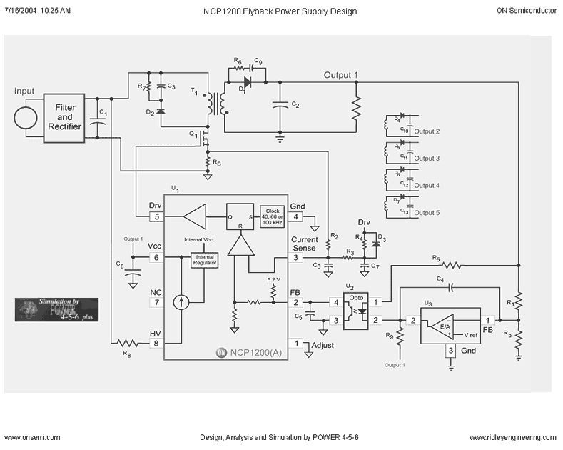

New SMPS Design Tool from On-Semi
you have to register on the On-Semi site, (and you will need Excel) but a new, powerful design tool can be found on their site -- the designs might require you to use their NCP1200A controller -- http://www.onsemi.com/site/support/models
just scroll midway down the page.
get this, the tool produces gain and phase margin -- and their is an interactive tool which does the bode plots in real time -- warning you when you have inadequate phase margin.

Yeah, this is based on a subset of Ridley Engineering Power 4-5-6. Current version is 8.5, and it's a very good design synthesis tool for a working SMPS designer. I speak from experience.
The NCP 1200, OTOH, is a part designed for low power Flyback applications; it's relevance to audio supplies is limited, unless you want to roll your own inexpensive SMPS such as what comes in DVD players and the like these days.
But trying the On Semi NCP1200 subset of the tool will give you an idea of what Power 4-5-6 does, and whether it would be worth $800 to you.
