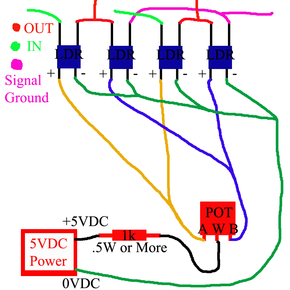

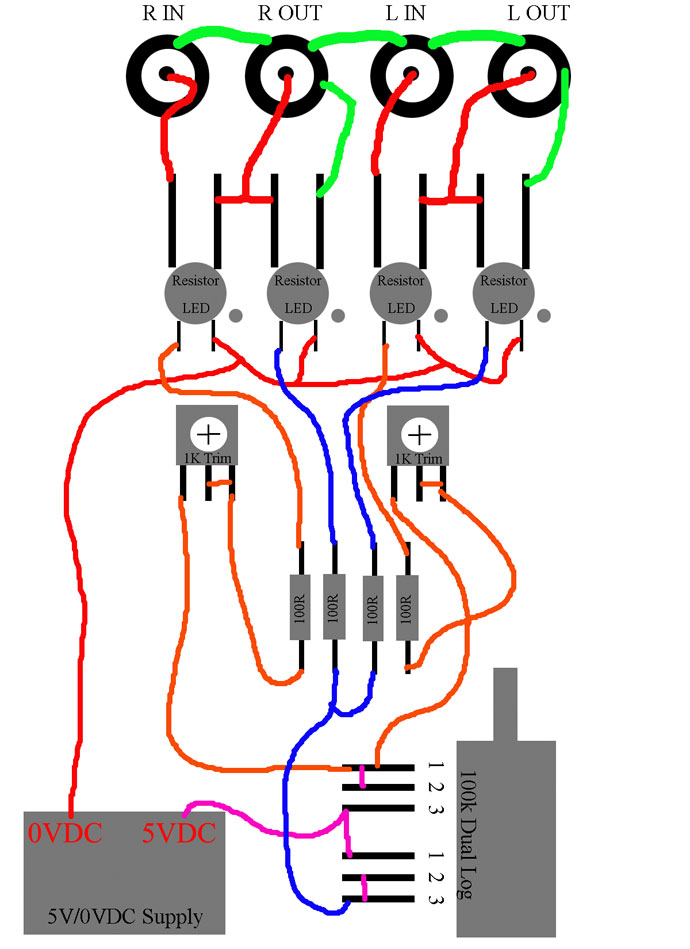

Hi BikerBoy,
So good to hear your experiences. So you know I do not have boards for balanced. You would have to make a balanced Lightspeed. I tried putting multiple LDRs in each position and at anything but low volume it works well but at the lowest volume, and I suppose the highest, the LM334 can not produce enough current to drive more than 2 LDRs. I get a wah wah wah sound with 6 LDRs per LM334. With just 2 as you have found its perfect. With 4 its not bad but I wouldnt sell it that way.
SO I have balanced sets but not for the Lighter Note. You would have to build a Lightspeed which will be incredible trust me... Now, what you could do is use Lighter Note boards for the power supply and then stick the 100k dual log pot between the Lighter Note boards and the LDRS but you would need 4 boards to handle all the LDRs. Kind of a lot of cash. I think build the Lightspeed first, then decide if you want to go further with the Lighter Note as a power supply but I think you will achieve near Nirvana with a very good power supply and a balanced Lightspeed setup.
