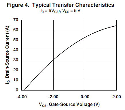

what is amazing is that the Id vs Vgs looks rather different.
If the graph is right, this thing has maximum transconductance when Id is zero.
And at zero or near zero Id, the transconductance is >20S!
And look at the linearity of the curve at zero Id!
I hope it is not an mistake in the datasheet.
The scale of the y axis is too coarse (ie 10A per division) it would be nice to see the graph reproduced with 1A per division or even 0.5A per division, over a range of 0A to 10A (instead of 0A to 70A)
They do look interesting though.

Thanh1973,
I think you made an excellent point.
Look at fig.1 - Id vs Vds at various Vgs:
Id at Vds=5V and Vgs=-2V = appox. 29A, which is close enough to Fig. 4 which tells 30A. (With this I assume Fig. 4 is at 25 degC)
And at Vds=5V and Vgs=-1V, ID= appox. 45A.
So the average transconductance for -2V < Vgs < -1V is 16V/1A = 16S.
While the average transconductance for -4V < Vgs < -2V is 29V/2A = 14.5S.
This shows that maximum transconductance should be between 29A < Id < 45A, not at zero Id as suggested by Fig. 4
My guess is that for figure 4 they take too few points and smoothed the curve too much, thus it is useless for our interest.
This is not the first time that this happened, the Id vs Vgs curve of the R100 is also pretty much useless.
But the self biasing is still interesting though.
