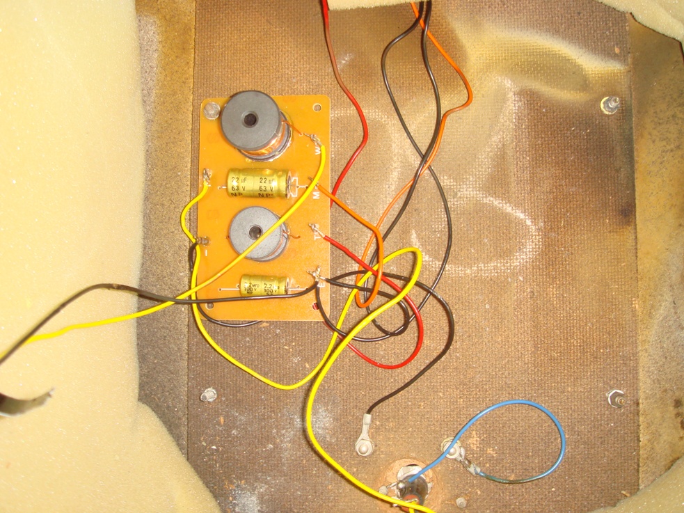

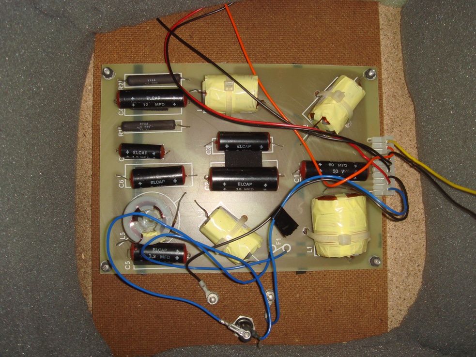

Addition to my last post the later 332s have 7 caps . Have attached a pic for interest as it does seem a bit of overkill when the old ones only have 2 !
I cant find any Xover calculator that gives 7 capacitors for a 3 way !

The crossover on the left is from god knows what but its certainly not
the original, could be a Skytronic simplest 4 element 3 way c/o possible,
in other words absolute garbage, completely wrong*, a tweeter killer.
(You can see the studs for the original board, looks the same to me.)
Crossover calculator ? spawn of the devil, see FRD tools in the links I posted.
Also read undefinitions FAQ's. Clueless c/o design is one of my pet hates.
7 capacitors in a 3 way is easy peasy if you know what you are doing.
The board on the right is the right sort of complexity for the period.
rgds, sreten.
So you've got one proper pair working with new tweeters. Tweeter level
may need tweaking for them. Use the proper c/o of course for these.
So spare is a pair of cabs ? pair working bass units ? pair repairable mids ?
..... and pair of budget c/o's.... of little real use in a hifi speaker ....
* Only worse is just having a cap on the mid and a cap on the treble.
