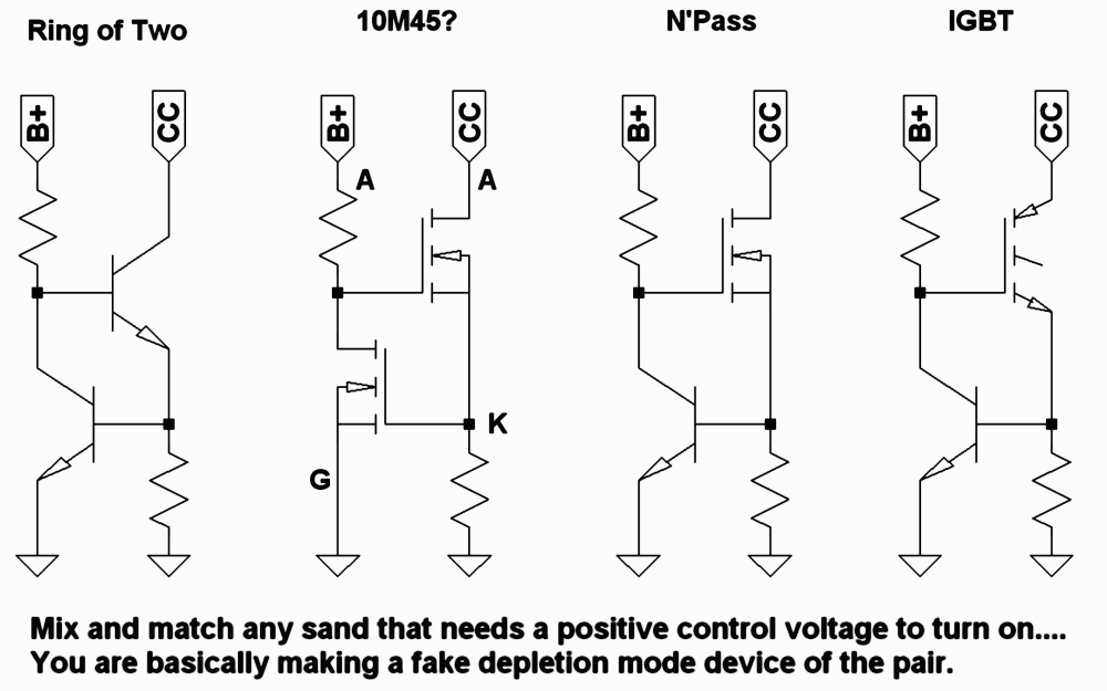

For automagic matching, you could Blumlien garter the CCS pair.
If you are planning to fine tweak both for some specific current,
I suppose the garter enhancement would be irrelevent...
Bridge the cathodes with a fine non-polar audio type cap, and
Then like Shoog said, two large polars in back to back series,
with a bleeder to keep em' formed.
Gotta remember when scaling the bridge capacitance, impedance
between cathodes is rather low... And series caps throw half out
the window. They might need to be kinda large.
10M45S internally might be nothing more than a "ring of two"
enhancement mosfets. Just as one might do with bipolars,
abusing VBE as a reference. But with much less predictable
gate thresholds, somewhere in vague neighborhood of 4.5V...
Pass' current source uses a combination of bipolar VBE threshold
as the voltage reference in the ring of two, and then MOSFET for
the current blocker. This makes better sense as VBE seems fairly
repeatable. And the MOSFET can operate the drain very close
to the voltage reference. You can get this working stable down
two Volts or less.
The top device in ring CCS might better yet be implemented as
an IGBT if one were going with discretes all the way. Of course,
you then have a voltage drop VCE to consider, I don't think you
want to be working anywhere near saturation with an IGBT.
But these are readily available to 1700V, if you need that sort
of blocking performance with a very small gate drive.

The bridging cap merely unifies the current sources into a single
tail for music signals. Yet remain as separate tails for purpose of
balancing DC.
Blumlein's garter bias was for eliminating the need to fine tweak
the DC balance...
Its a tube thing, so you should have no probs understanding or
finding older refs to it. Except in your case, applying this balancing
trick to G , K , and current sense resistor of the CSS devices.
"Ring of 2" and variants... Don't drive yourself crazy looking for
Blumlien's garter, not yet in this picture. There's a writeup about
it at Tubecad Journal.
I'll draw a ring of two (or is it four?) garter later, if you havn't
got it figured for yourself by then..

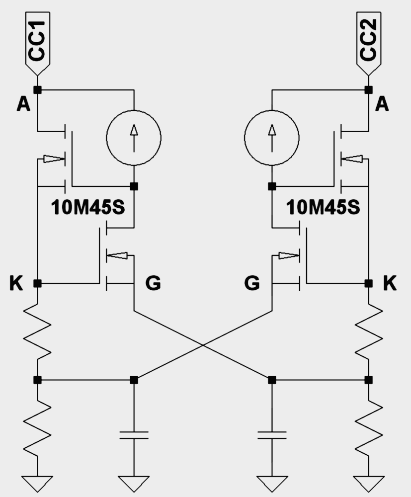

This is what I meant, about the garter matched CSS's.....
And the caps I show at the bottom aren't needed if you are
bridging a cap (or caps) across the top. Unifying the tails...
Note: that I am showing internal details of 10M45s that are
entirely my guesswork... Not based upon any known fact....
I don't have a clue how the upper gate might be pulled up,
Nor exactly how its protected from the excessive voltage.

Well, the equalization I was concerned about wasn't the resistors...
Its MOSFET gates. And if 10M45s uses VGS-On threshold of one or
more of those gates as a reference to compare the sense resistor,
then that threshold is subject to a large manufacturing variance.
The actual figure might be 3 to 5 volts. Then again, they might be
very identical, especially if cut from the same batch... Who knows?
If you measure the "K"athode voltages to be the same, then the
currents in your 1%'s are the same, and you got no such issues.
If not, then Blumlien's garter would be one alternative to manual
trimming of resistances to assure those currents always match.
