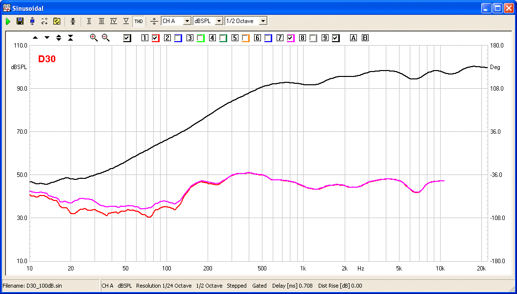

New Scan-Speak D3004/660000 Distortion Tests
THD.
Same method, 125mm etc. But instead of changing levels, we change frequency - 100dBSPL was chosen.
First 1KHz- the lower the frequency, the greater the demand on the tweeter.
D30 :
That looks like high THD - 1.325% - but it is dominated by the 2nd.
HDS:
Yes, the THD is lower, but look closely. In D30 the 2nd is greater than 3rd whereas HDS 3rd is greater than 2nd. This makes the Total Harmonic Distortion figures misleading.
Let's go onto 2KHz.
D30:
Still dominated by 2nd, but 3rd is just noticeable and higher suppressed.
HDS:
Lower 2nd but higher 3rd.
Now 4KHz.
D30:
Nicely cascading - a good sign a la Jean Hiraga.
HDS:
Pretty much a draw here.
OK, where does this get us? Note that in every set of plot HDS measures lower? Yes, THD is misleading, only by breaking the figure into individual harmonic components can we see the real picture.
The winner. Curiously that every THD favours HDS, yet as above D30 is a narrow winner.
What do you think?

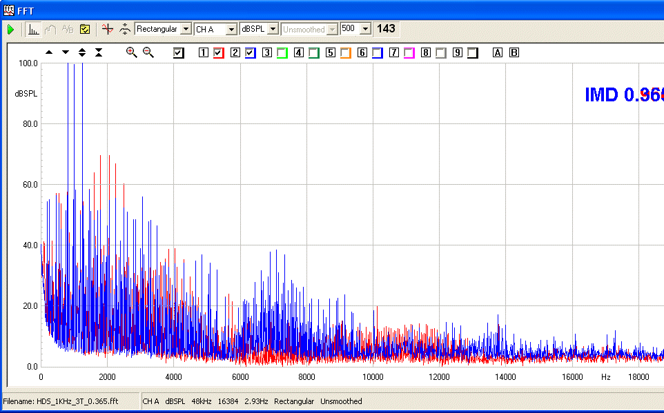

IMD Tri-Tone Tests.
This is the last 'chapter.'
The Tri-Tones will be centered around 1KHz, 2KHz and 4KHz. Two out of three adjusted to 100dBSPL @ 125mm.
1KHz
D30:
HDS:
2KHz
D30:
HDS:
4KHz
D30:
HDS:
The winner? This time you tell me. The calculated IMD figure overwhelmingly favours HDS - what do you think?
So there you have it. Spend some time analysing the graphs, maybe you noticed something I didn't? I have tried to keep running comments to a minimum, only guiding where I feel appropriate. Where I have discussed a so-called 'winner' it is only to point that summed distortion figures - and hence into a single figure - can be misleading. This alone should be discussed.
Other factors: If you are assembling a 4 Ohm speaker system and don't mind paying the extra money, then you should consider the D30. But if you are aiming at a sensitive speaker system and 8 Ohm, then HDS is for you. If cost is a consideration (Madisound lists a 3.7:1 price ratio), then the HDS is made for you!
The final thing that stands out is in relation to D30: The shelved 2nd order distortion. There seems to have been made a conscious decision to trade off greater 2nd harmonic distortion for a lower level 3rd. This alone strikes me as the single overall most important conclusion regarding its behaviour and maybe why these two samples here measure differently than earlier 2006 samples (these are definitely 2007).
Over to you guys!
Joe R.
Thanks for the tests, Joe. It's good to see this level of thoroughness.
The calculated IMD% number, like THD, is heavily weighted by 2nd order products. A good way to compare these is to just drop one on top of the other to compare the whole spectrum. We'll call that Mark K style, since he's the only guy I see doing that. Praxis has it built in, but if I want to do it in SE, I have to use an image editing program.
Your results are actually very close to both mine and Mark's, done on 2006 tweeters. The SPL of the 6600 seems to be the same, and the only real difference seems to be minor variations in the top octave.
Unfortunately, there's minor variations in the top octave for all the 6600's from 2006. I've tested 4, my own pair and another pair, and just about every one had a mildly different top octave. Peak at 20kHz (2), dip at 12kHz with a plateau above (1), and perfectly flat out to 35kHz (1). I don't put a lot of value in the top octave response, as long as it's somewhat there. The important part of the response curve starts at the low end, IMHO.
Thanks,
John
I'll take that as praise. 🙂
I have SE V13, but I don't, have not, used the data acquisition part of it (I've had various versions down to V1 - that virtually made me a beta-tester). I supposed you have pestered Bohdan about it. He only lives down the road from me, the road is called the Hume Highway. OK, it's 1000K but it's still down the road. 🙂
But is this what you are looking for:
The maroon line tracks the Total Harmonic Distortion, but is totally dominated by red, the 2nd harmonic. This proves your point.
You are saying that Praxis does this and SE not? This is ClioWin 7.03 (very latest) and is a dodle.
I don't put a lot of value in the top octave response, as long as it's somewhat there...
In these two samples, the top averages out flat in the top 10-20KHz octave off axis. This is a plus with me and an advantage over both XT25 and HDS. Yet to hear D30 but I suspect it will have some 'sparkle' and I mean that in a nice sense. But I am very familiar with the sound of HDS - it's a terrific performer. What is of concern is D30's sample variations from a manufacturing point of view and as the company I am associated with is considering using this in a design.
The important part of the response curve starts at the low end, MHO.
I didn't quite nail that in my FR plots, my baffle not large enough. But the depression is common in all three FRs and you can see past it on that basis. My baffle needs to be closer to IEC size.
Re bandwidth: The HDS is further down @ 1KHz but can be pushed hard to bring it up to matching measurement level of D30. To match this level is emphasizing 3rd a bit in some of the plots? As I have used the HDS in a system, I have used 1st order down to 1500Hz approx (from 3KHz) but engineered a response 4-5 order below that. It's about a controlled low end of the bandwidth to get lowest distortion. This may well help cancel out some of the higher 3rd, compared to D30?
John, did you ever look at a tweeter response when not flush mounted. YIKES!
Joe R.
