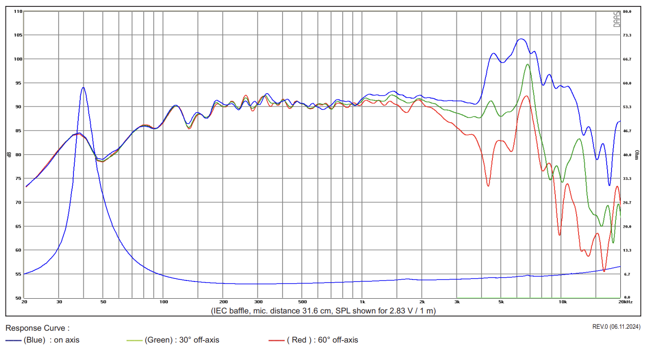

I think the optimum use of this driver is between 100 Hz - 2.5 kHz, which is 4.6 octaves.
hifijim,
Nice insight, if the frequency band is limited to above 100Hz or so, Xmax will not be a limiting factor. Force factor modulation will be reduced as the travel of the cone is reduced with increasing frequency. There will be reduced modulation distortion of the mid-band voice frequencies.
