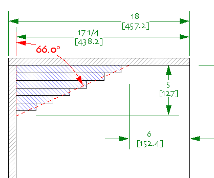

I'm persuaded by the wisdom of drawing out the plans, life sized, on one side of each speaker before cutting any of the internal pieces to size.
I'm up against a measurement problem with determining the size of the deflector bits (Def.1 to Def.6).
Estimate #1
One rough and ready idea I had was carefully measure a print out of the plans, and extrapolate what it should be in actual units.
Estimate #2
I tried to cross reference these estimates by measuring the angle of the diagonal red-broken line on the plan that traces the slope of the deflector.
I reproduced that (157.5, more or less, degree angle) line on my speaker panel, and drew in the deflector pieces -- they don't correspond to the measurements taken as described for Estimate #1, above.
Any advice here?
Does anyone have actual measurement values?
Thank you.
Brenton
66 degrees
dave
YOU just drew that in! Was that there before?
Thanks Dave, I was pretty close on that angle ( I was measuring from the speaker top, rather than the back, as you have it shown ).
