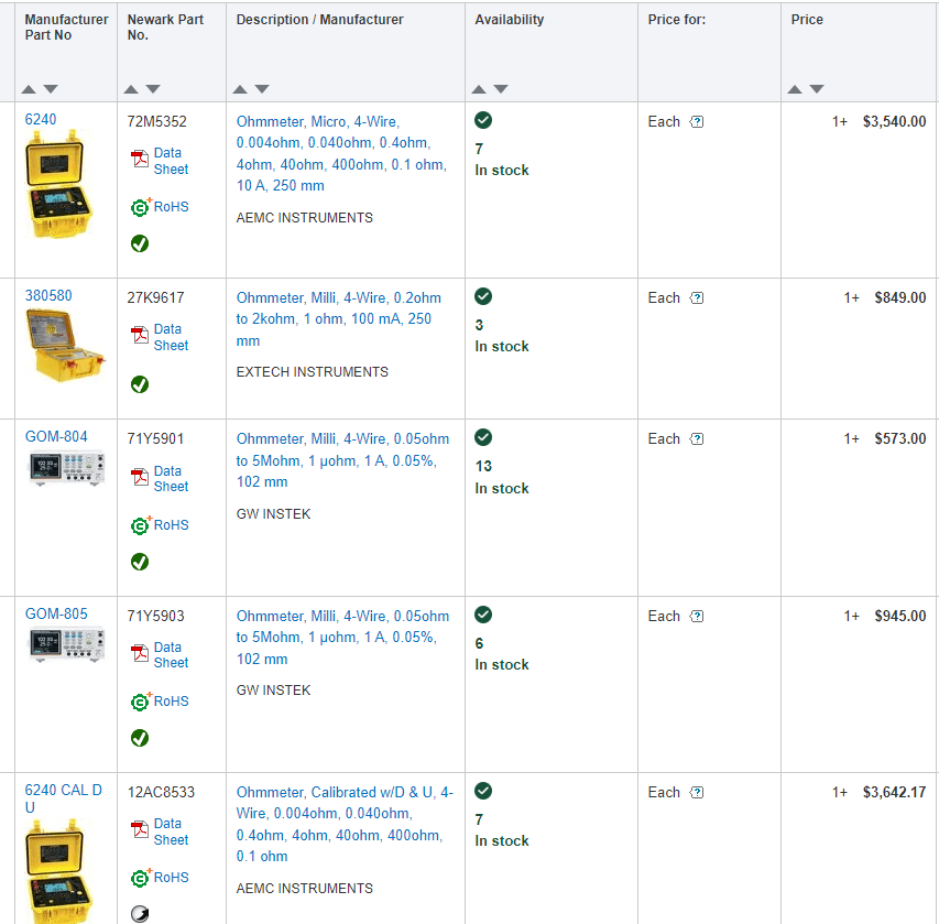

hypothetical speaking , lets say i get out of my couch potato state and want to do some lab measuring.....mmmm....
look at the costs of some 4 wire ohm measuring meters.... Ayyyyyyyyyyyyyyyy !!!
DATS all the way

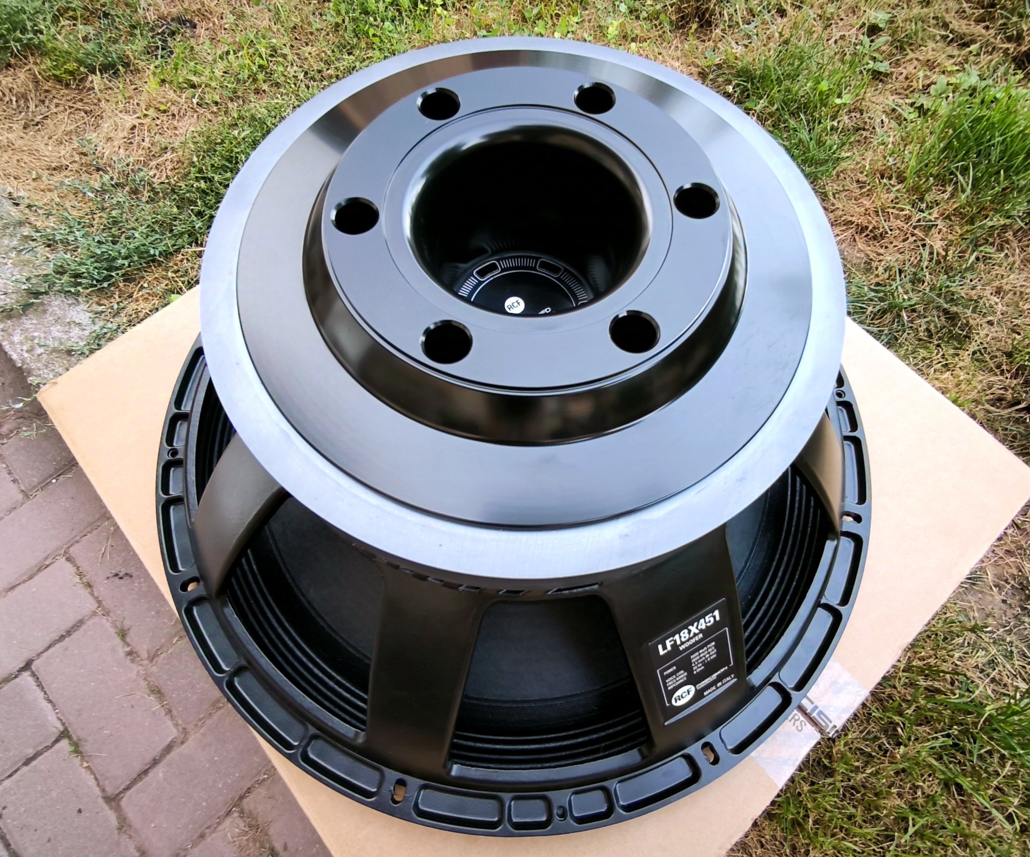

https://www.aliexpress.us/item/3256807141082564.html?Can't wait, so picked the oldschool ferrite/copper beast of LF18X451.
Afraid of originality, seller, transport etc. Already got two, and will probably buy another pair locally. But help is much appreciated.
I am building power dense "efficient" bins.
It is just for me and some gig here and there. Definitely an overkill.
I am developing what I call "port assisted closed box". The port is tuned very low, 25-28Hz, and subsonic/highpass cutoff is set above port tuning frequency. That way the speaker is able to operate in small enclosure efficiently around its impedance peak, not using the impedance valley. It is only possible with high excursion drivers for good results though.
Purchased LF18X451s instead. The same coil as on LF21X451 which is marked 2000W/4000W swayed me, as well as price and old school copper/ferrite solution. Displacement capabilities would be limiting for the port assisted design, but this thing still goes to 15mm one way with very little power, and so with double the amount of drivers, it´ll be more than fine. Still, sad that the new neos didn´t end up mine.
The hypervented cooling gets on the nasty side, but in the box, it is still well within the limits of usage needs.

Speakers do not have needs really. In modern PA, it is all question of balancing efficiency, size and usability. Once the motor is strong enough, it is happy to work in smaller enclosures. And this one certainly is. It will work well in 2.5-3 cu.ft
