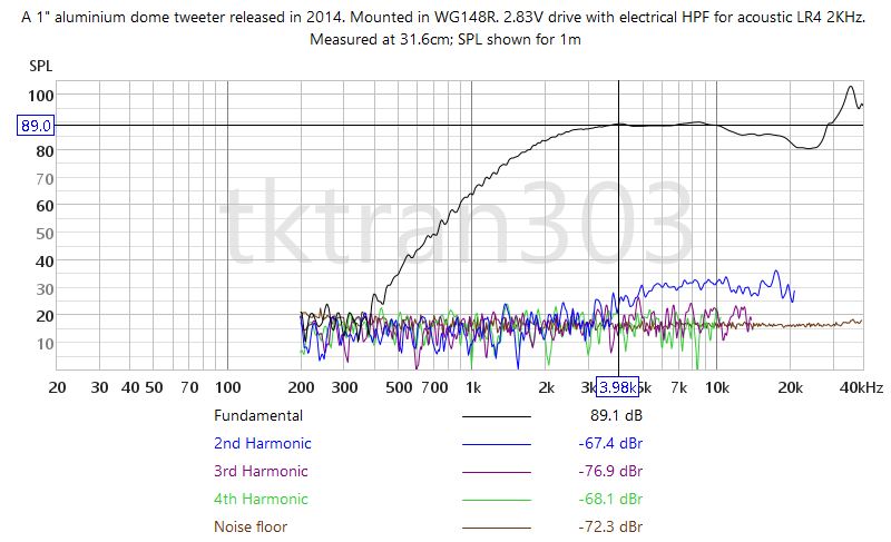

I have another. This is an in-box measurement, absolute calibrated (accurate to +/- 0.4dB) however -10dB has been subtracted to show the 1 metre equivalent SPL reading value. The fundamental has 1/24 octave smoothing (fixed) and the harmonics are based on a log chirp aka exponential sine sweep:
The legend marks the cursor position.

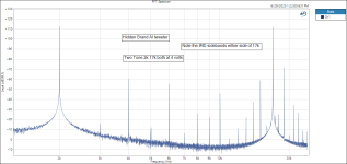

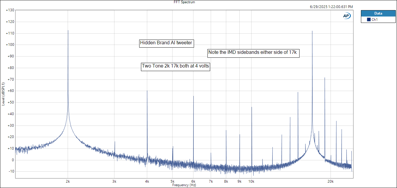

So here is a Two Tone FFT plot at 4 volts rms input at both frequencies. So the only thing that could be left, is some additional very minor harmonics?
Note the IM Distortion sidebands on either side of the 17k test tone.
