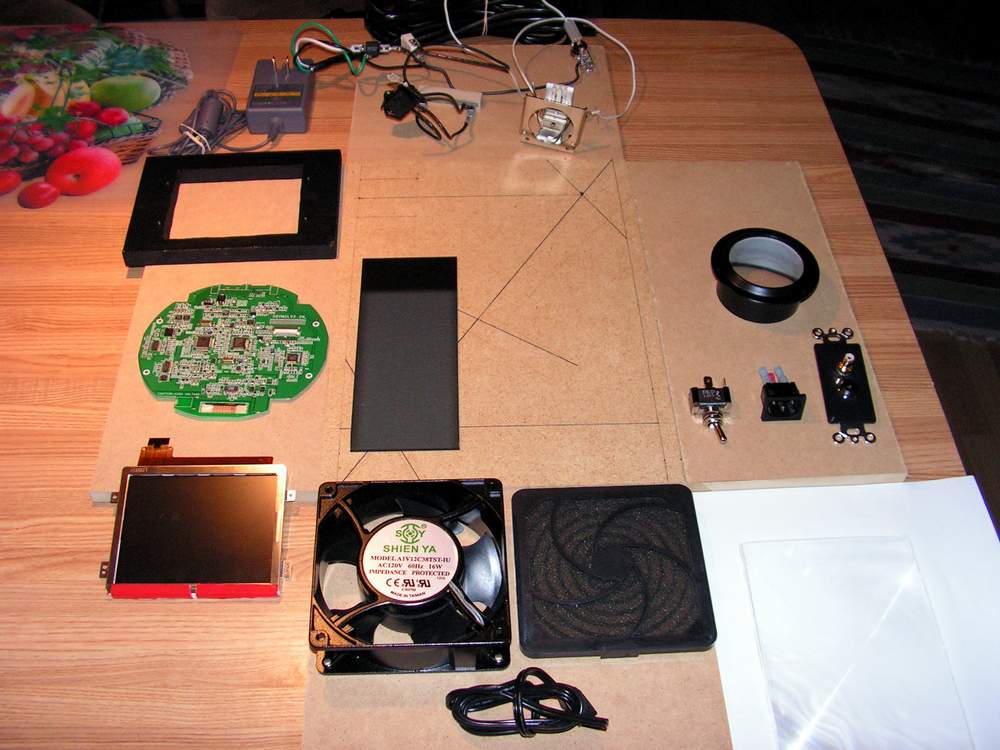

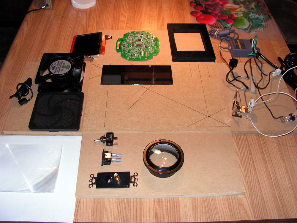

Just getting started on my second PSone Projector. If you start to get tired of seeing them let me know. I promise not to get upset.:bawling:
Anyhow, this is an exploded view of my project. I'm getting started tonight. Thanks for all your support.

Dissident75, your good! Yeah that's the one and it's great, You know the colors are wonderful. Surplus Shed it awesome. Those people really know how to care for their customers. I bought three of these lenses from them and they're flawless. Also, check out their fs mirrors for this project. As far as a mounting system, my holes are cut really close - so they stay put pretty well. I move the lcd screen back and forth for the desired range of focus. I only move the Projection lense for fine focus.

I must say I"m impressed with the work. On the inside angles, they look more acute than the standard 90 degree, how'd you work that out? Trial and error or did you actually have some calculations you used?
I am diffinately a trial and error kind of guy. All my angles are done with rulers and an exactly square small piece of paper. The light is Halogen 360w 82v from OHP. Not as cheap as Metal Halide (long run).
The bulbs are anywhere from $5 to $20 for 75hrs. Your paying roughly $.30 an hr.
Price List Break Down: Rough
MDF board - Home Depot- 5/8" and 1/2" = $15 (have them make as many cuts as possible for you - don't let them say no)
Fuji Copy lens - Suplus Shed - Item No: L3334 = $7.50
Front Surface Mirror - Surplus Shed - 7-5/8" x 3" - Item No: L2094 = 2 for $5
Lighting System - OHP - Pawn Shop/fleamarket - Light and fresnel = $20 to $50
Filtered Fan Guards - Surplus Shed - Item No: M2259 = $.50 to $5
AC Fan - Altex/Surplus Shed/Radio Shack = $15 to $25
Plain Mirror - Walmart - Automotive - $2.50
Misc Hardware - screws/L-brackets/wood glue/flat black paint - Home Depot = $15
Misc Electronics - Power Connects and such - Radio Shack/Surplus Shed = $15
Psone Screen - Ebay/Pawn Shop/GameStop = $40 to $60
My total cost was about $160
