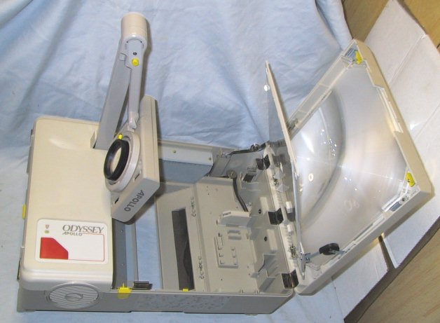

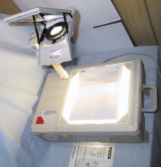

Hello,
I have Appolo Odysssy portable overhead projector for selling and used for DIY projector. It is damm good lenses to project sharp image. However i have got another projector so selling this projector in almost half price in India. Please note the bulb got fused and it runs in USA voltage.
Please contact me in creator.abhishek@gmail.com. Selling price is only 9 k + Shipping.
