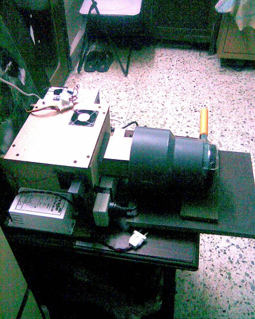

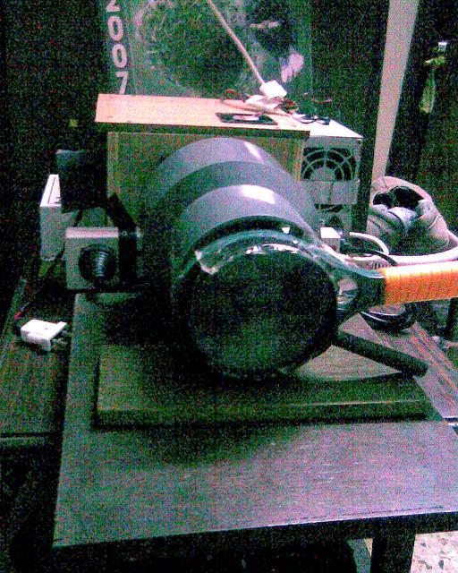

Hi my projector maximum dimensions are the follwing
28cm width x 20 cm height x75 cm depth. the ballast for the bulb is kept out side.
I use a 10 inch LCD.
Gitesh

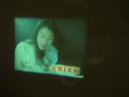

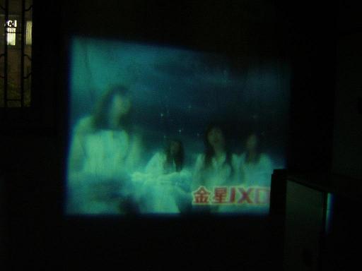

hi umeshkumar
hi,
what you are saying about screendoor effect is right but only when i am at less than 5 feet from the screen. if i sit farther, somehow it does not disturb me , probably because i am not a videophile( i hope this word exists).i have tried with trailers only, yet to watch a fuul length movie.
anyway, here ar pictures of my attempt
hi,
jaudere
Well my friend you yourself have admitted of the poor image quality.My take on making a PJ is that it should be SPECTACULAR projection wise or else what is the fun of making it if it produces a mediocre quality image.It is already big or so to say it has very bad form factor and if it projects like wise than that would be like a pimple grown upon the ulcer😀 .A reasonable PJ would cost over 10000-12000 Rs atleast.One could either go for a readymade chinese ones for that matter.BENQ PJs range starts from 30000 Rs.However veterans in this feild donot subscribe to buying evn the low range commercial PJs.
So the best thing would be to get hold of a small LCD with atleast XGA resolution which is smaller than 15".The smaller the better.
